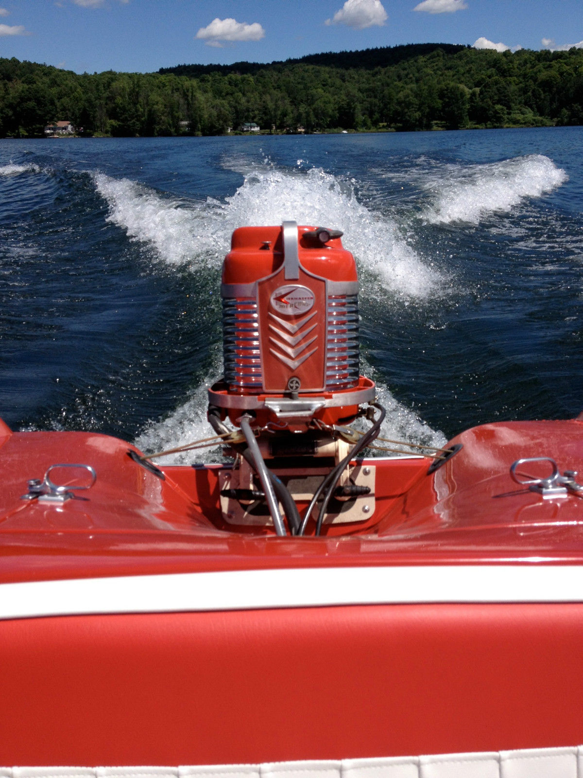

I presume that isn't yours with the two rear hatch latches. If, indeed, yours doesn't have a rear hatch and won't need them, please feel free to send me any such latches that you come across. That pic is the best pick of those latches I've seen, and I've been looking.

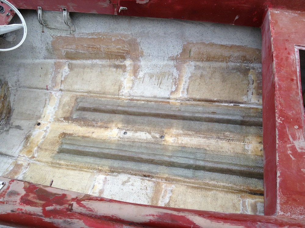

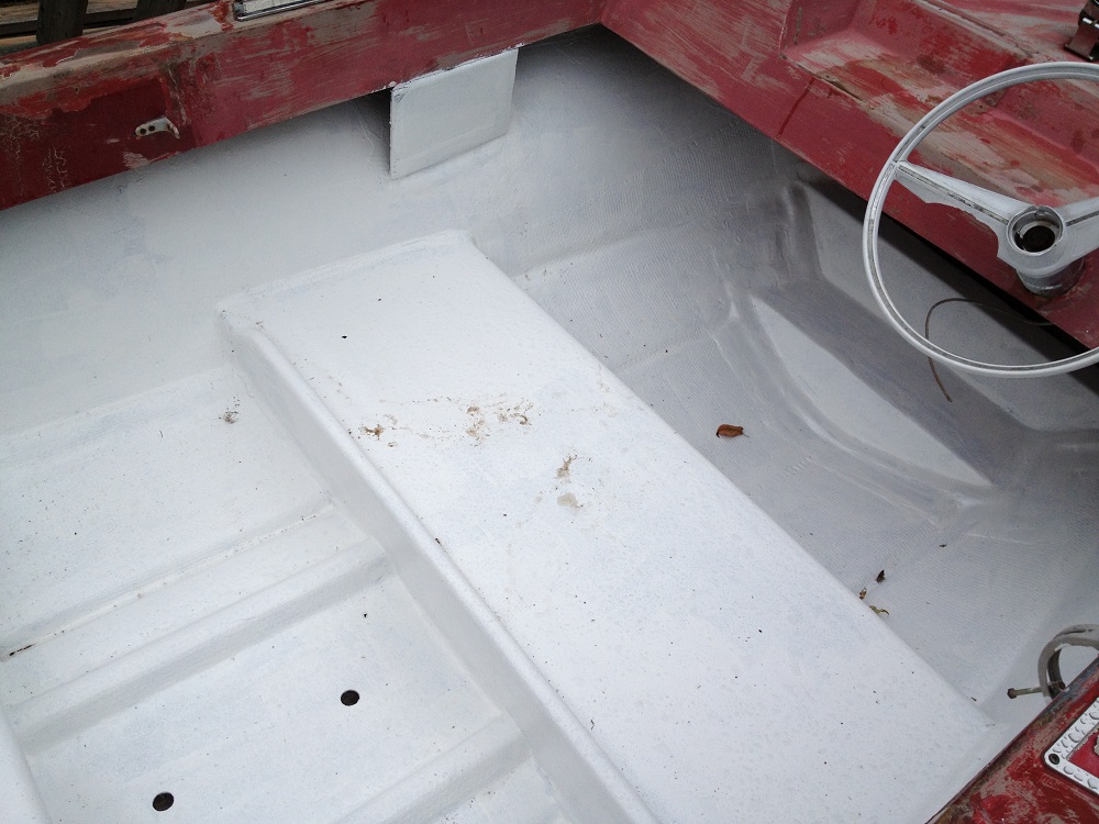

I replaced my transom from the outside, without splitting the top from the bottom. I also found that the bottom had developed a hook in it. I cut the seat bases out of the hull with a zip wheel on a right-angle grinder and tossed the waterlogged foam chunks. I then ground out what Cutter had put in for some short longitudinal stringers. After jacking the bottom of the boat flat, I then made some 8' long wood stringers and glassed them in with several layers of heavy roving and vinyl-ester resin. Re-glassed in the seat bases and made them airtight tanks. Will post some pics tonight. Transom still needs gelcoat and finishing (this spring). Then it'll get the Fat Fifty or the Merc 800...
Larry
Halfway done. Two layers of MDO plywood, lots o' vinylester resin with thickener.
Stringer addition
Seat bases back in,rolled on some white gelcoat.

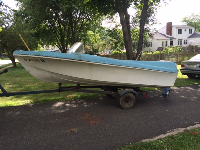

I have a cutter jet, barn find, rough shape but all there, including hardware, what is range of prices I shoul put on it?

We have got to see inside pics and hardware first before a price is tossed out there.

Looking at the rear hatch hardware for your red cutter. Is that hardware stock?
