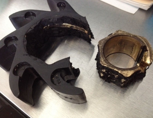

I have been on the hunt for a replacement water impeller for my 62 75hp flying scott motor. The mechanic that had it jammed it on the shaft with an incorrect key and ended up cutting into it to get it off. Bad part is that I can't find a replacement for it anywhere. Sierra made one that was part #18-3025 but is long since out of production. The dimensions are .705 height 2.90 diameter and a 3/4" bore with a singe .141 key. Please help me find something that will work - Tyson.

This gentleman has all the Scott impeller molds and will mold a new impeller on your bushing. $35 exchange.

Re:75hp Scott Impeller 12 years 2 months ago #98144
I looked into his but he requires a bushing for exchange, and mine is destroyed. Does anyone know where I can get one with a hub attached? Heck, even one with and rubber all work.

I have a number of used impellers and I can spare one that has one broken tip. The bushing is good and you should be able to get it remolded with new rubber.
Email me through the site and we can talk more about it.
Don

I have had an eBay alert set up since for an impeller with no luck. Last night I email Bob again and now he said he can remold the rubber for me, but back then he told me the mold was unavailable.
I do appreciate you volunteering that bushing up for me. I will post pics when I get it back and put it in.

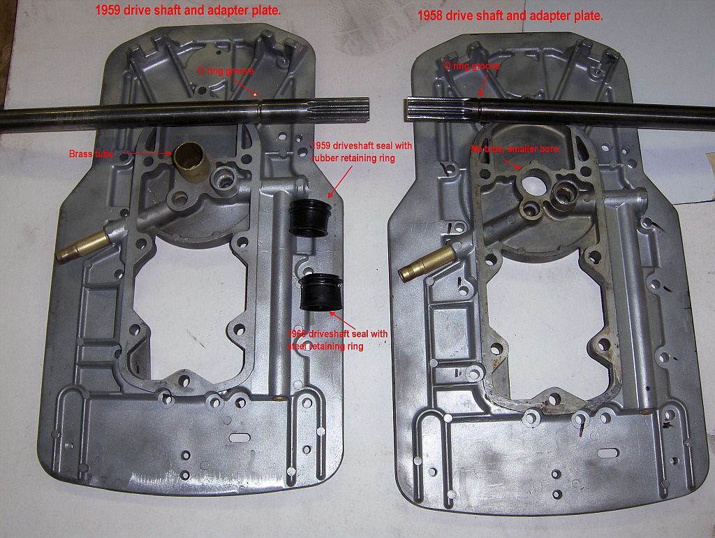

Hi Don, I received the impeller today, thanks a lot. I will send it out to get repaired soon. I just noticed that you had 2 photos in your email. It seems like you have quite the teardown and rebuild cut out for your self. One more question though, do you know what/where I can get a replacement for the upper driveshaft seal? The one with the snap ring that holds it on...

Well that explains that. I don't believe I ever received your last email. I now remember sending you the one about you having to buying me a beer if I ever got to San Diego, but if I got the other email I would have replied on the driveshaft seal, which, by the way are scarce as hen's teeth. Could have got hung up in my spam filter.
The Scott part numbers are 3321959 for the boot and 73200 for the ring. You should be able to salvage the ring. The boots are almost always hardened from heat and broken apart. I have always been able to salvage enough to get my motors back together, but right now I am down to one spare. I would try Discount Marine or Liangs. They might have one.
Pony Boy may also have extras.
The 1958 60 HP didn't use the boot seal. It just had an O ring and it fit inside the bore in the adapter plate. That made the plate and driveshaft for the 58 a one off, and it got me to thinking why the boot is even in there. It just protects the bottom of the powerhead and there is a bottom seal on the crankshaft. I'm not absolutely convinced that it has to be in the motor, especially on a low usage
motor. If there is enough left of the old one so the ring will hold it in position on the driveshaft it will be good enough.

I put an o-ring on the shaft, at least until the day comes where I come across a seal. I think it will be okay. Thanks for the info.
