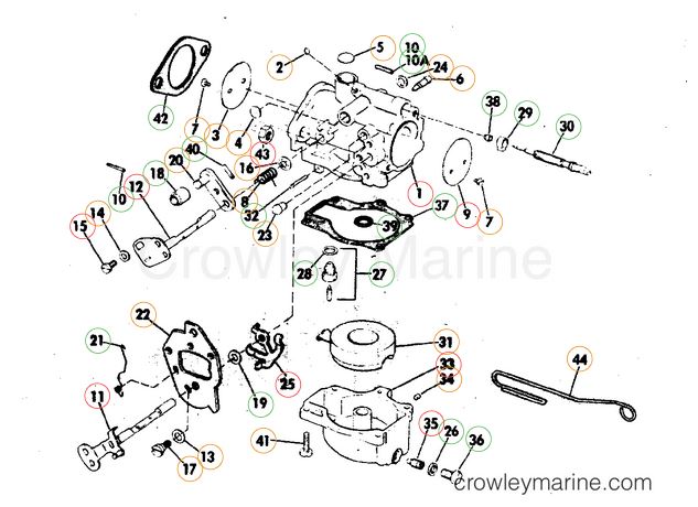

Check the carb main jet, it could be partially plugged. You can pull the float bowl plug at the front bottom of the float bowl, and the jet is within. Don't lose the gasket! If the jet looks all shiny and new, it's likely ok. If you pull the carb and then remove the screws holding the float bowl to the body of the carb, you can get a better look inside. Merely flushing a carb doesn't ensure it's clean and the jets clear.
If you see Green Stuff or any kind of debris in the main jet, you'll have to pull the carb and clean things out. Use caution if removing the main jet, it's easily stripped using the wrong kind of screwdriver. You don't have to pull the jet to clean, just use a wire and carb cleaner to get the debris out of there.
Another thing to check is your "mag" plate, which rotates to advance spark timing as you increase throttle. Check that the plate is moving with throttle and at full throttle it goes fully into the rubber "timing stop". If the plate isn't moving, you won't get full power even if the carb opens up all the way.
Edit: forgot to post the carb diagram. #35 is the main jet, #26 and #26 are the gasket and plug, respectively.

OOOPS typo! Should have been "#26 and #36, ............ respectively"
