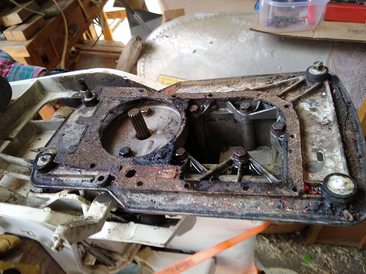

I am trying to remove the powerhead (engine) following the procedure in the 1960 repair manual- which states "remove the allen head screws which secure the powerhead to the adapter assembly. Be sure the screws partially hidden by the motor support and shift handle are removed"
I have read that there are 13 of these screws. i cannot find all of them... any tips or tricks on how to remove this engine?
Scott outboard question 5 years 8 months ago #144177
The hardest bolts are by the rubber mounts attaching the drive unit to the transom bracket. It requires a short stubby 90 degree allen
wrench to remove the two bolts. The others should be fairly easy.
Scott outboard question 5 years 7 months ago #144180
Yes- thank you. I was able to remove all 13 screws and lift off the powerhead. I was able to find a replacement exhaust/base gasket from Laing's outboards. I am going to try to clean up the powerhead and repaint and check all the seals on the lower unit... along with replacing the rubber bushings/mounts for the engine...
Does anyone know where to find replacement engine mounts? i thought i read somewhere that older merc ones might work...
Scott outboard question 5 years 6 months ago #144592
So the motor has been confirmed as a 1960 Scott 40hp. The 'new' flywheel and starter motor are installed and working. I hope to get things back together for a final test but so far the conversion is going well.
