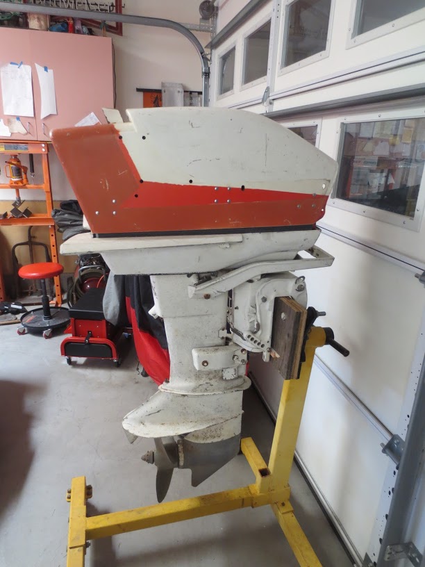

Started to restore my 1960 Flying Scott 60 (top photo). After finding rat/mouse nests in the water systems, I am tearing everything down for further inspection, media blasting and painting.

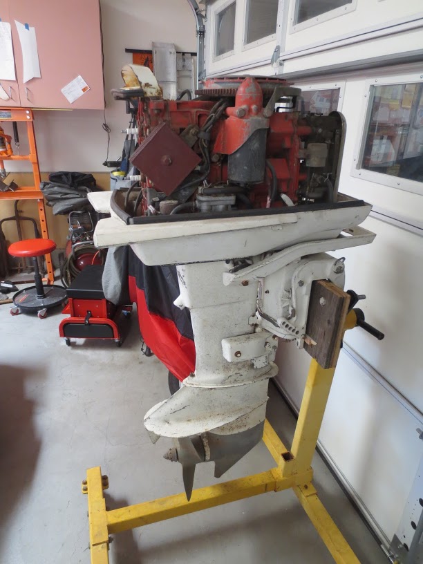

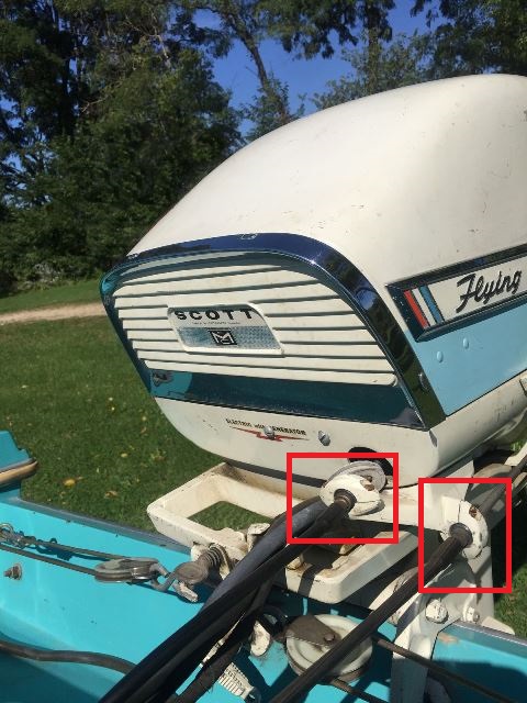

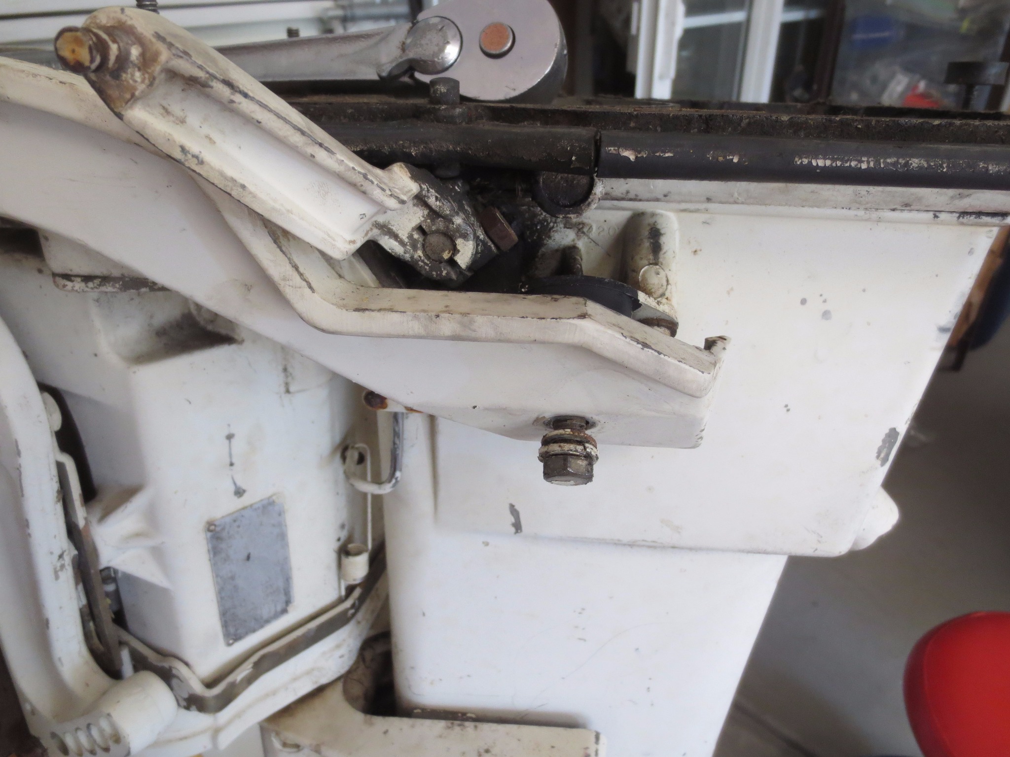

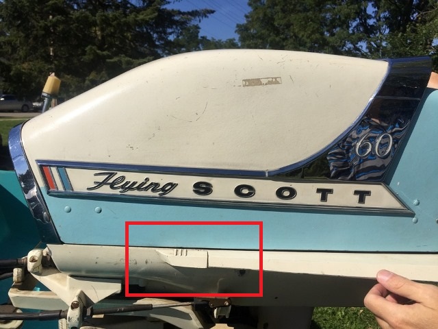

I am in need of the two Lever-Hood Latches (3rd photo), Left 236-1722 and Right 136-1722, as both are broken off and missing. Also missing are the two caps C3JB-4697 for the control cables (2nd photo).

Scott-Atwater changed the control cable ball on the 1960 models from a "small" ball to "large" ball. The pic you show of the blue and white motor is a 1960 or newer with the larger ball, but the pic of the motor with the red and white hood may be a 59 as the hood is a 59. A lot of hoods are changed around, but I would like to see the other side or the serial plate to determine the exact year. If the serial plate is on the forward face of the transom clamp it's a 59. If the plate is on the back of the clamp and faces the rear it's a 1960 or newer. Most likely it's a 1960 with a 59 hood.
I might have a set of large clamps. They are difficult to find because they are removed when the motor is pulled off the boat and then get lost.
The hood handles are the same for all years. I have spare hoods with handles that I could sell, but no spare handles.

Don, thank you for your reply. My serial number plate is on the rear. # 3662. My motor is painted red. The photo of the cover has already been stripped for restoration of the chrome parts. My cover latch handles are attached to the lower housing, not the cover hood.

Yup, definitely a 60. And you're right about the handles. I should have known, I've had to change enough broken ones.

I do have an extra set of latches, but no control ball clamps. I will PM you the info on the latches.
