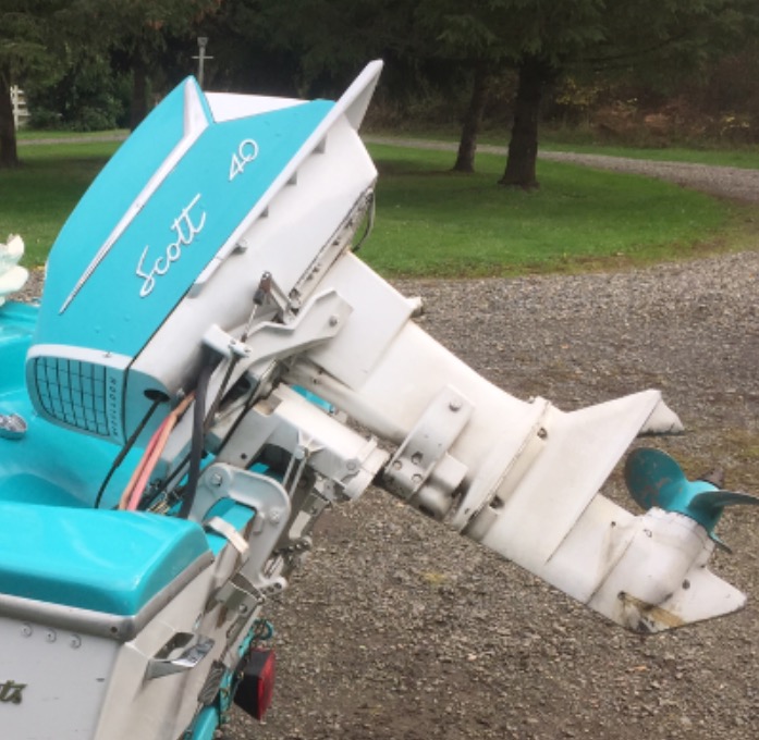

Well, I'm official. I pulled the trigger on a 1962 Esquire that I spotted on Craigslist. Anyway, it appears to be in really good shape and I'm just trying to learn anything I can about the boat and motor. The motor's SN appears to be 336A6881 - but I'm only certain of the A and 6881. Can anyone help me identify it? Is it a 1962 as well? Also it may need a new starter and the one in there is a Delco Remy. Is that original? I took quite a few pictures but I'm not sure how many I can post. Thanks for all your help!
Re:Trying to find year/model of a Scott-McCulloch 40 9 years 11 months ago #128636
superboll,
Congratulations on getting the "new" boat. Looks great.
The prefix on your motor serial number is 336A. Scott service bulletin 387 indicates that it is a 1959 two cylinder, 40 HP, short shaft, with electric start.

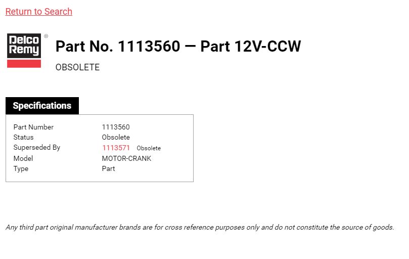

So after many phone calls to various places, Discount Marine sent a starter with a different serial number. When I called, we discussed the exact serial number of 1113560 but I received 1113571. I wanted to verify that I need to send it back. Don originally said there were four used in 1959. Are these equivalent? Thanks fellas.
Re:Trying to find year/model of a Scott-McCulloch 40 9 years 10 months ago #129126
Josh,
The 1113560 was used on the 1959 40 HP with flywheel 436-100. Eventually the 1113571 was a replacement for 1113560 starter.
Eventually AC Delco obsoleted both the 1113560 and 1113571 with no recommended replacement number.
Your 1113571 is a NOS starter that will work in your motor.
In a previous post I tried to set up a chart with the four starters, but for some reason when it posted the chart was compressed into a bit of a confusing mess. I'll try it a little differently in case someone else has the same problem.
Starter 1113567 was used with flywheel 1436-100. Replaced by starter 1113555
Starter 1113568 was used with flywheel 436-100. Replaced by starter 1113560.
Starter 1113560 was replaced by 1113571. Delco eventually obsoleted that number.
You have an NOS 1113571 that is correct for your 1959 40 HP Scott.

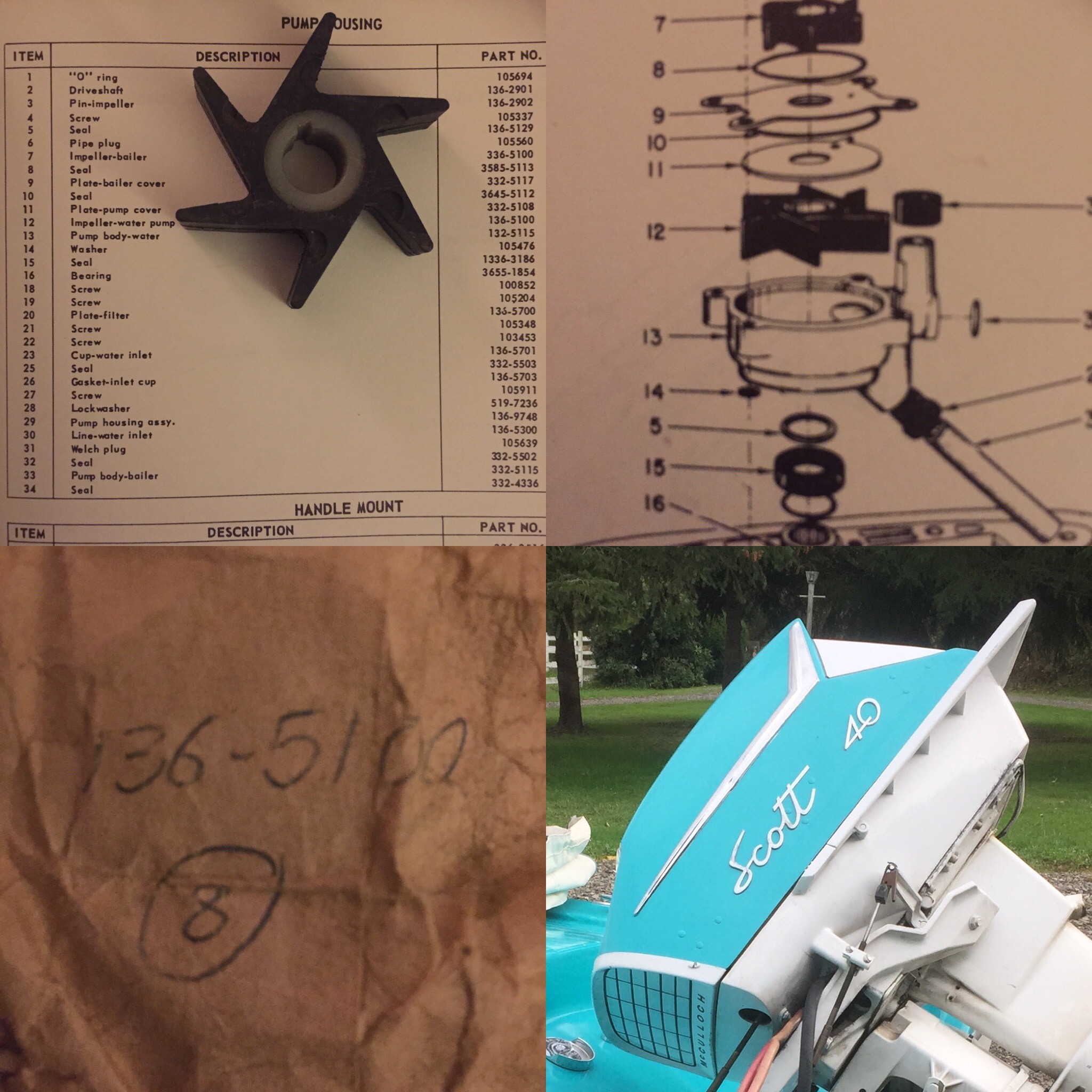

Just wanted to give a little update. I have the starter, seal kit and original spark plugs. Next on my shopping list is the impeller. I e-mailed the "flyingscott" guy when I found him over a month ago and he told me he had them for $38 shipped. Now, for some reason he won't respond to my e-mails. I was wondering if anyone possibly has the means to a catalog or something that has the part number for a 1959 40 hp Scott? I know it's a long shot. There's an ebay listing that has one but they are unsure of the year and only show the part number.
Thanks! Hope everyone had a good holidays.
Re:Trying to find year/model of a Scott-McCulloch 40 9 years 9 months ago #129551
The Scott part number for the 59 40 HP pump impeller is 136-5100. That was the original number. The part number could have changed over the years.

Caught a real lucky break and saw a similar impeller on eBay and said -- if you ever see a part number 136-5100, please let me know.
Five minutes later he replied: I have one. Not only did he have one, I told him to make sure to check and he found another. Parts are coming together, now will need to find a knowledgeable mechanic.
