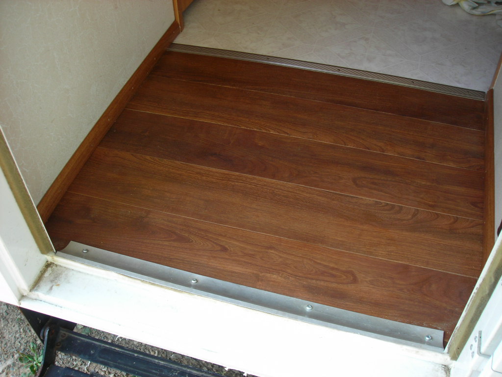

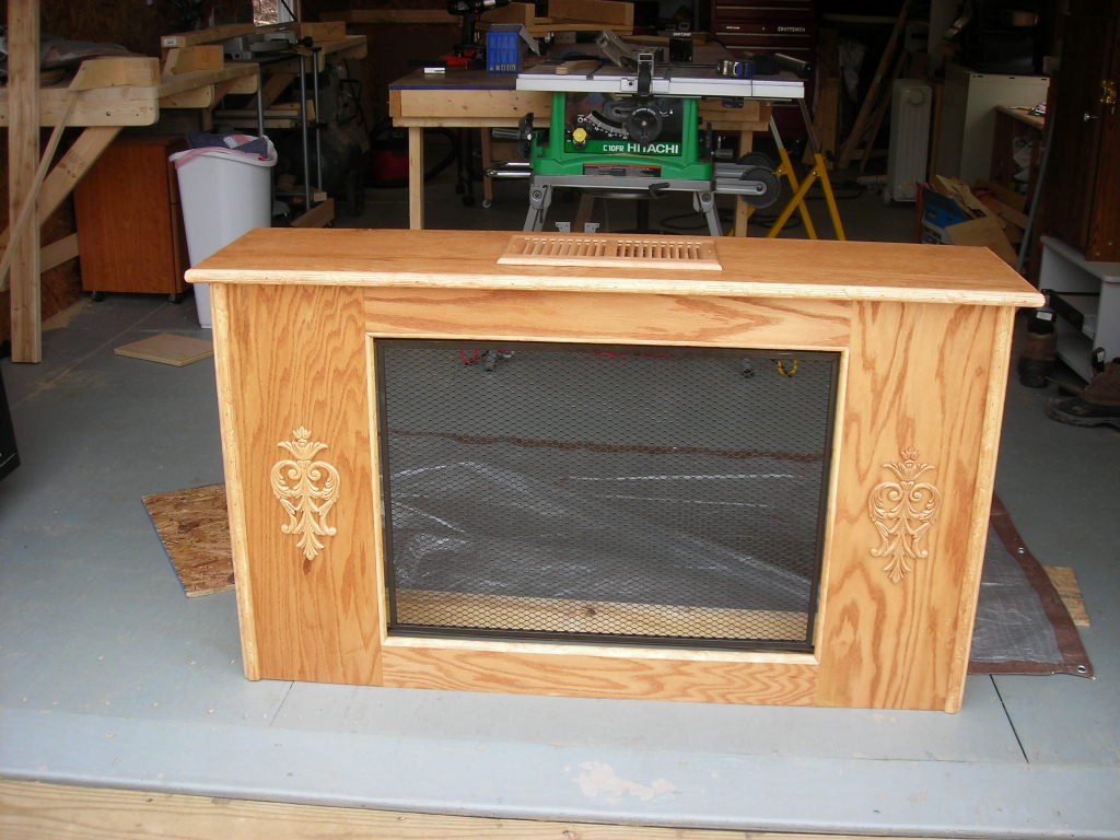

well i got the camper floor replaced all thats left is put the water heater back in,it all could have been avoided if they would have just used teflon tape when they put it together on the fittings,also heres the radiator cover i made for moms old cast iron radiator in her house.

its amazing how fast you do this stuff john.

thanks ron i have about 4 hours in the radiator cover,and im going on day 3 for the camper redo,i had to cut out all the rotted wood and repace it,then sister floor joists together with glue and screws,then insulate and top it off with plywood,then put down the flooring and put the door back on,next is the hot water tank then build the box around it,i hope im done today,ive had alot of help from lorraine .

woooo hooo im finished ,and the hot water tank is back in,but the box they built around it was nailed together and you couldnt get at the tank ,unless you tore it apart so i did,but when i rebuilt it i put hindges on the top so i can get at when i need to.now back to the boat,unless theres more "honey do" on my list,lol.

thank you matt,it was a real mess,i could scoop out some of the original osb with my hands,so it all had to be rebuilt,but its better then new now,i used plywood and put teflon tape on all the fittings.
