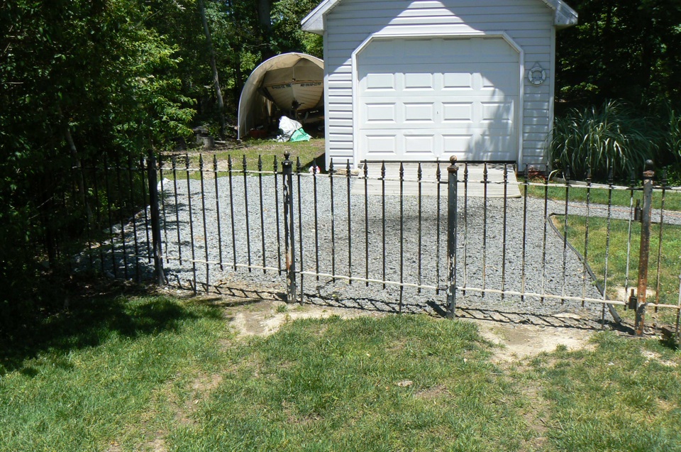

The before, well close I had welded a set of hinges on before I remembered to take a before pic.

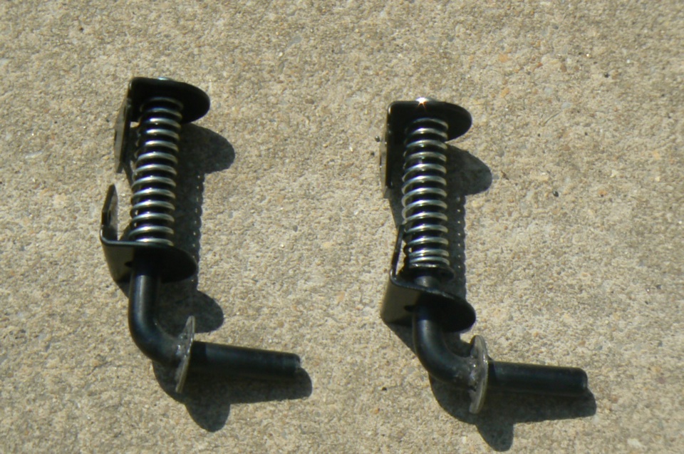

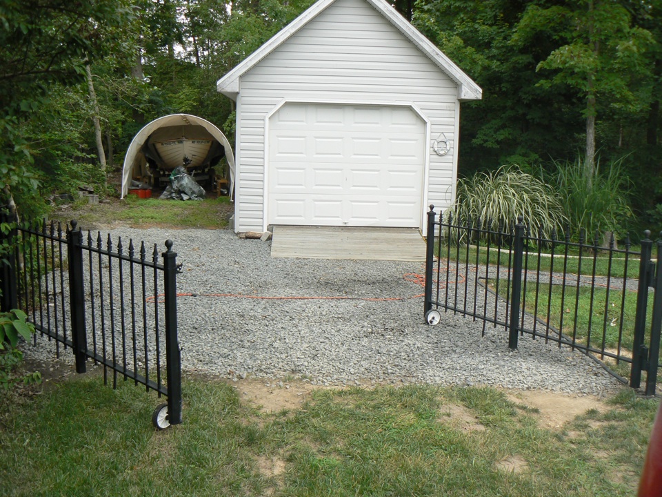

The gate is two sections for each side and was going to be a little heavy so I got 900lb rated barrel hinges and made some shock absorbing wheels to give the ends some support.

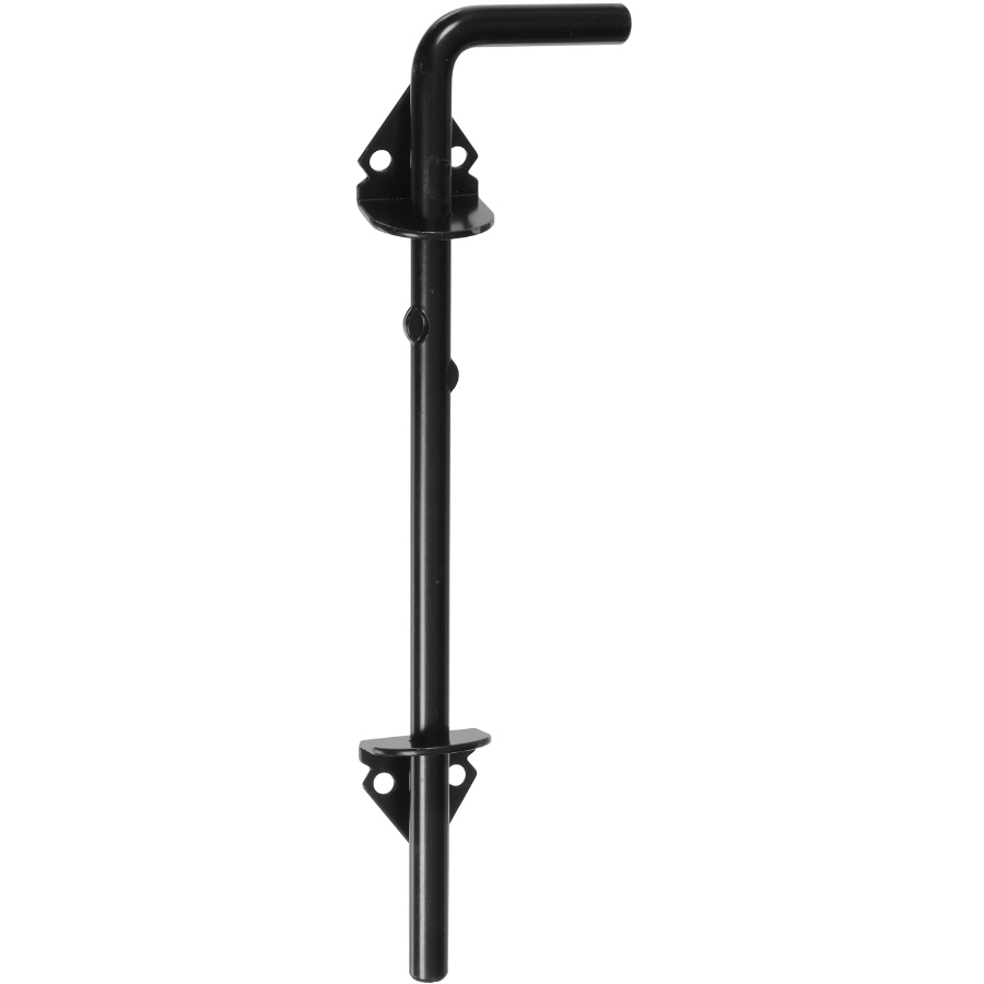

They started out as gate drop bolts like these.
And ended up like this.

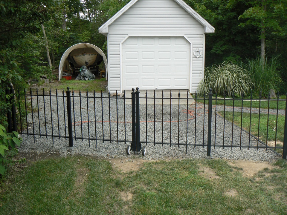

And Wa La, gates complete and functional.
I still need to weld the short extensions on the rungs but that can wait until it gets colder out. It's function as it is and the dog can't get out so......
