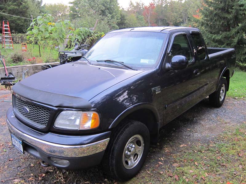

Picked up a 2001 F-150 XLT 4wd Super Cab 4.6L Triton V8 yesterday with only 94,000 miles on it. Never had a hitch on it, which is gonna change soon. Very clean, 2 owner truck, pretty much spotless. Got some other plans for it, but 1st need to do a few things with my '09 GMC Canyon and sell that!

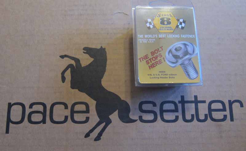

In a buddy's shop this week for exhaust manifold removal (right side has a slight leak) and ceramic shorty headers and special locking fasteners installed. Headers and fasteners have not come yet, but should be here tomorrow, so I brought the truck up Saturday so he could have it and play around with getting the old stuff off. Should have it back by the end of the week, and put the Canyon up for sale.

Headers and locking bolt kit came yesterday and are at the garage as of about 5 last night. They hope to start on it later today, but probably won't get it done till tomorrow.

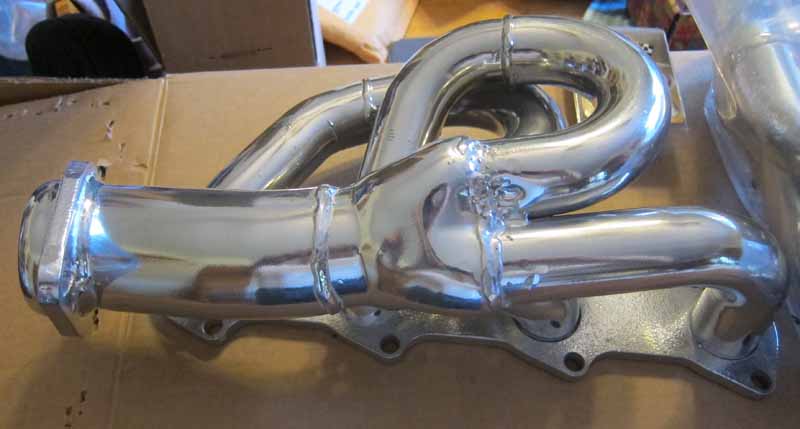

That ought to make you a nice hauler Frank. Is that ceramic coating on the headers?
Re:New toy hauler 13 years 1 month ago #84517
It beats the heck out of my 4 cylinder Canyon Mark. It's older, but really in near mint condition.
Anybody putting headers on nowadays should go ceramic. They not only last a LOT longer, your engine runs cooler with them. The one shown is the right side header. That's the side the stock exhaust manifold is leaking.
Should be ready tomorrow, but with any luck, maybe today. I have a lot more planned for it (including a hitch).

Those are great header bolts, have used them a lot. skip.
Re:New toy hauler 13 years 1 month ago #84556
The headers came with bolts Skip, but not lockers. I've used them before too, and they're pretty much foolproof.

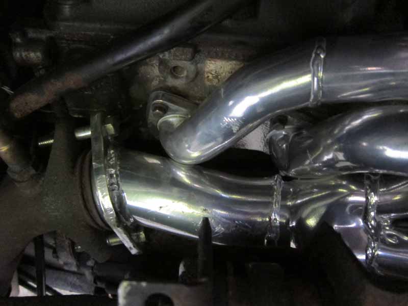

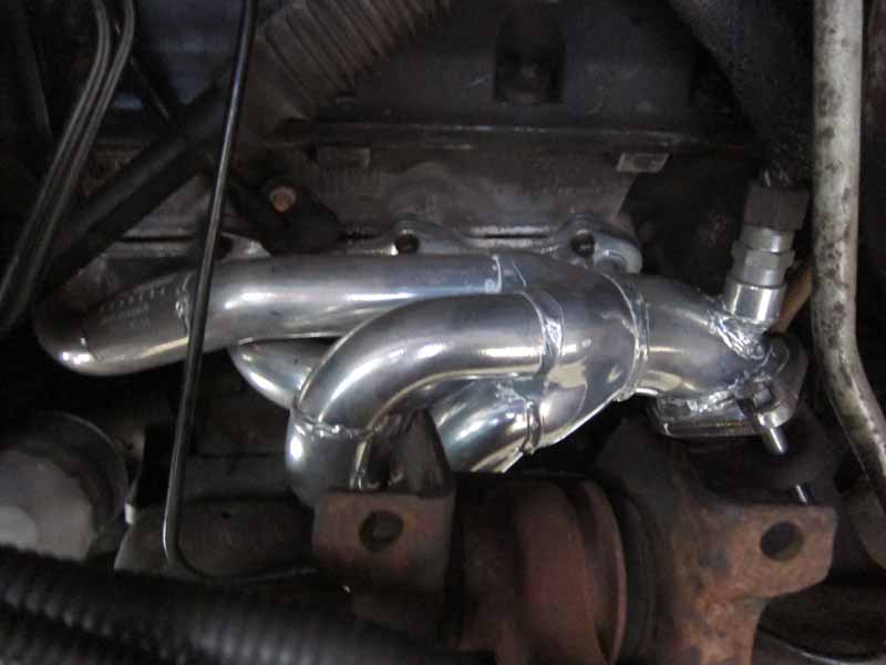

Headers on! My guy doing it liked the bolts that came with the headers, put them in with sealant. I am keeping the lockers anyways and will replace the bolts if need be. I used all new ss hardware in putting the inner fenders on, so they will be very easy to remove next time!

Should have used the locking bolts. Cast iron headers and steel headers expand at different rates as they get hotter, therefor more movement. Those coated headers are really different when they get hot. Keep an eye on them. A cat back system on that truck will really make them headers perform. Skip.
Re:New toy hauler 13 years 1 month ago #84837
I agree Skip, but my buddy Steve is an experienced mechanic, and said the bolts supplied with the headers were just fine. I hate to second guess the manufacturer of the headers as to what fasteners they provide for these, but have kept the locking fasteners, and Steve has said if i ever have a problem (tick, tick, tick) bring it in, he would swap the lockers in. He really doesn't think I need them, but I am keeping them anyways. I don't want to do the swap, my shoulders and hands are pretty much trashed as it is.
