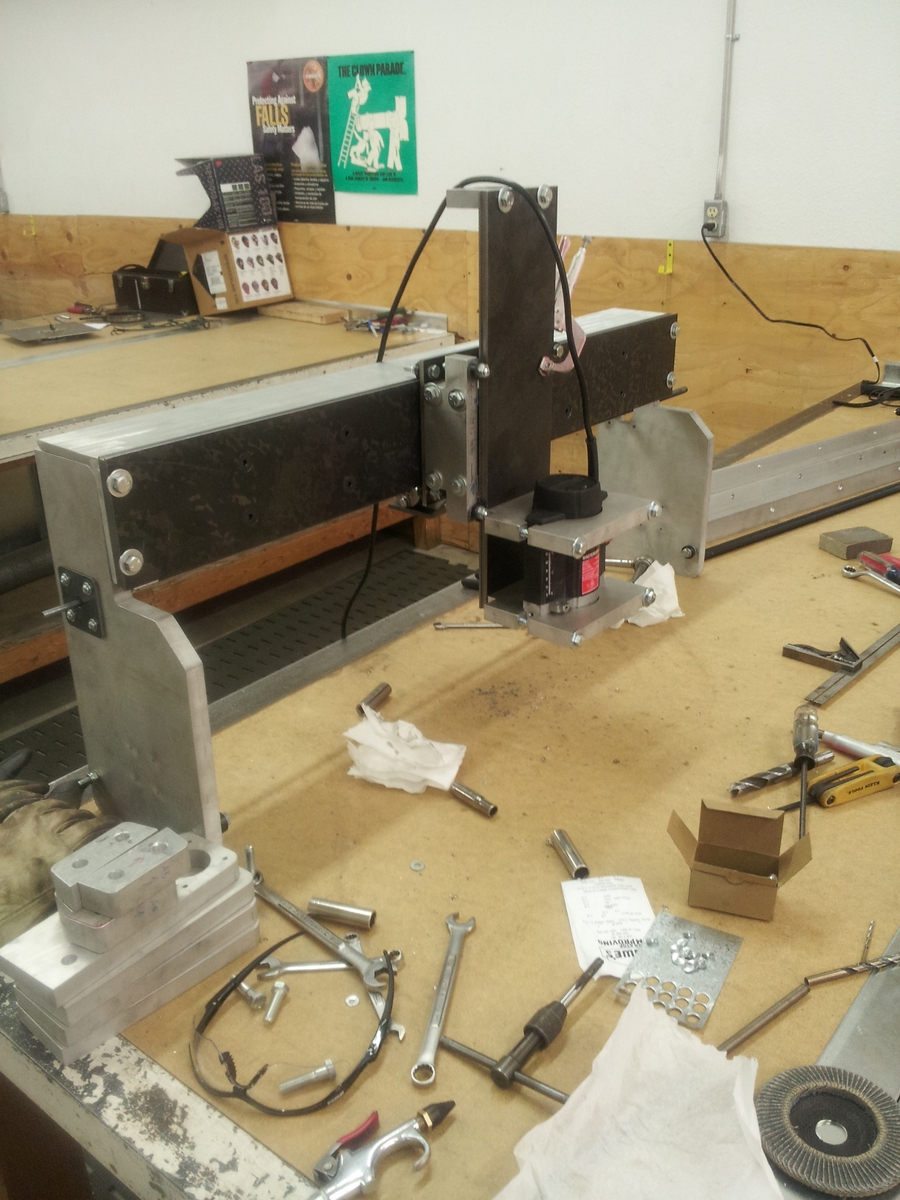

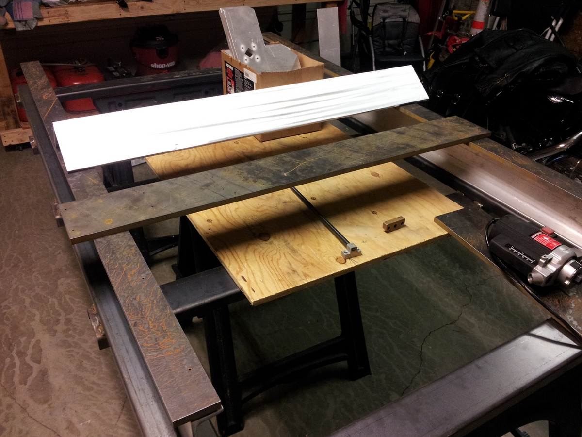

Been a long while since I've posted... it's amazing what happens when you get busy! anyway, i've been plugging away on the CNC router table and figured you guys might want a pic or two. this thing could be operational by March 1st!
