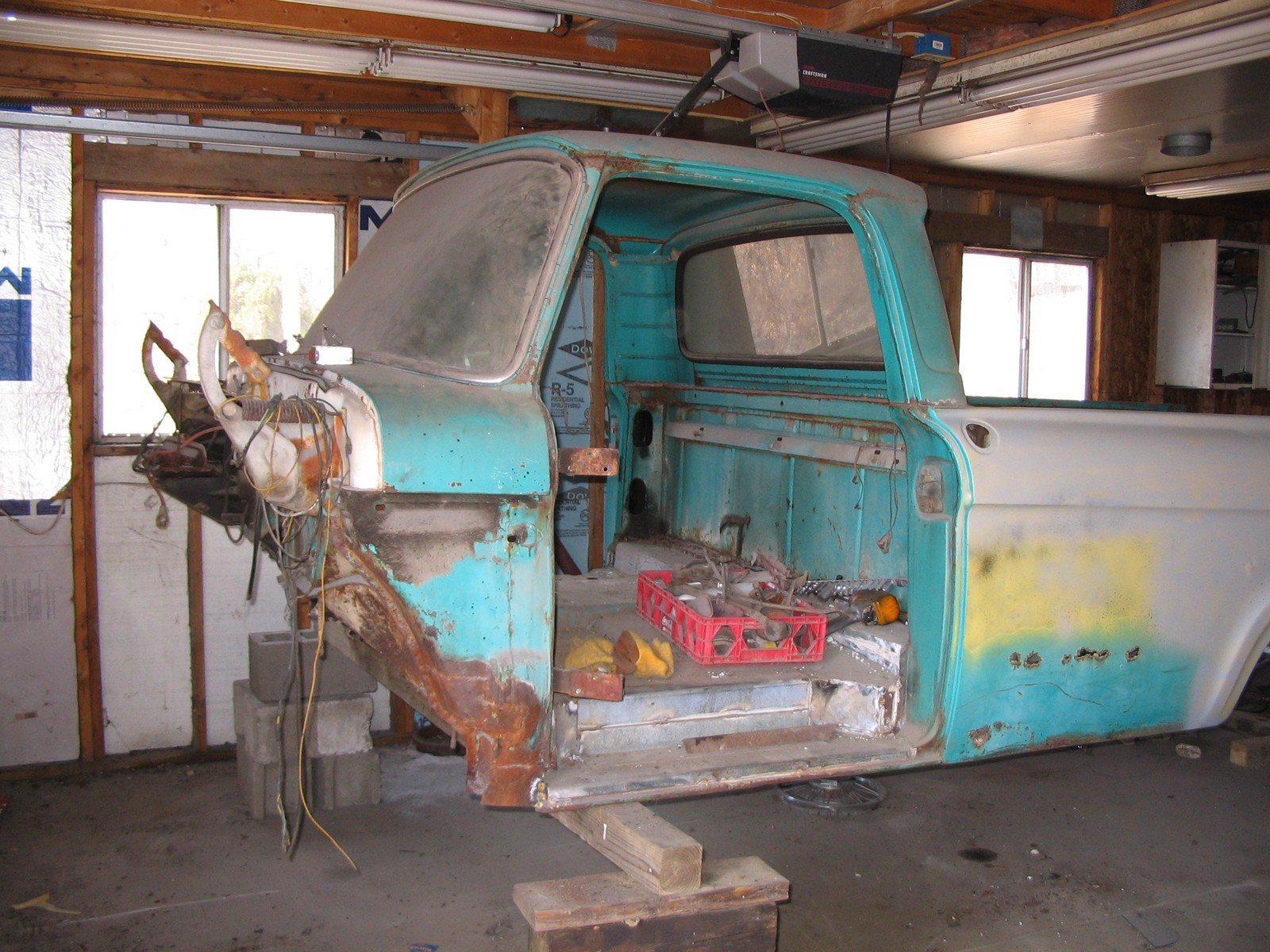

I'm taking a short break from the boat work... I got tired of itching from fiberglass dust :)
Some may recall my '66 Ford, Which I bought because it looks cool towing my boats-
I decided a while back that I wanted to do some work on her- And when I started evaluating what needed to be done, the list kept growing and growing, until I decided if I was going to do it, I might as well do it right!
A few people here expressed some interest in seeing the restoration work progress, so here goes!
The cab had issues- The floors needed to be replaced, the cab mounts were bad, and there was a lot of Bond-o in the cowls. By the time I bought all the sheet metal, and did all the welding that would be required, I was talking big bucks and long hours, so I found a 'new' cab to replace it with. It's got SOME rust issues, but nothing that can't be fixed with a little welding :)
After the damage was cut away... There was a little in the door pilar underneath, too- I cut that out and made up a patch..
Starting to patch it up... I'm fabricating the patch panels as I go-
Welded up and ground down-

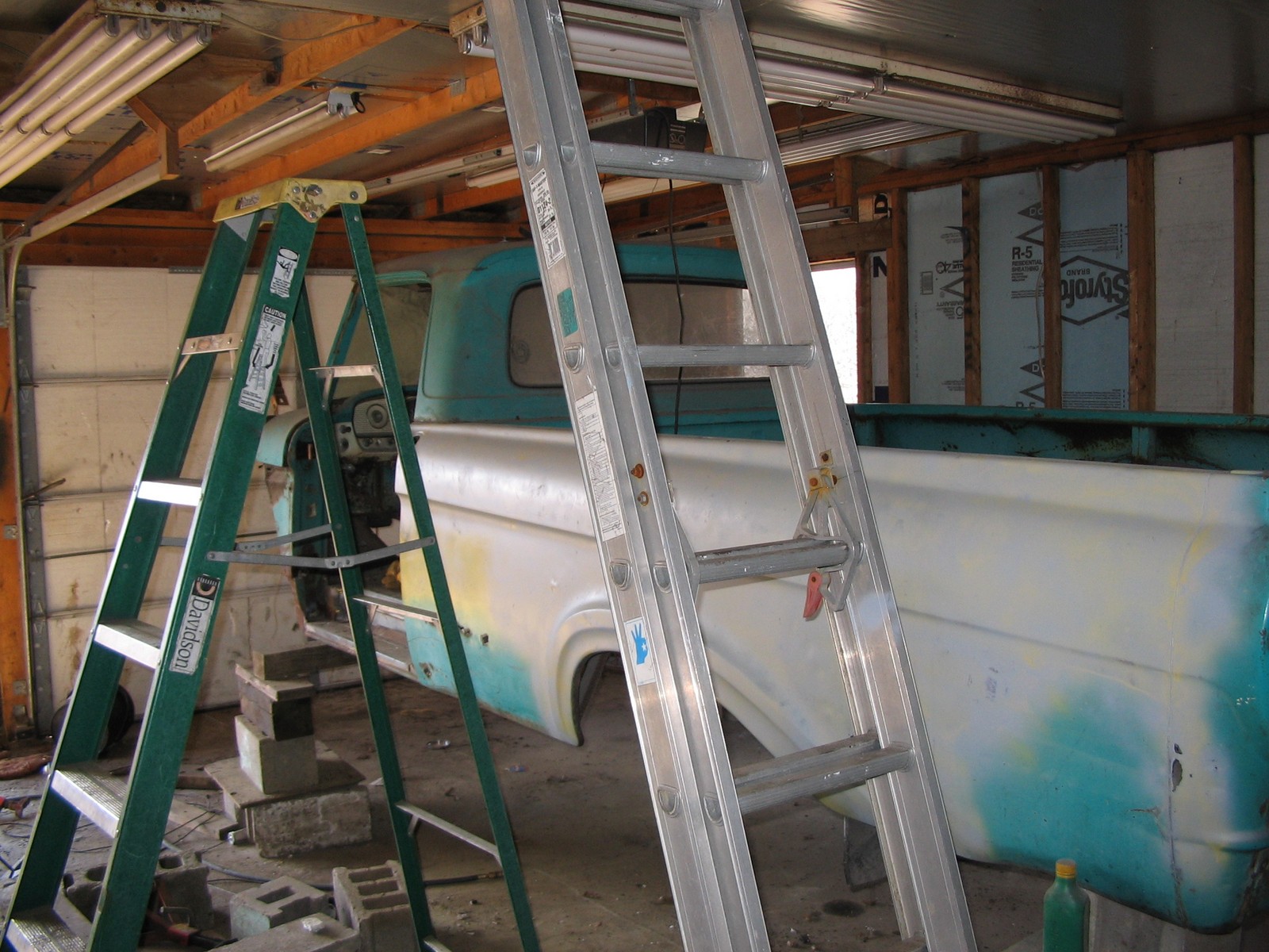

Work continues slowly... I'm working on the Lake N sea and several household projects at the same time. It also doesn't help that some jerk in my neighborhood called the sheriff on me yesterday, and told them that I was making too much noise, and keeping them awake. It was 9:30 am- I always wait 'till at least 9 to start grinding for that very reason- Not because I have to, but because I am a nice guy. The deputy just stopped by, told me that there had been a complaint, and then told me that I could keep working if I wanted to since I was breaking no laws... Then, he saw the Lake N Sea sitting in the garage, and commented on her. He stayed and talked about vintage boats and trucks for about 10 minutes, until he got another call :)
I needed the cab corners from my old cab to finish up the 'new' cab, so it was time to pull off the bed. I had to cut the heads off the bolts in the bed, since they were pretty rusty. I managed to cut all 6 with very minimal colateral damage to the bed floor, Though I'll be doing a LOT of work on the bed so a little damage here and there isn't going to hurt much :)
Then, after finally getting the last two bolts out of the frame, back by the bumper (luckily they weren't rusted nearly as badly!), I lifted the bed off-
That gantry is the BEST $100.00 I've ever spent on a tool, for sure. It made the job super easy, even with only one person. Between the boats and the truck, I use it all the time!
Then, I set the bed down on a wheeled base-
The base was actually built for the Lake N sea- It held the hull while I rebuilt it. I built it so it would hold the bed, too- It makes it a lot easier to be able to wheel it around where I need it!
She looks a little different with a naked rear end!-
It is also going to be SO much easier to do the brakes, suspension, etc without having to crawl under this thing...
