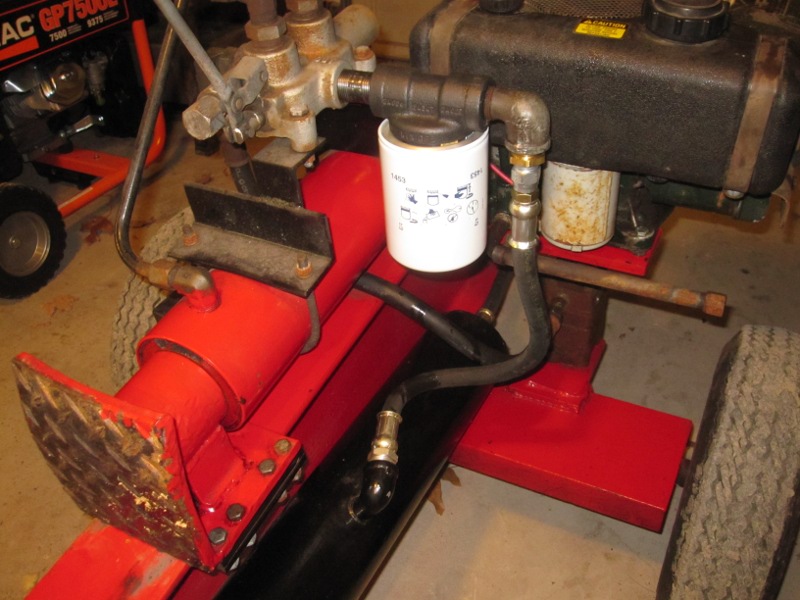

Hydraulic filter 15 years 4 days ago #50741
I think this is about it, unless I do something more with a battery mount. Spin-on hydraulic filter from NAPA, filters to 32 microns.
Got up, made coffee, stained some shelves, touched up the paint on my "new" trailer tongue, then installed this filter set up and it's only 6:30!
Frank

Re:Got my "free" log splitter working (finally!) 15 years 4 days ago #50746
frank, never heard of a filter for the hydraulic fluid on a log splitter. why? great idea for the clock btw.
Re:Got my "free" log splitter working (finally!) 15 years 4 days ago #50752
Ron, that hydraulic ram and controls were made by Prince Mfg. Corp. The controls are model LS3000, and the owners manual recommends filtering, so that's what I did. Just figured that out yesterday when I was screwing around on the computer just seeing if I could find anything out. Worked out great, Prince is still in business! www.princehyd.com/
Enjoy your day buddy!
Frank

i just got my mini hoe in the garage yesterday and got off the hose that was leaking,next ill change the hydrolic oil (yep i said oil,this machines hydrolics run on 40 weight oil)and filter,then gas filter and motor oil and filter.john
Re:Got my "free" log splitter working (finally!) 15 years 3 days ago #50790
Thanks John!
You been a busy fellow eh? Ya know, now that you mention hydraulic oil, I should check with Prince and see what they recommend. I filled the system with NAPA's R&O hydraulic fluid, maybe that's not what I'm supposed to use.
I never in my wildest dreams thought I'd have a gas powered log splitter and now I do because of Ron V. I never really thought I'd have a back hoe either. Hmmmm..... :laugh:
Good luck with that baby John!
Frank
