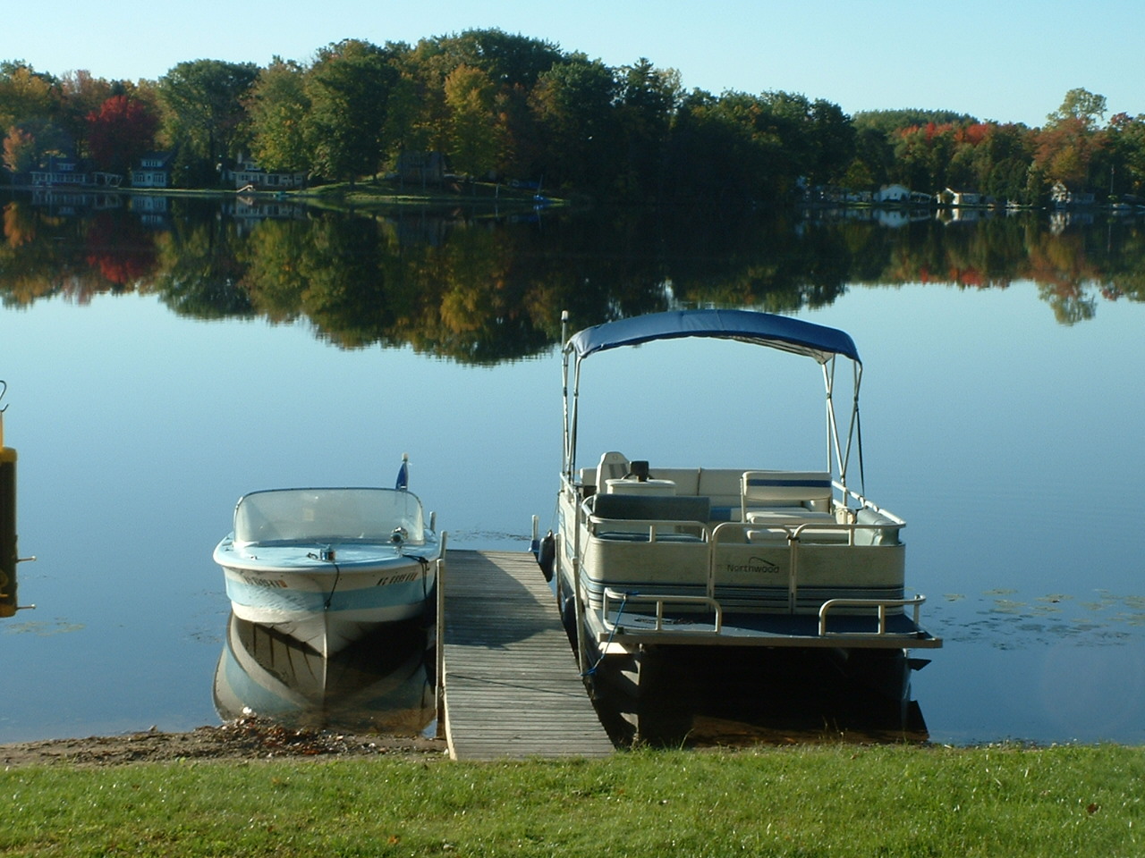

Here is a photo of my dock. It has 3, 10' sections. the last section is the one that gets into the muck.
3' wide with 3, 2 x 6s with deck planking on top. Heavy! Should of uses 2 x 4s instead.

wow...that lake is like glass......
