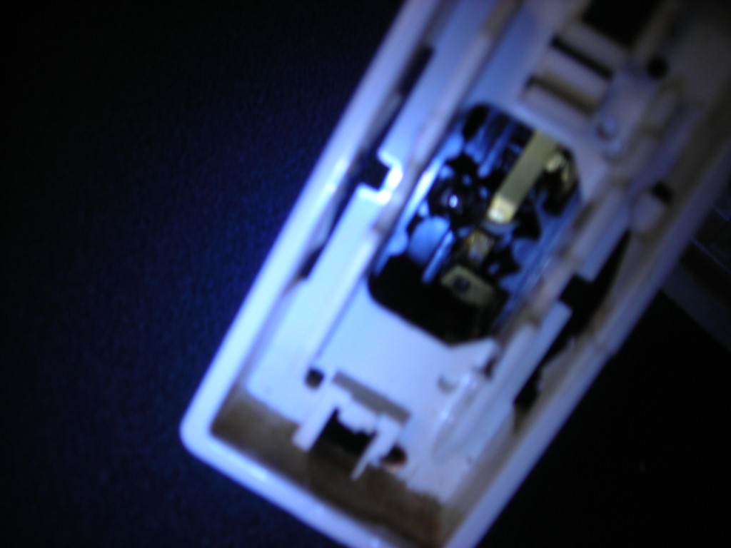

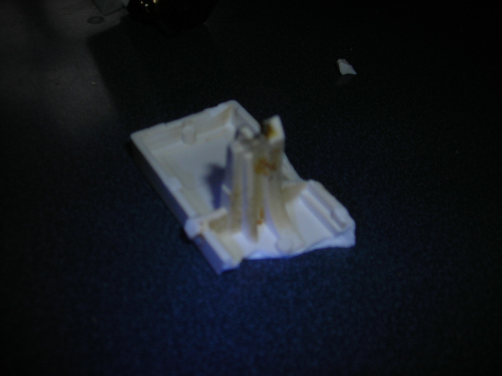

the other day i went to shut off the light to the bedroom,and thought i heard a arking spark in the light switch,but thought i was hearing things,so last nite i heard it again,we kept the light off until today when i could see in the daylight.
i took out the "designer style" light switch and the outside looked ok,so i broke it apart to find black soot and melted plastic inside the switch,what makes me mad is there are no marks to identify the maker.
all i can say is thank goodness i heard it before there was a fire,im telling this to let folks know about it,so you may not have this problem,keep a good ear out,im glad i didnt blow it off.i almost did,john

unleaded,it had the ul stamp onit and was made in the usa,i think it has alot to do with design,when shutting it off there is a pin(leg)that pushes down on the flat copper band and that pushes it away from the connection,breaking the circut,but as they get older they get loose and dont snap compleatly off evertime,leaving a space close enough to arc a spark across the teminals,by the way the house is 11 years old,john
