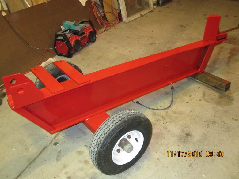

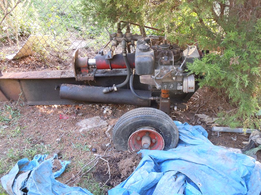

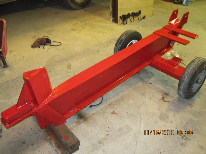

Got an old log splitter from a good friend a few weeks ago. In the process of renovation.
So far I've disassembled it, scraped and wire brushed all the crud off, washed it with hot detergent water with scrub brushes, then rinsed it off with real hot water. Wiped down with lacquer thinner, washed it in hot detergent water again just with a sponge and rinsed with real hot water. Sanded it, wiped it down with mineral spirits, let it dry, and put on the 1st coat of rustoleum red.
Got my electric start motor, same model & hp as the one that was on it, just having a hard time getting the old pulley off. May end up dicing it with my angle grinder and a cut off disc.

Thanks John, just the first foam brush application of rustoleum red. Cold in my garage so may take a couple days to dry good before the next coat. Still need to paint the ram and oil reservoir, but I'm just taking my time. Getting a few new hoses made up for it too.
I do believe it will be a great log splitter when it's done, plus look good too. I enjoy doin stuff like this.
Frank

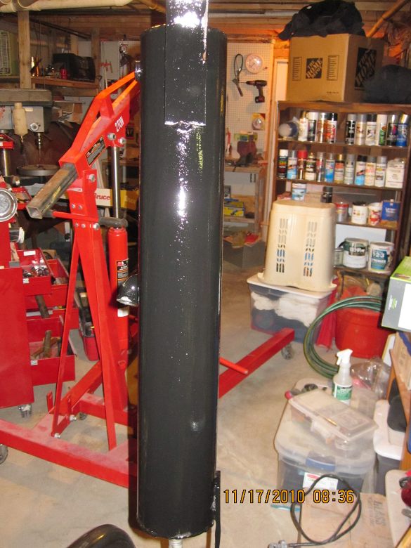

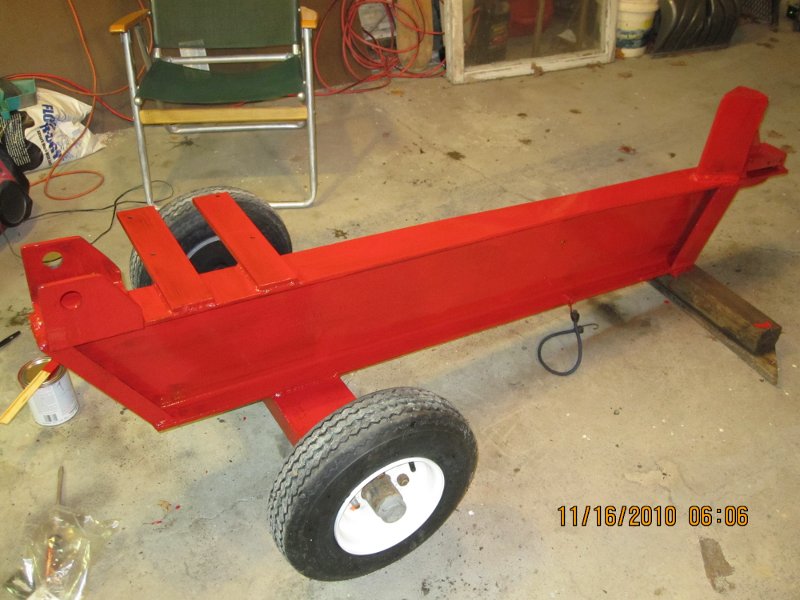

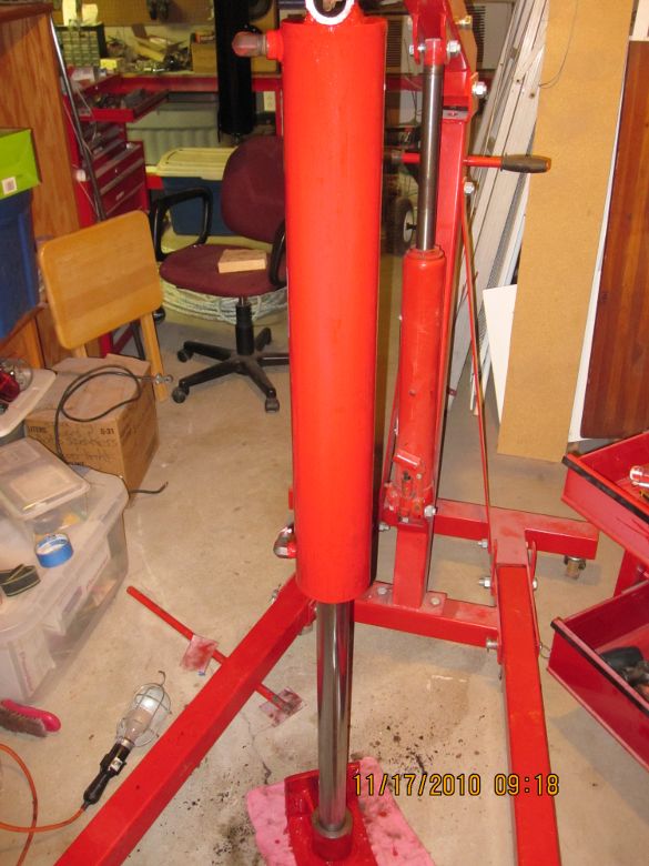

Log splitter renovation pics 16 years 6 days ago #19965
1st coat oil reservoir, 1st coat ram, 2nd coat ibeam
Re: Log splitter renovation pics 16 years 6 days ago #19966
After you get it fixed up and pretty . It will look to good to use.
Re:Log splitter renovation 16 years 6 days ago #19968
Nah, it won't look as good as a brand new store bought one. We'll use it!

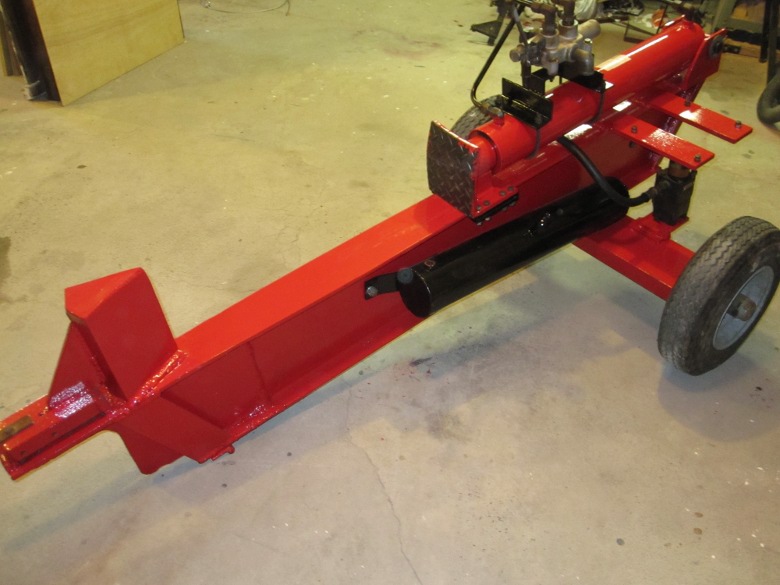

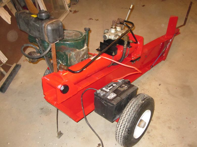

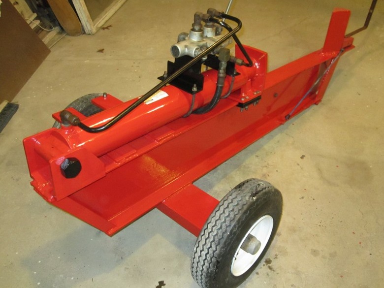

Painted, assembled, just needs a motor 16 years 7 hours ago #20333
Assembled this a.m. Need to work on one of the two motors I got, figure out what way to go. Haven't got back to the original pull start. Fixed the recoil on it, strung new recoil rope, got a new plug, air filter (not installed yet), dumped the old gas, tank has been drying out a few weeks. Electric start motor will require $. Needs a new top 1/2 lovejoy fitting because the shaft is bigger, will need a solenoid and switch, plus I'll have to figure out a gas tank. The original pull start motor has an integral tank, electric start one doesn't. Got a spare tank off an old lawn mower, but not sure how to set it up to feed the motor. Does the tank have to be higher than the carb?

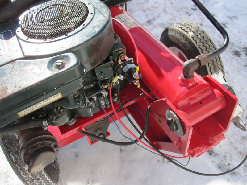

Got the motor running, tank on, just need a coupler for the pump (coming UPS probably Tuesday), a starter solenoid, ignition switch, a couple hoses, and hydraulic fluid (last 4 items coming from NAPA). Need to make some kind of bracket to hold the solenoid, starter switch and throttle. Shouldn't be too difficult, but I don't feel real hot, so it can wait till we get home. Leaving for Buffalo early tomorrow, home late Saturday.

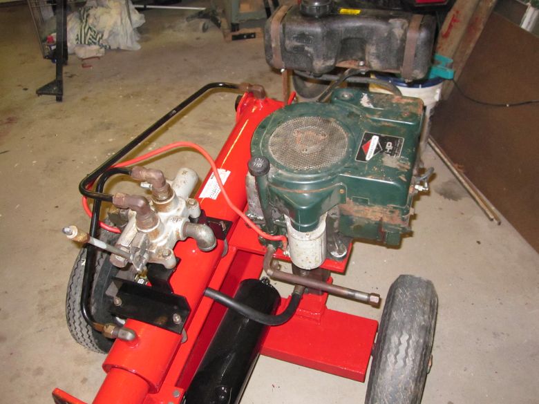

Re:Log splitter renovation 15 years 11 months ago #20564
I got smart, robbed some brackets off the other motor, mounted it like it was supposed to be there.

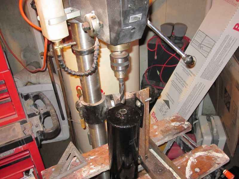

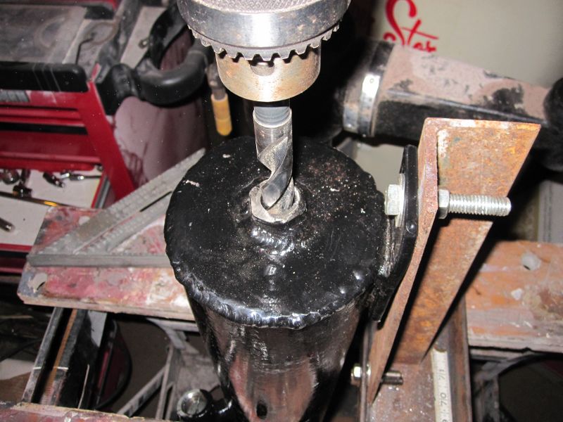

Drill and tap 15 years 11 months ago #20907
One of the last things. Drill out the end of the oil reservoir so I can tap it to 3/4 pipe. Cut off the welded-on nipple, then made a jig this morning with some scrap steel and my decades-old Stanley Handyman workbench so the reservoir is centered perfectly under my big floor mount drill press. Drill bit shown is 5/8, 3/64 less than the hole size. I need to drill it to 59/64 to tap it. Ordered the bit, just hasn't come in yet.
Still need to pull the motor to install the new lovejoy coupling, get the solenoid, starter switch and kill toggle wired up, anchor the battery, install the new hoses, and fill it with hydraulic fluid. I'm probably weeks away from completion at this point.

Re:Log splitter renovation 15 years 11 months ago #21907
It's waiting for my back to recoup Ron. I got the end of the reservoir drilled and tapped for 3/4 npt, then ran into a weird problem. There was a filter welded inside of the reservoir. A good friend helped me get it out and then re-weld the end back on last weekend. I got it painted and ready to go back on (with an external filter), but my back problems this week have limited my ability to do much except get to work and back, which is the most important thing. Everything now is pretty straight forward, new electric start motor works good, it's just stuff I can't do right now. And don't get me wrong, I'm NOT complaining. I'm a lucky guy.

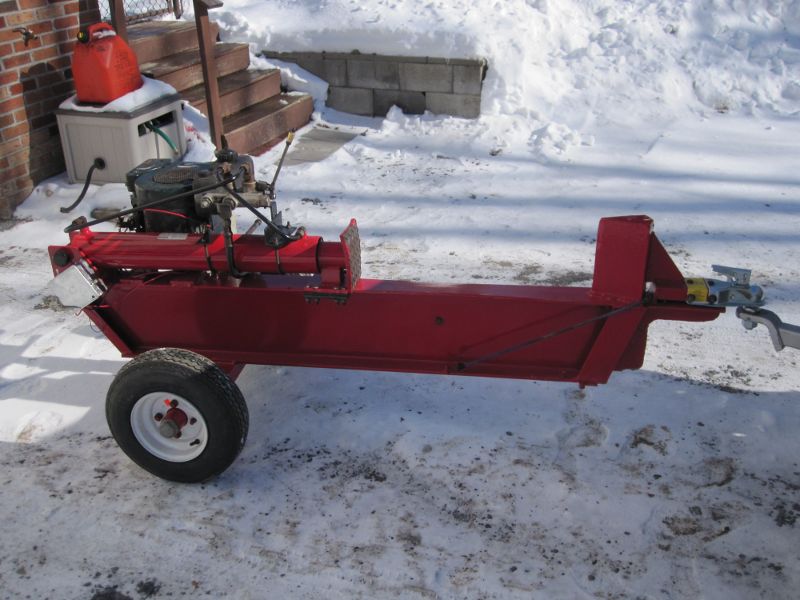

All ready to go to NAPA for some custom hoses and an external filter for the oil reservoir. All the wiring is done, but it needs a few "tweaks" before operation, like filling the oil reservoir and ram, and bleeding it. She's coming along, won't be long now.
