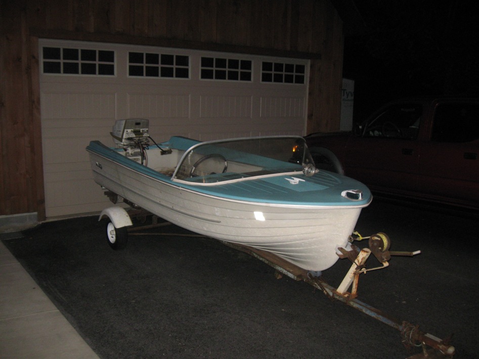

New member here from WV! I bought my MFG last year, I think it’s a Niagara but I’m not sure, I’ve not seen any info on one that has the same type of transom and dash. Also the floor in mine was plywood… I just bought a low hour 40HP Evinrude with tilt / trim, I’d love to get the boat on the water this summer! I need a hand identifying what model it is and could use some input on how to put a floor in it. The floor was plywood that was supported with some wood wedges and had a layer of nasty old foam under it. Im thinking about getting some marine grade plywood, and trying to split some heavy rubber hose to put around the edges of the wood where it meets the fiberglass then carpet over it all but have no idea how to properly put a floor in this thing! Open to suggestions and any help with identifying the year and model would be great! Thanks again for having me! Matt

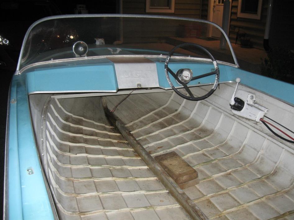

boat floor

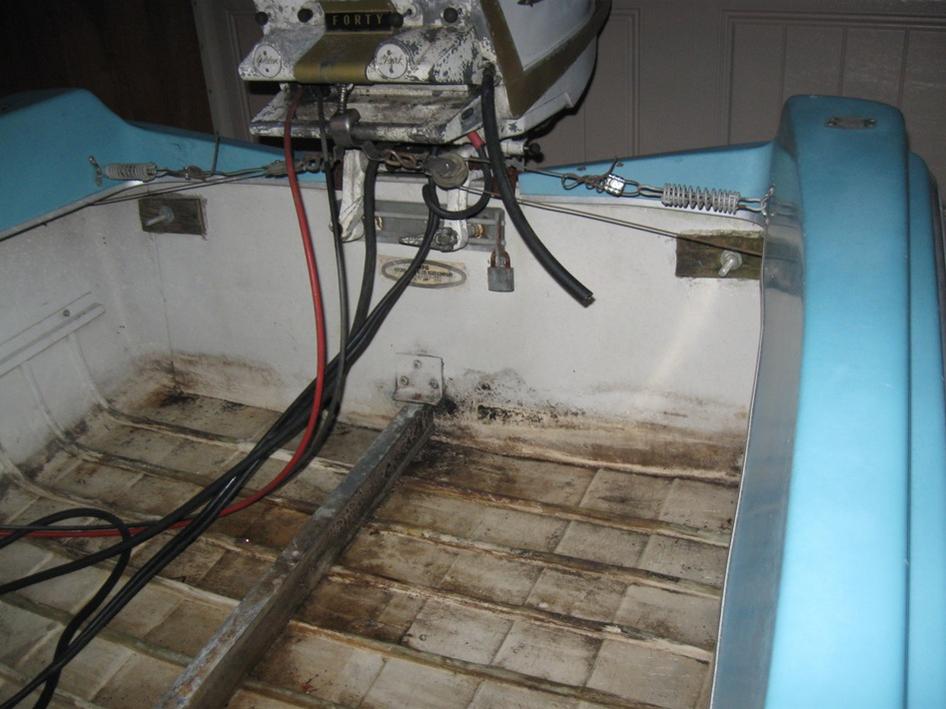

transom

old engine and transom

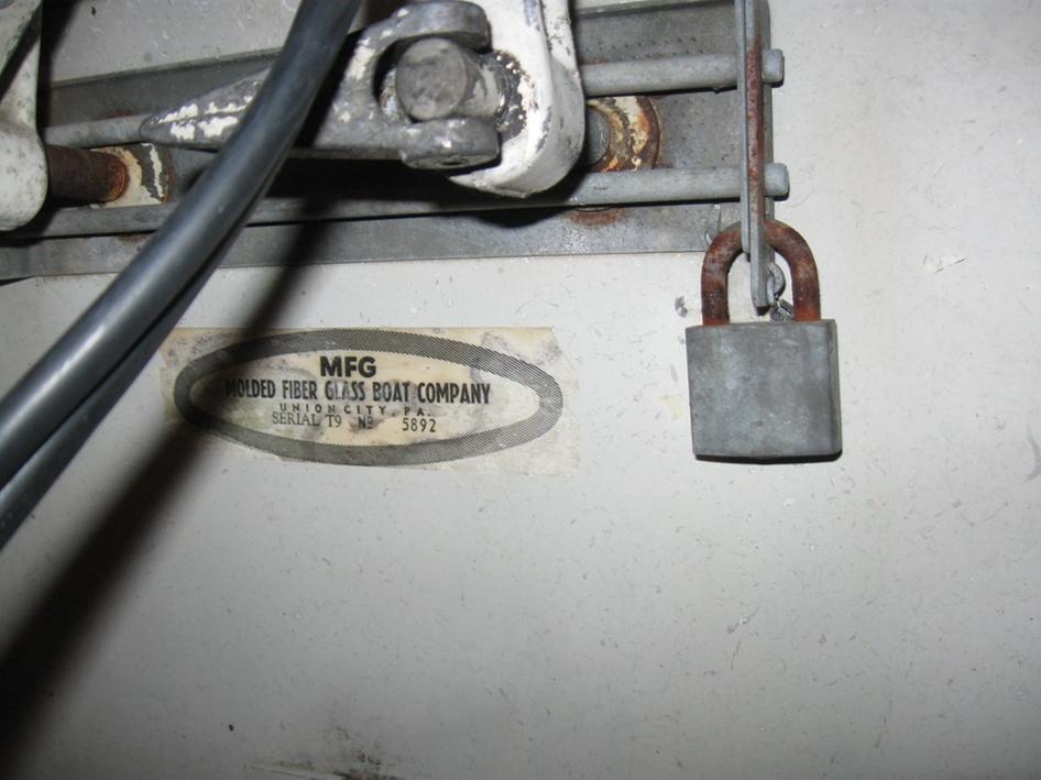

MFG tag

I thought it was a mid 60s Niagara Custom but none of the ads Ive seen for them have the same transom and since my boat does not have the built in fiberglass floor Im second guessing myself. That said, the boat did have a 1959 West Bend golden shark 40 on it, so it very well could be older than I thought as the steering wheel looks like the ones Ive seen on early MFG boats in pictures. Any ideas?
Re:New member, need a hand identifying my MFG! 12 years 6 months ago #93245
It's a 1961 or 1962 Corry Carefree Deluxe. Check out the Library for more details. 1961 brochure is missing, but 1961 was first year glove box was added to center of helm area. If I had to pick, I'd say 1961 due to white rub rail, but MFG was sometimes inconsistent. It's 12' 6" long.
It was the last MFG made (up to 1963) that had a painted wood floor with exposed aluminum stringers and the little fiberglass ribs.
My dad had a 1960 Corry Carefree for a time growing up. Love to find another sometime.
It will fly with 40 hp. Rated for 30 hp. My dad's flew after he upgraded the original 18 hp Evinrude and put on a 28 hp Johnson.

Forgot to mention that while there are no wood stringers to rot, there is wood between the fiberglass layers in the transom to check, plus normally a plywood floor and seats with aluminum supports for both. The Carefree Delluxe seats were upholstered as the boat came from the factory. Earlier models were just varnished wood.

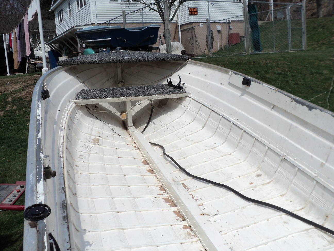

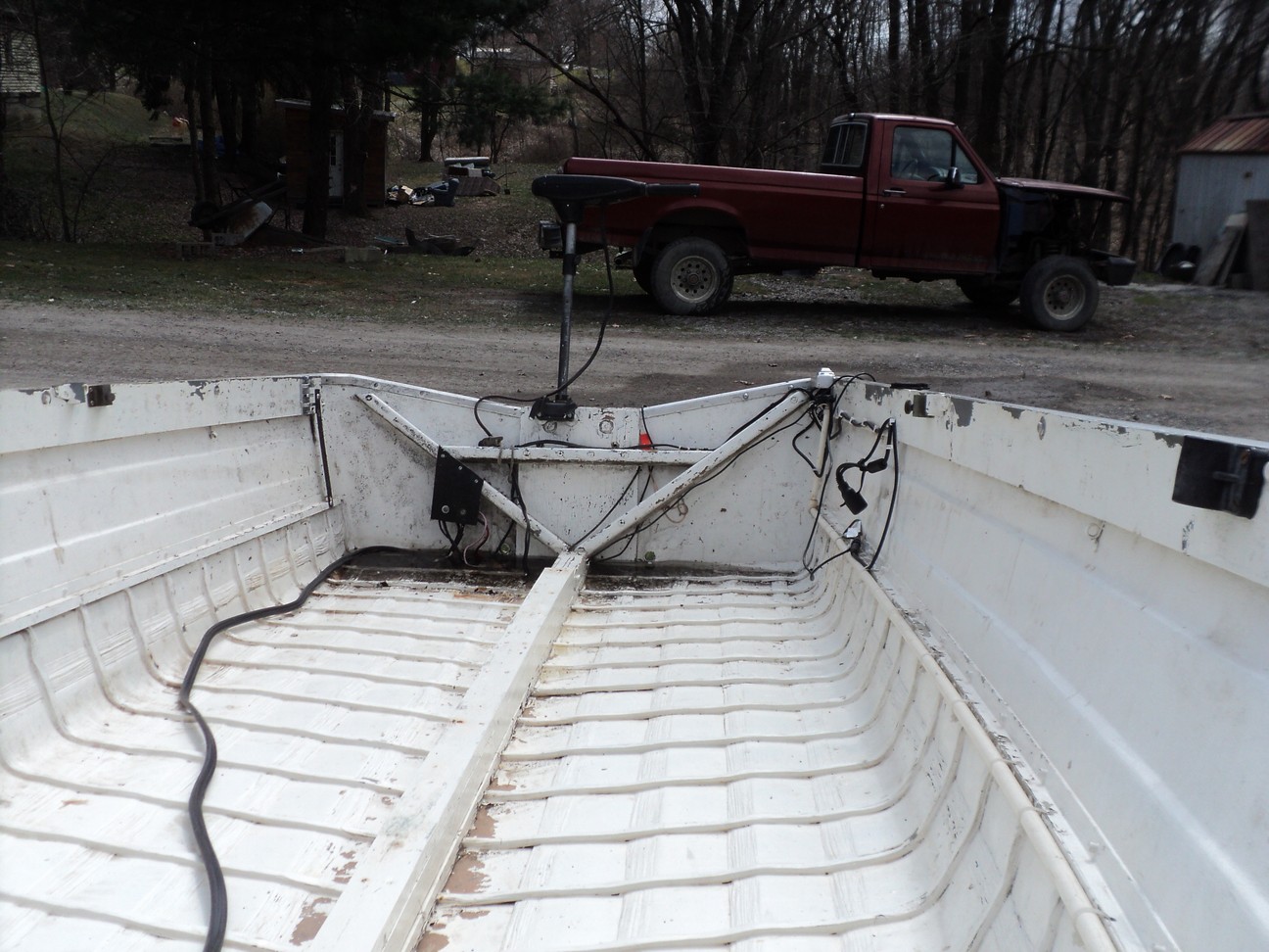

This was my 58 Corry Suburban. A Pre-runner of what you have. You can see the linage here. It's 12 1/2 foot. It also was a great performing hull. This was when I had the deck out for cleaning and inspection.

It has to be safe as we plan on using it, and Id really like to open the 40HP up! I know the transom needs redone, there is a slight hairline crack where it meets the inside floor and I’m sure it wicked water up in and rotted it, I was honestly going to dremel the top of the transom off, clean out the rotten wood and use Sea Cast, now that I know it’s a little older, and probably a rarer boat I’m not sure that’s the way to go because to do so I was going to cut through the gel coat and transoms alloy top. Any suggestions?

One more thought - you might be on the right track considering a Niagara. It was MFG's most popular boat in the 60's and thousands were made. For a family it's a little more practical, particularly if you can find one with the Sun-N-Fun seats still in good condition. Up to about 1970 or so they used fiberglass floors and stringers - no wood, as did the larger Westfield and Edinboro models. Only used wood in the transom and with Seacast or Nidacore, if it's shot, it's a DIY fix.
My brother did our family's Edinboro with a little help from his father-in-law with Seacast 10 years ago and it's still good.
