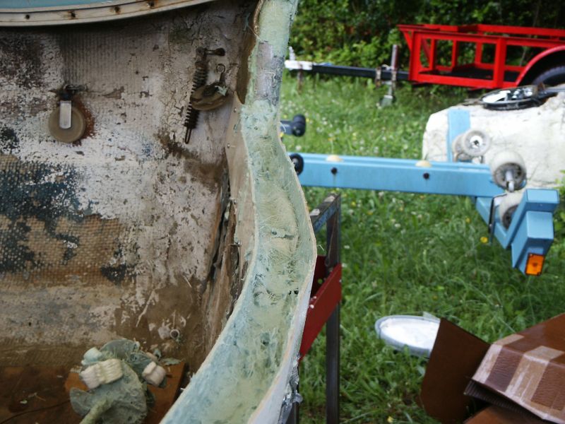

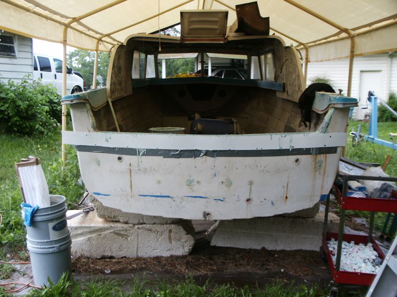

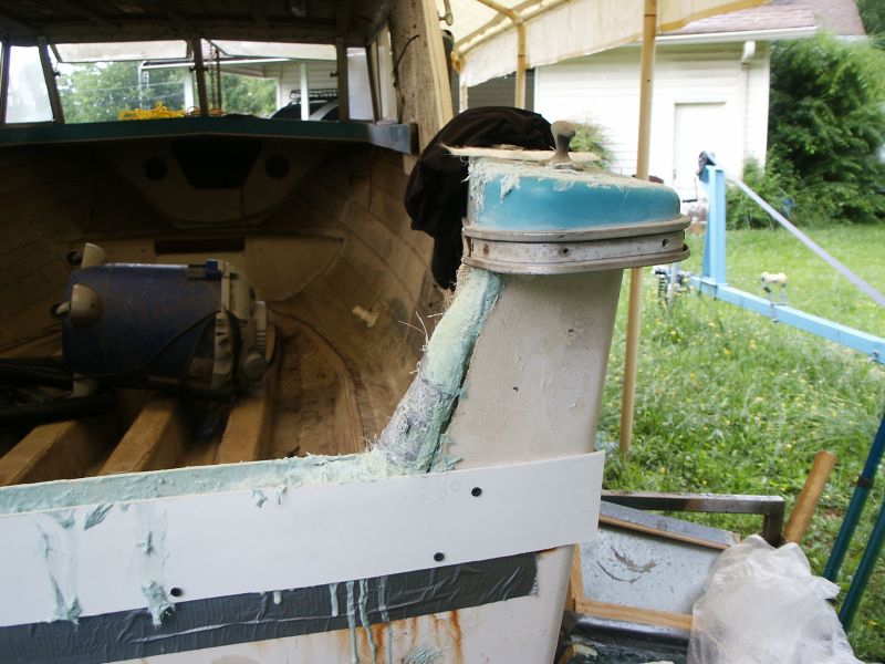

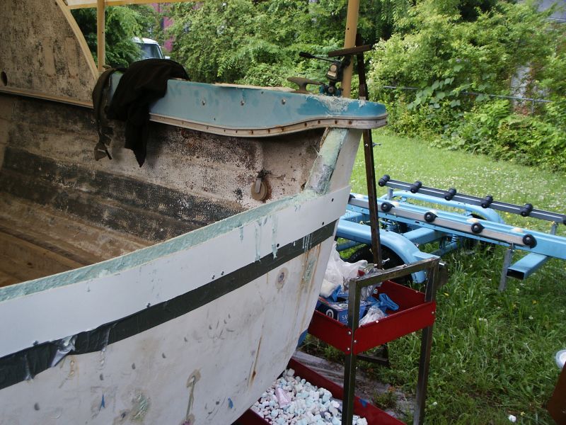

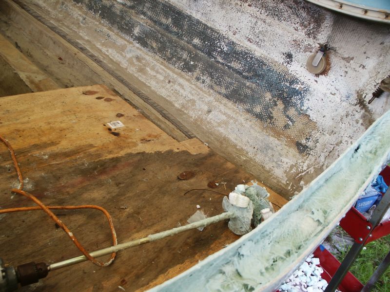

ok so i set up my transom and poured the 2 5 gallon buckets Saturday , and then came back and poured my 2 gallons this morning in the rain, couldn't set up the camera today cause the rain. but i followed the instructions and it worked just fine. i had maybe a quart of seacast left over . i pulled out the temp drain tubes. took off my brace, my kink is out a few holes to fill where my screws were. solid . don't wear anything you don't want to throw away. a rubber hammer a through of some kind a poke stick ,rubber gloves and a helper. im going to give it a few days then start forming it back down to my skins inside and out. fold some fiber over to cap it and fit my aluminum cap back on.
