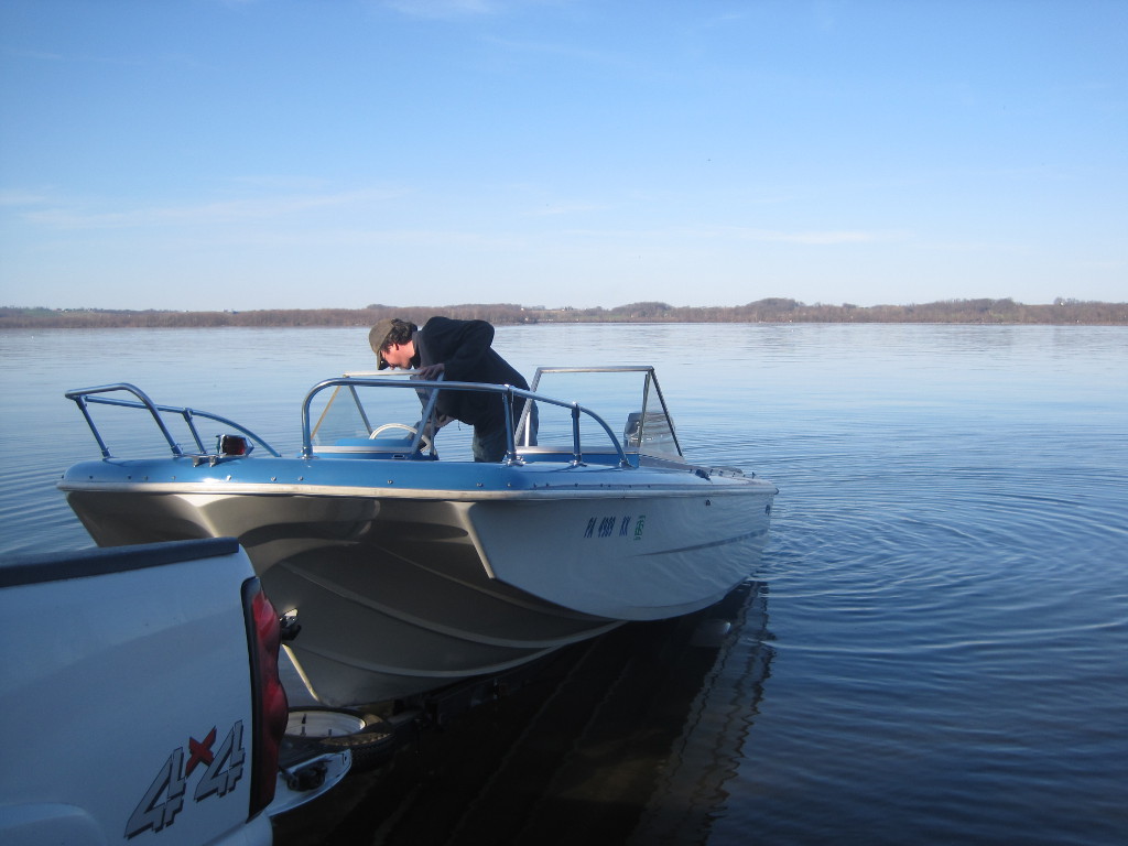

Thank's for letting me join the forum!
We just purchased our first boat. Have a WaveRunner 3 seater but we have 2 kids now...
Bought the Chevron from the son of the original owner. He still had the original bill of sale. He also had all the owners manuals for the boat, Mercury 1000 and the Holsclaw trailer.
The boat has been kept in a heated garage since new. For the price and the shape the boat is in it couldn't be beat! I was looking at boats 30 years newer that looked 30 years older.
Right now i don't have many questions that i probably can't find answers to by searching the forum. Like how to match the Gel coat exactly for some of the nicks, how to get the chrome to shine, and what is best to use for replacing the few torn pieces of vinyl.
Did i mention it has the original seats, and all the original vinyl for the top, windows, and aft cabin? Bow cover and custom cover too.
Well enough talk here are some pics. If anyone can chime in with advice I'll be glad to listen.
Cheers,
dan

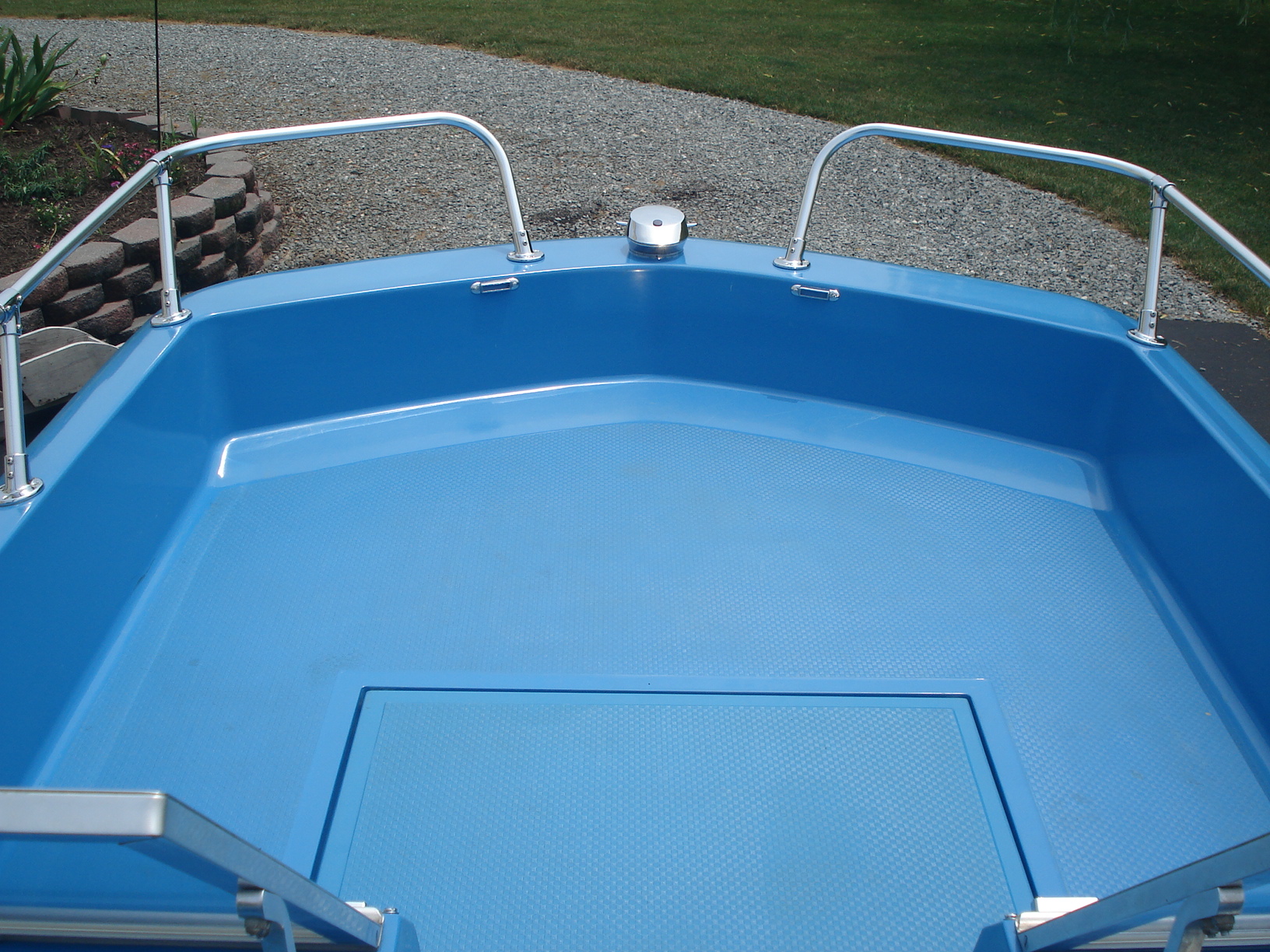

Here is another.

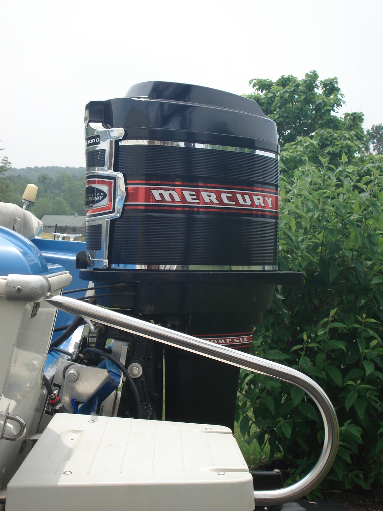

One more.
But this one brings up a question. Let me know if it should be in another part of the forum.
The unit might be leaking some water in. After we run it if i check the oil in the lower unit it is kind of grey/white. Also their are 3 screws on the side of it. One to fill it at the bottom, the vent at the top, and one above it marked flush. Something leaks out of there too.
The questions are:
As long as i keep fresh oil in the lower unit will it be OK to run it this season?
Does it make sense to invest in a rebuild of the motor over the winter, or should it be replaced?
It's a 1968 Mercury 1000 inline 6 dual carb with 100 HP.
Dan

Looks like you found a very well kept "survivor class" original, congrats and welcome aboard Dan. We've got some great folks here who are always glad to help out, I'll let them advise you on some of your questions.
One thing I might point out on the milky lower unit lube, many times this is as simple as replacing the washer/gaskets on the fill and vent plugs! Definitely worth a try, they're one of the most inexpensive parts you'll ever have to buy. :) We even have some members here who can help you out with O.E. Merc parts, as well as aftermarket replacements.
Re:Second Owner of a '68 Chevron 13 years 6 months ago #76917
  • ed-mc
  • Posts: 1482
  • Karma: 235
  • Thank you received: 131
Hi, Dan, that's a very clean rig, exceptional condition for its age! I take it that it's fresh-water-use only and you're currently running it in fresh-water as well?
The leakage you're getting sure sounds like bad driveshaft seals to me. On Mercs older than approx mid-70's, the driveshafts were made out of mild steel and would corrode around the seal area, causing oil leaks.
The only way that emulsified gearcase oil would leak from the "flush" plug is if it were coming up thru the driveshaft seals into the water pump.
In your case, with little or no salt-water useage (and very low hours if the condition is any indication of that!), likely you could get away with replacement of the (2) driveshaft seals that reside in the water pump base.
I'd say the worst-case scenario would be some corrosion pits in the seal area, which can be remedied by installation of stainless steel wear sleeves (aka Redi-Sleeve or Speedi-Sleeve).
These sleeves are readily available and relatively simple to install.
If the rubber impeller hasn't been replaced recently (or you don't know when it was last replaced), I'd highly recommend doing so before running it much more.
At the same time, it'll be a good opportunity to pull the water pump base and inspect the driveshaft/replace seals. They're not terribly expensive and are still available.
And considering a new impeller is around $23 from your Merc dealer, it's good insurance. Your motor, in its present condition, is worth well over $1000 and you don't want to burn it up this summer!
That being said, if you keep changing the oil you could "nurse" the lower unit along for a while. Only in fresh water, though. I wouldn't recommend taking it in any salt or brackish water in its current condition.
However, if you keep changing oil in the gearcase all summer, sooner or later you'll spend more on gear oil than you would on replacement parts to fix the problem!
BTW, if it has good compression and is running well, I wouldn't mess with the powerhead's innards. It probably runs better than most 10-yr-old motors out there and I'd much rather work on yours than a new one!!!
HTH...........ed

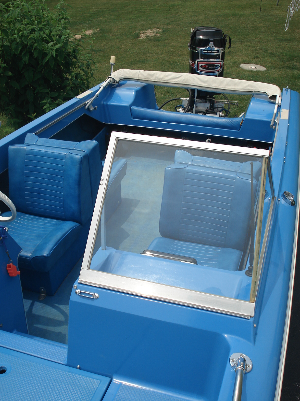

I have done some RC boats in the past. PT-109 torpedo boat and refurb'd an old run about that my dad brought back from Okinawa in 1968. It only went straigt or in circles before i put in RC.
Thanks for the compliments! I'll add another pic.
I'd do a gallery but don't see how to make one...
Dan
