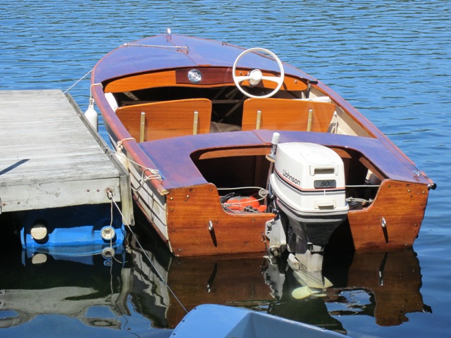

I got a couple pics from my dad.
Re:'59 Erie questions 13 years 8 months ago #75162
One more.

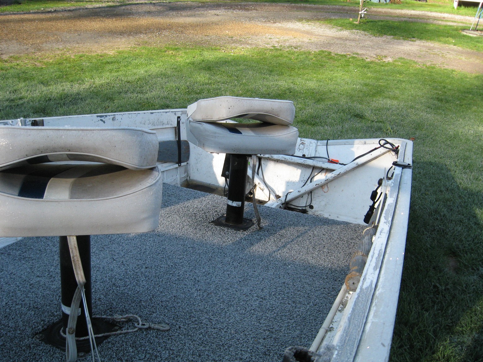

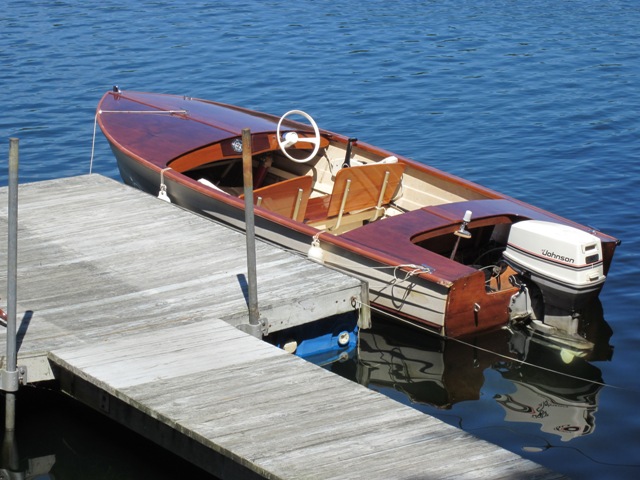

We just love pics on here. Mine is unrestored and is used just for fishing. Here you can see the inverted A transom,

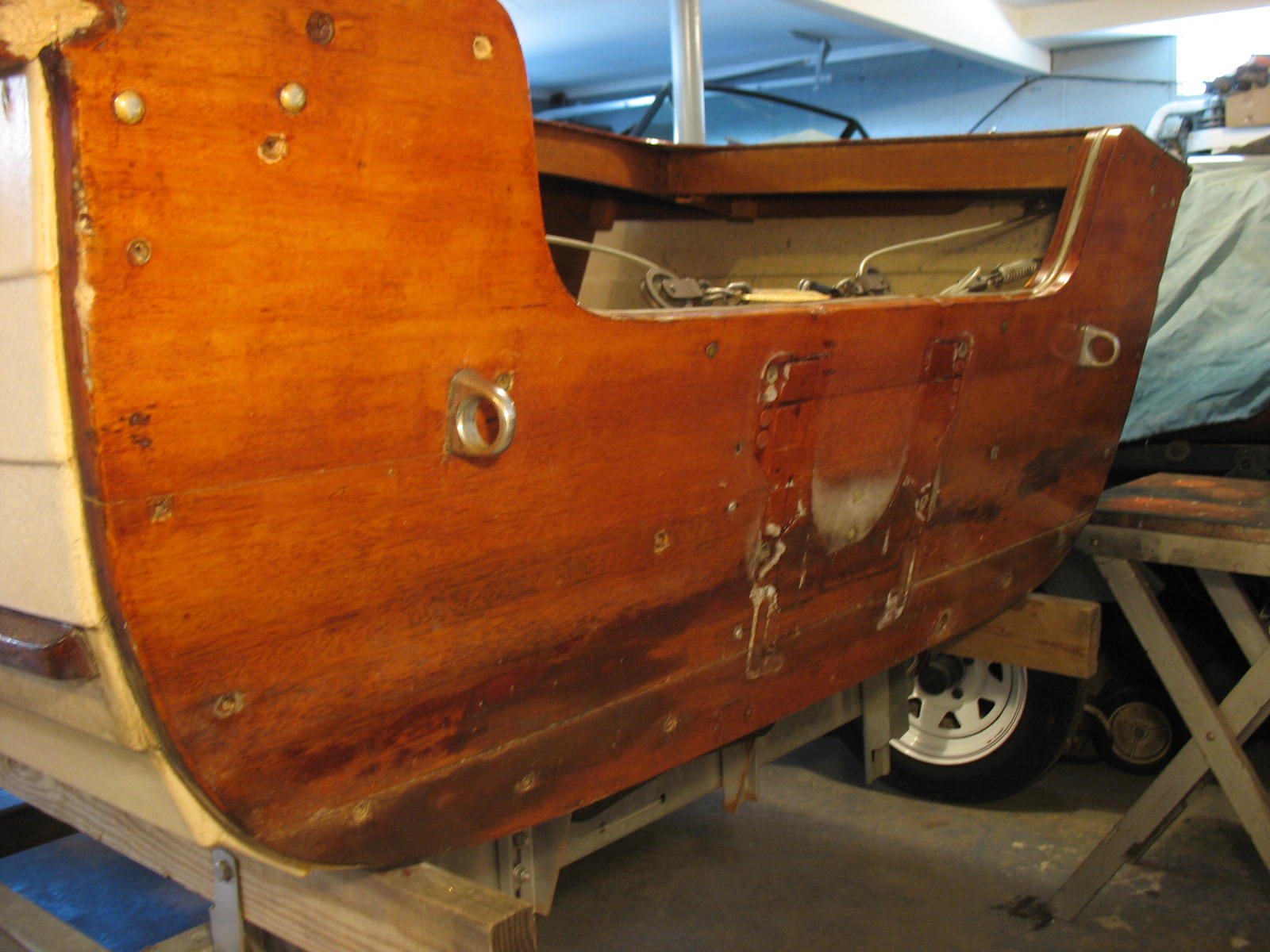

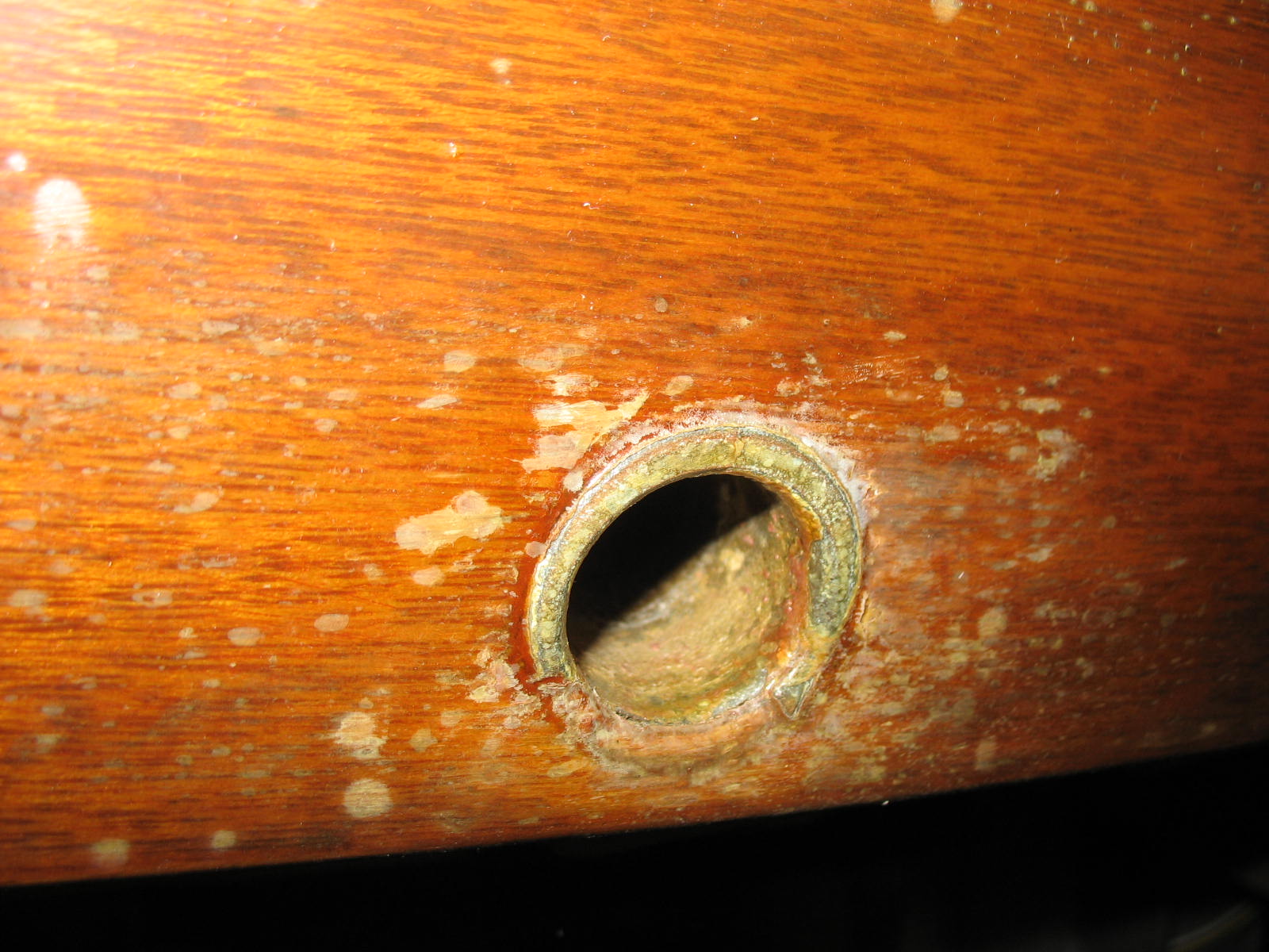

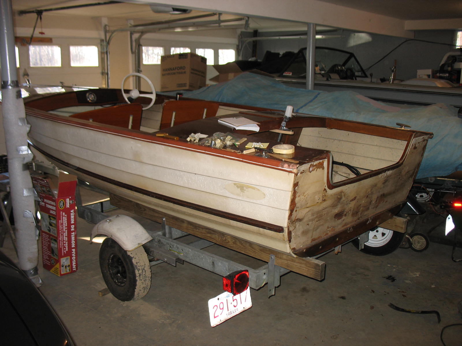

Well, today I got MOST of the outer transom off but the drain plug is an issue. Anyone know how this was installed at the factory? Seems to me it must have been crimped on both ends after it was installed. Looks like I'm going to have to grind the outer lip away to get the last piece of the transom board off unless you guys know something I don't.
I tell you one thing, these things are built like tanks! It was alot of work to get this far.

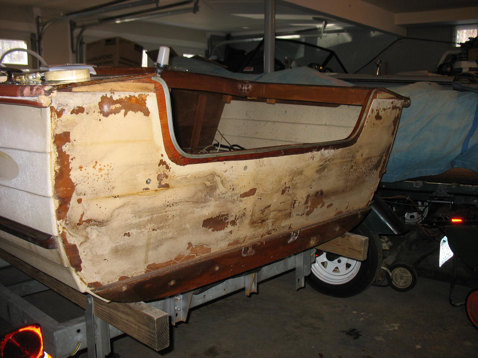

Re:'59 Erie questions 13 years 7 months ago #76086
Now-
Re:'59 Erie questions 13 years 7 months ago #76087
Another one of the whole thing right now after taking of the outer transom-
Re:'59 Erie questions 13 years 7 months ago #76090
Also, would anyone know what they used to seal the wood to the f/g? Whatever it was was brown, but there's probably a more modern equivilent out there now. Any recmmendations?
Re:'59 Erie questions 13 years 7 months ago #76104
The brass drain tubes come with the flare formed on one end, then once inserted (and hopefully sealed) into the drain hole a flaring tool is used to form the flare on the other end. (Some folks have success doing it other ways, or with a home made flaring tool.) To remove it, you can take a hammer and a screwdriver (or old wood chisel, something similar) and drive the flange toward the center of the hole, working your way around the tube. Then you can drive the tube out of the hole toward the end that still has the flange on it. Sometimes grabbing the edge of the tube with a needle nose pliers and twisting will draw down the diameter of the tube, making it easier to remove. Since you'll be replacing it, deforming the tube is not a worry.
HTH
