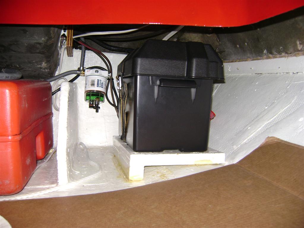

Definitely plan on putting a fuse panel or breaker box in for everything other than the motor itself. Marine grade wiring products are a must, and heat shrink is your friend in the long run. We can help with sourcing this stuff if you need a hand, I'll put a pic of my fuse panel recently installed in my project boat below.

That's a nice clean install you have there! I especially
like the clean white paint on the inside surfaces. I intended on doing similar but was considering something like a truck liner spray?
