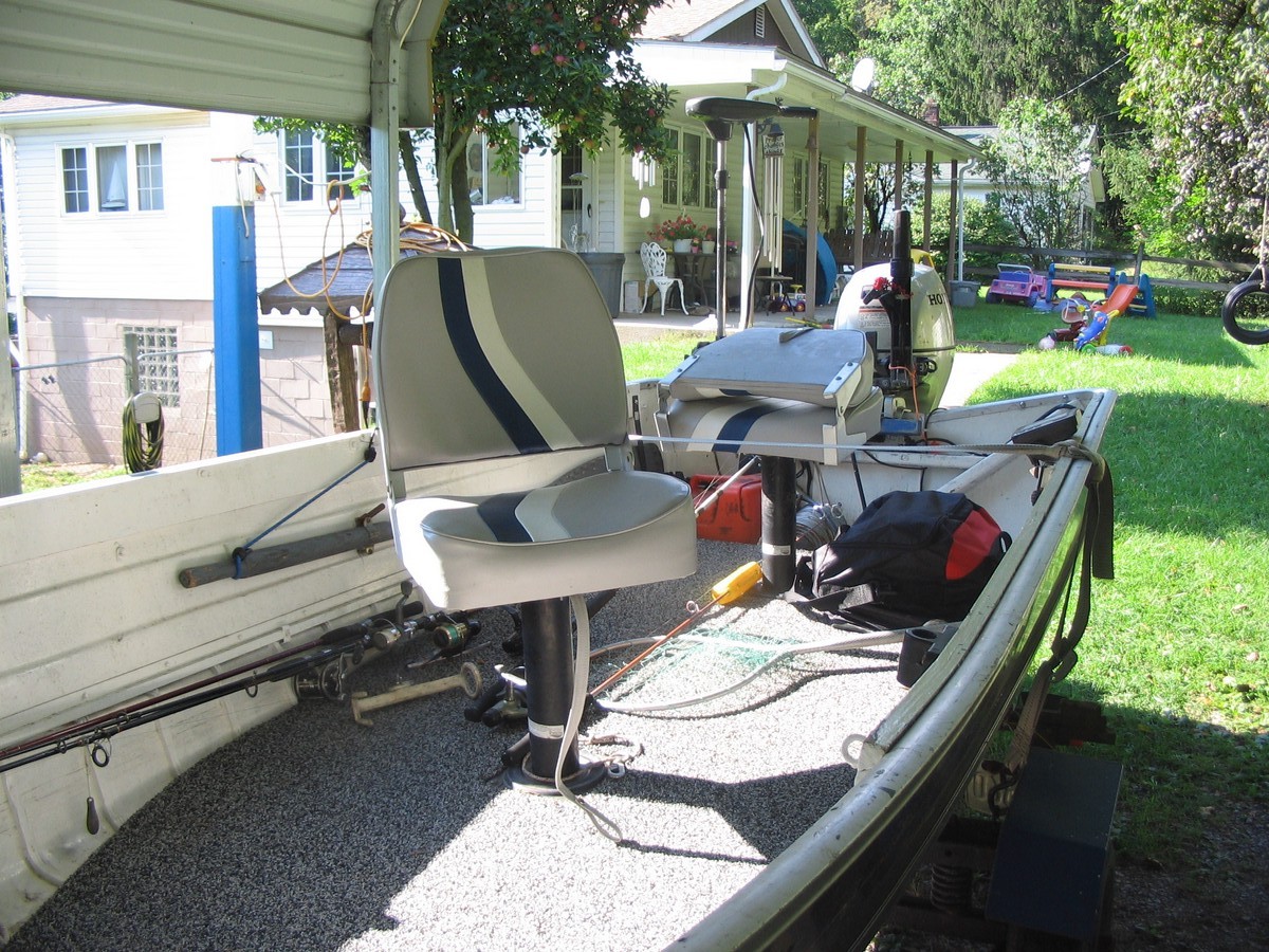

Well mine is easy. 1958 MFG Corry Suburban modified for fishing.
The butcher work was done before I owned it. If I had the missing parts I would restore it.

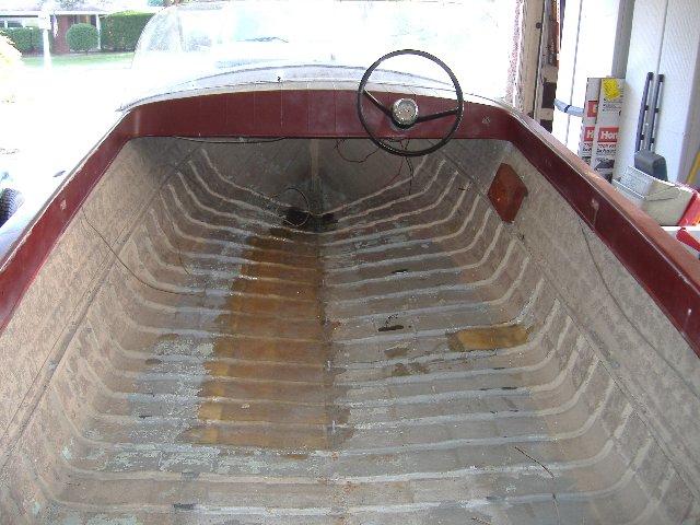

Hey Robert ....got any pics of your sole? Is that the way it came factory or did you put that in? You know I have a '60 Corry Carefree and the sole in mine when I bought it was similar to yours but not covered just painted and rotted. The catalog from 1960 shows it the way yours is. I am replacing it but I think I am going to put in a full sole and close it in. I am afraid that I would be dropping things and they would slide between the ribs and under the sole .... LOL.
This is what mine looks like now:

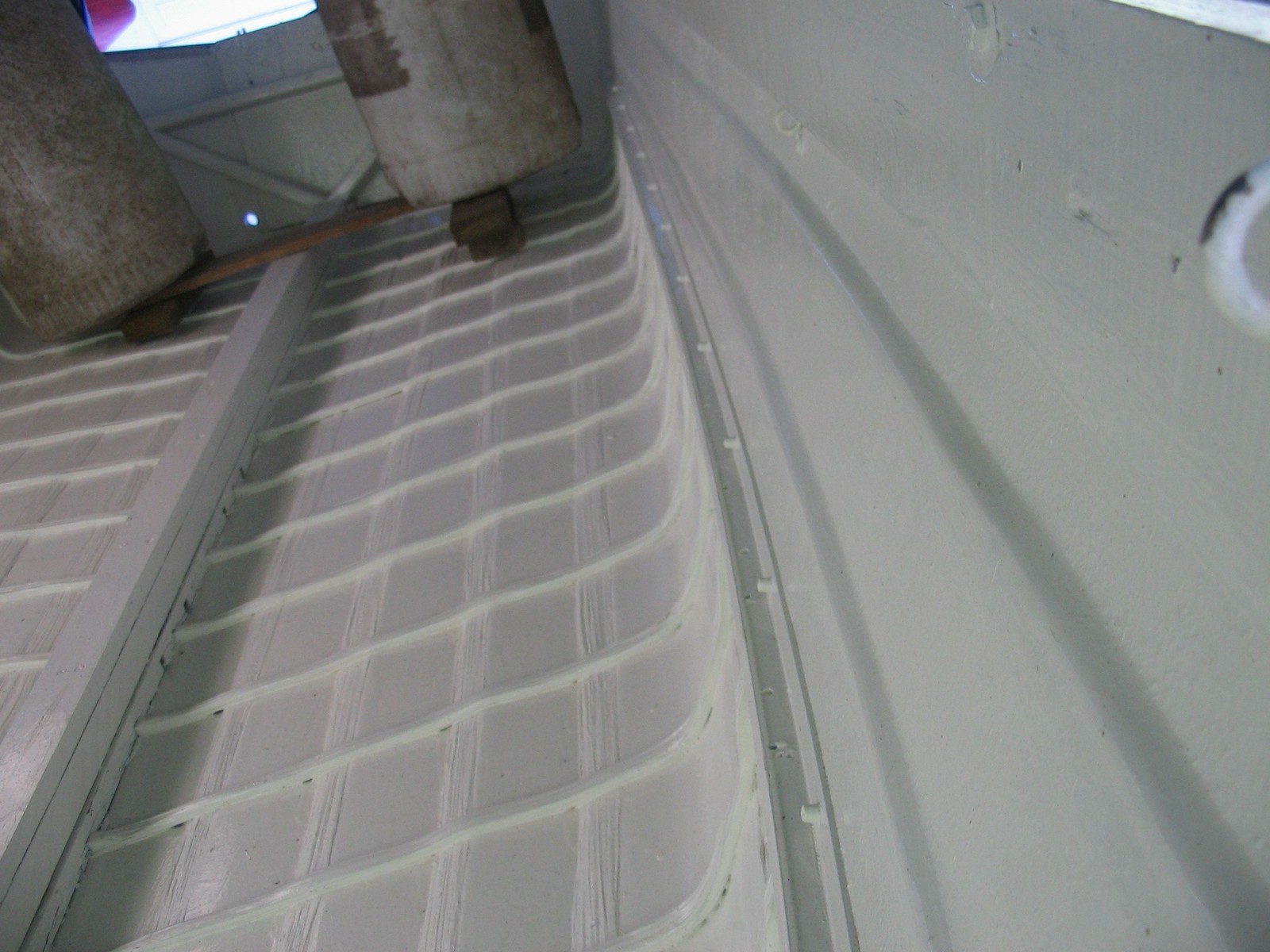

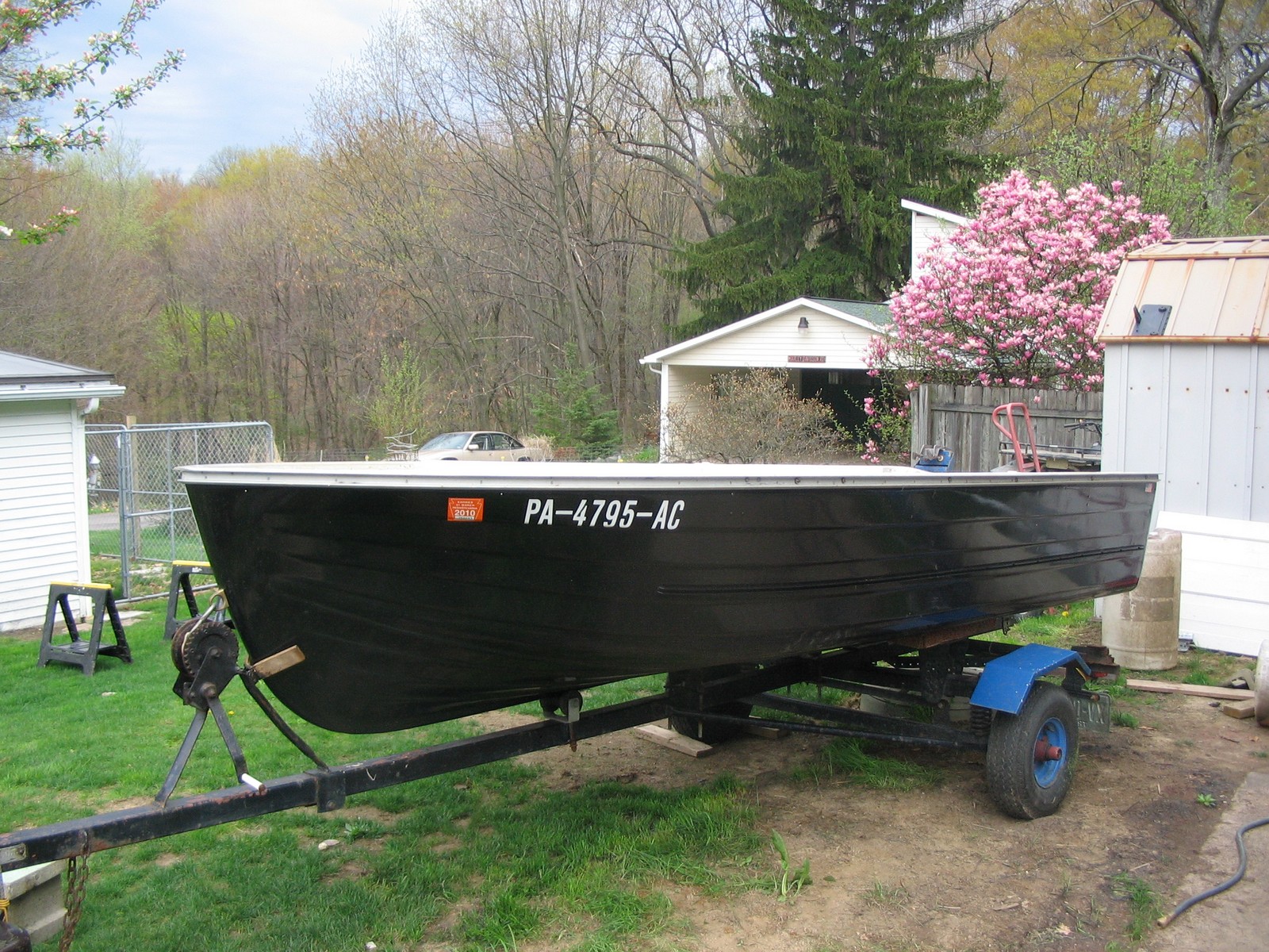

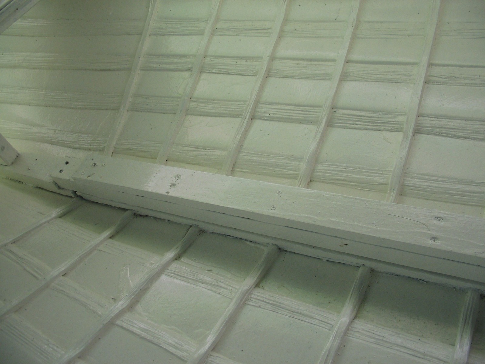

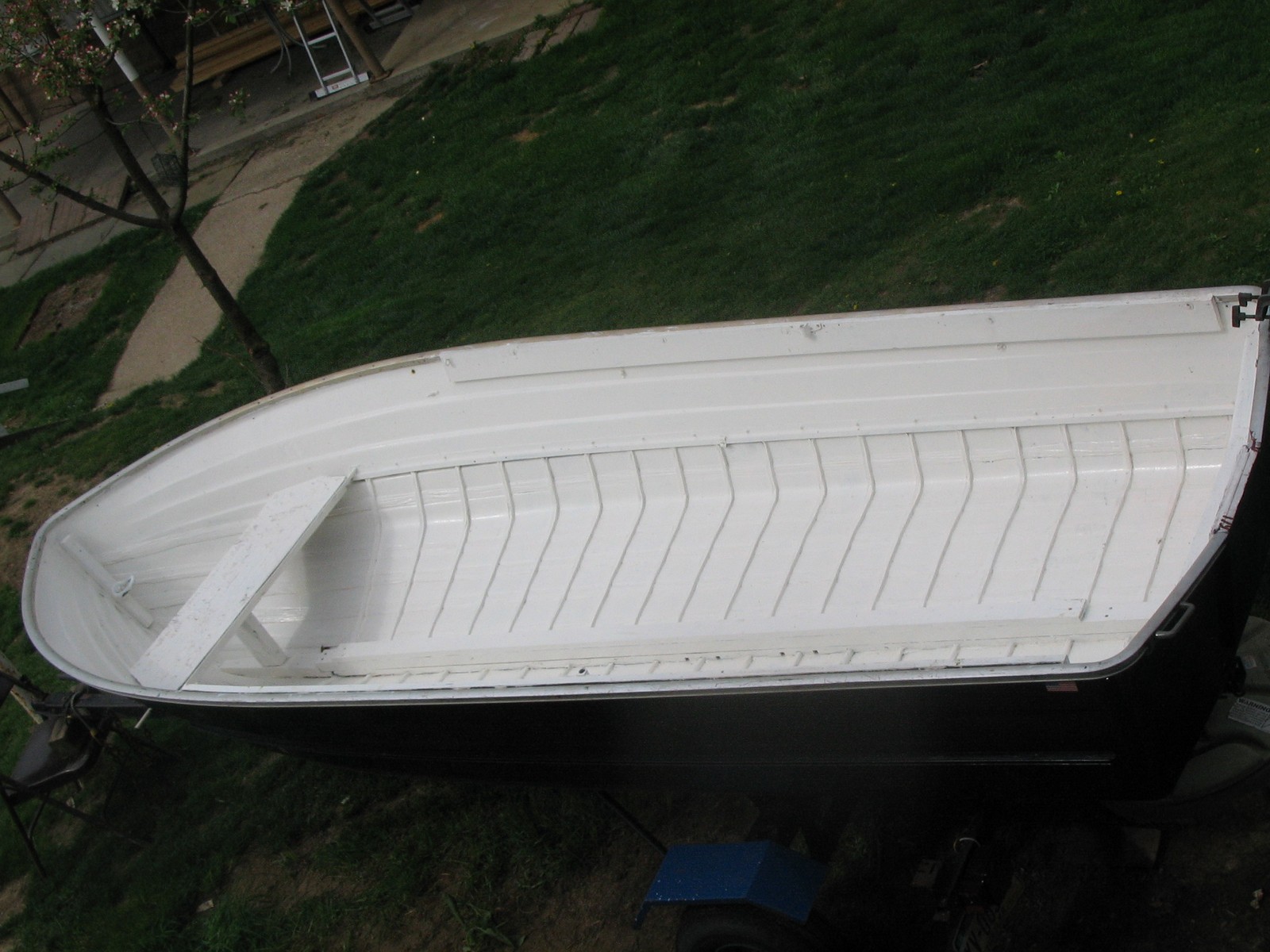

I have replaced part of the keel inside and used dried green 2x4 because of my limited budget. It is as comes from factory as it was. I seen a few but none were completely as from factory. My deck only has two lag bolts to hold it in. Take them out and two people can lift the whole deck and seats out in one piece. I do it every year. I don't loose much down there because mine fits very tight. I was careful in my measurements. Each side was measured every two inches from a centerline and transferred to the plywood. It was all undercoated and sealed before three coats of good waterproof paint.My boat sits undercover and seldom gets wet inside so I hope it never rots again. Some of these pics was before the present carpet was put in. Some of these pics were turned upside down because the boat was turned over. The white barrels in the boat were holding it up.
