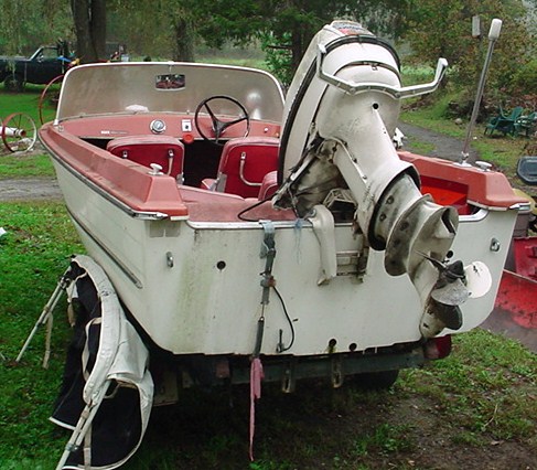

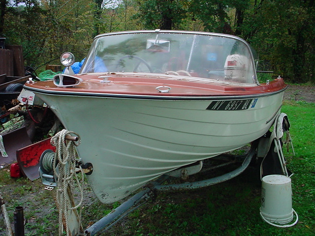

Hi Guys, I am new here, I was put onto this site from from the guys at Iboats. I am new To the Boating Sport & just aquired this 1964 MFG Niagara Custom with a 40 HP Johnson Super seahorse RDS22 engine, it sits on a 1961 Gator Boat Trailer. I got this Boat from a Friend who moved to arrizona and just had no more use for it.
I Hope to work on it this winter and get it back in order for spring of 2012. It's been sitting since 1998 but was allways maintained up til then and is in decent shape, i think. Anyway, My Knowledge of these boats & engines is ZERO and so would greatly welcome any input at all. thanks, DanO'

also, you have my "very favorite" OB motor. = the 1950s to mid-60s Big Twins are GREAT OB motors, that like the "energizer bunny" just go & go & go, with minimal care/feeding.
(the only ones that need to be "babied" just a bit are the 1960 & 1961 versions & those work fine as long as they are NOT "hotrodded".)
CONGRADS, satx

BTW, is the Orange / White color scheme more rare than the Blue & White? just wondering because Every one i find on line seams to be Blue & White.

I stand corrected,after reading the info in the library it clearly states that the stringers are all glass,sooo your only concern would be the transom.If you read that lit it does mention the transom being wood encapsulated by glass.It also looks like all the pics are blue or red and white.What part of your boat is orange,all I see is faded red.

Regarding the color, Yes, faded Red / Orange maroonish color...Those pics in the brochure are the Only ones I've seen that color.

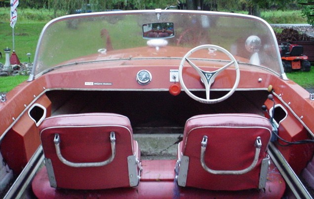

Those seats are a rare find, not many survived the years, they were called Sun 'n Fun seats.
I've been on the look out for MFG boats ever since I bought my first one years ago. When it comes to Niagara hulls, red is the rarer of the two colors as most that I've seen have been blue. Out of about 8 Niagara models I've owned, only one was red, and that one had a huge Oak tree across the top when I found it. I parted it out about three years ago.

You guys have undoubtedly removed any doubt in my mind about Keeping or selling This Boat. I am MOST DEFINITELY keeping it. However, I will be taking out the "Sun & Fun" Seats which are all complete but in poor shape & in need of Rerstoration, so if anyone is interested in them , just contact me.

I have been looking for the pieice the front seats are bolted to, So I'd be interested in buying your seats.
