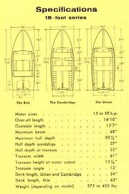

Here is the info I have about other models and their floorplans
Good luck and have fun, they are pretty simple structures. I had to replace the full length inside keel on mine, and the old plywood floorboards.
Identifying old MFG and restoring 3 years 2 months ago #148380
Thank you. Your spec sheet definite helps!
