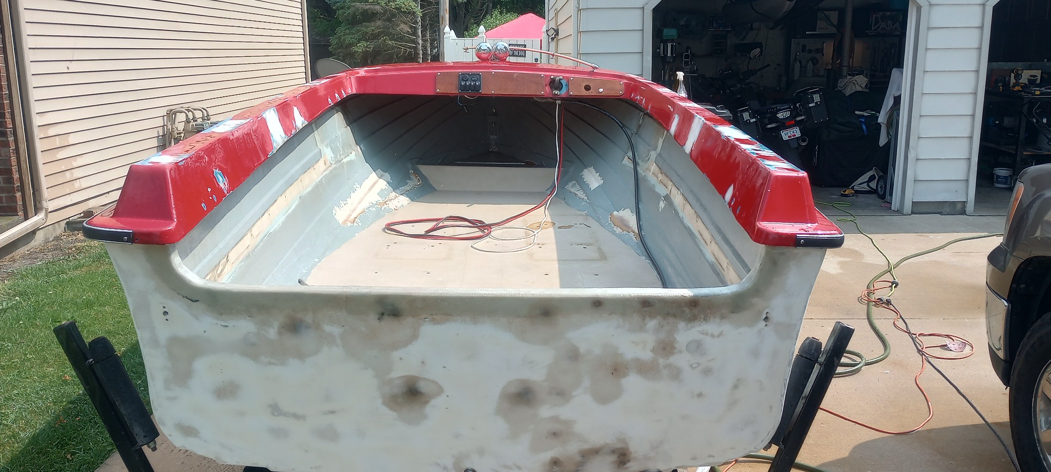

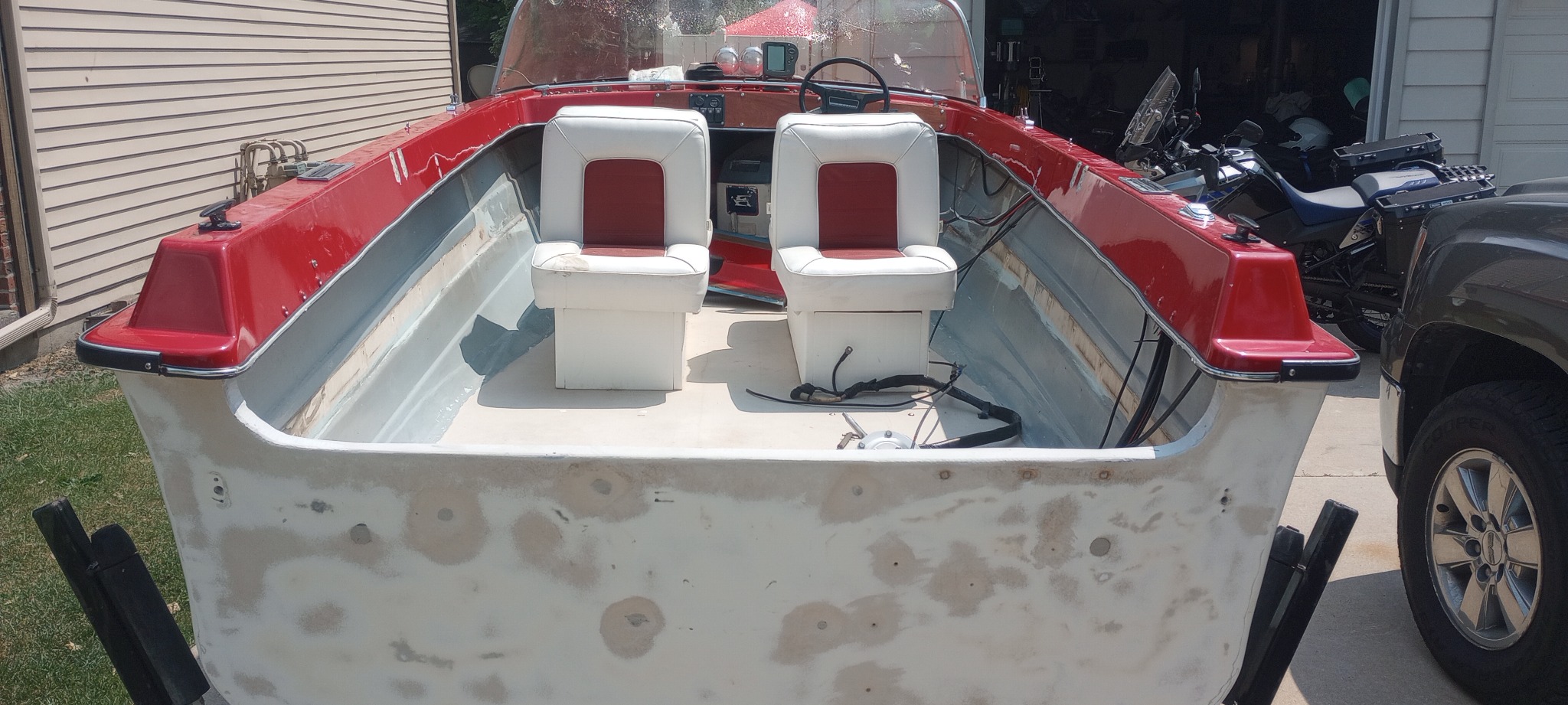

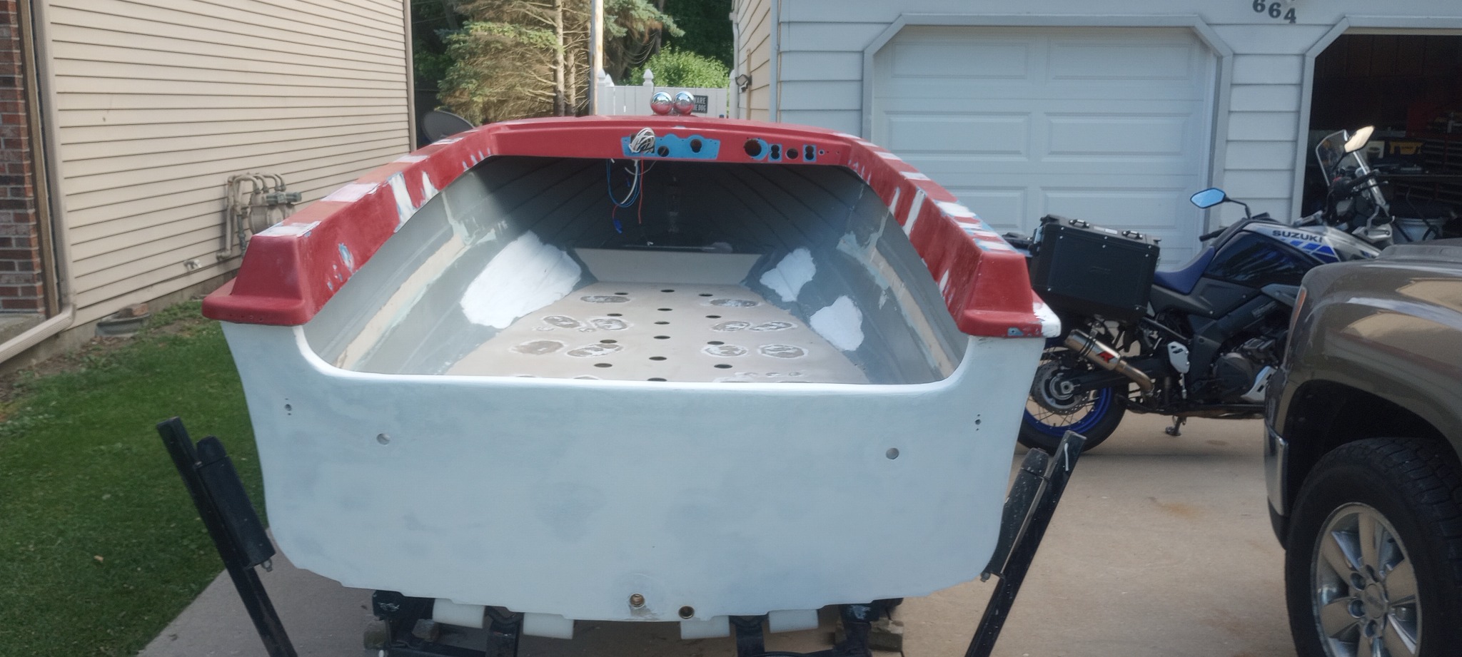

New westie. Lots of work to do. Started with pouring a new transom, then a foamectomy, filling 20 holes in deck from Sears over the years,glassing over the whole deck now. Still need a source for a new windshield. Mine is severely scuffed, brittle, and cracked 95% up the middle.

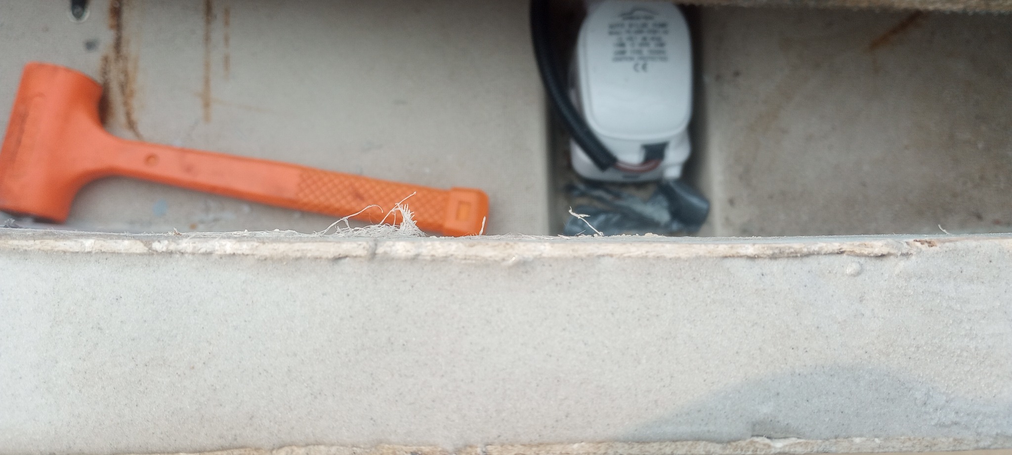

New MFG Westfield 65' 3 years 3 months ago #148128

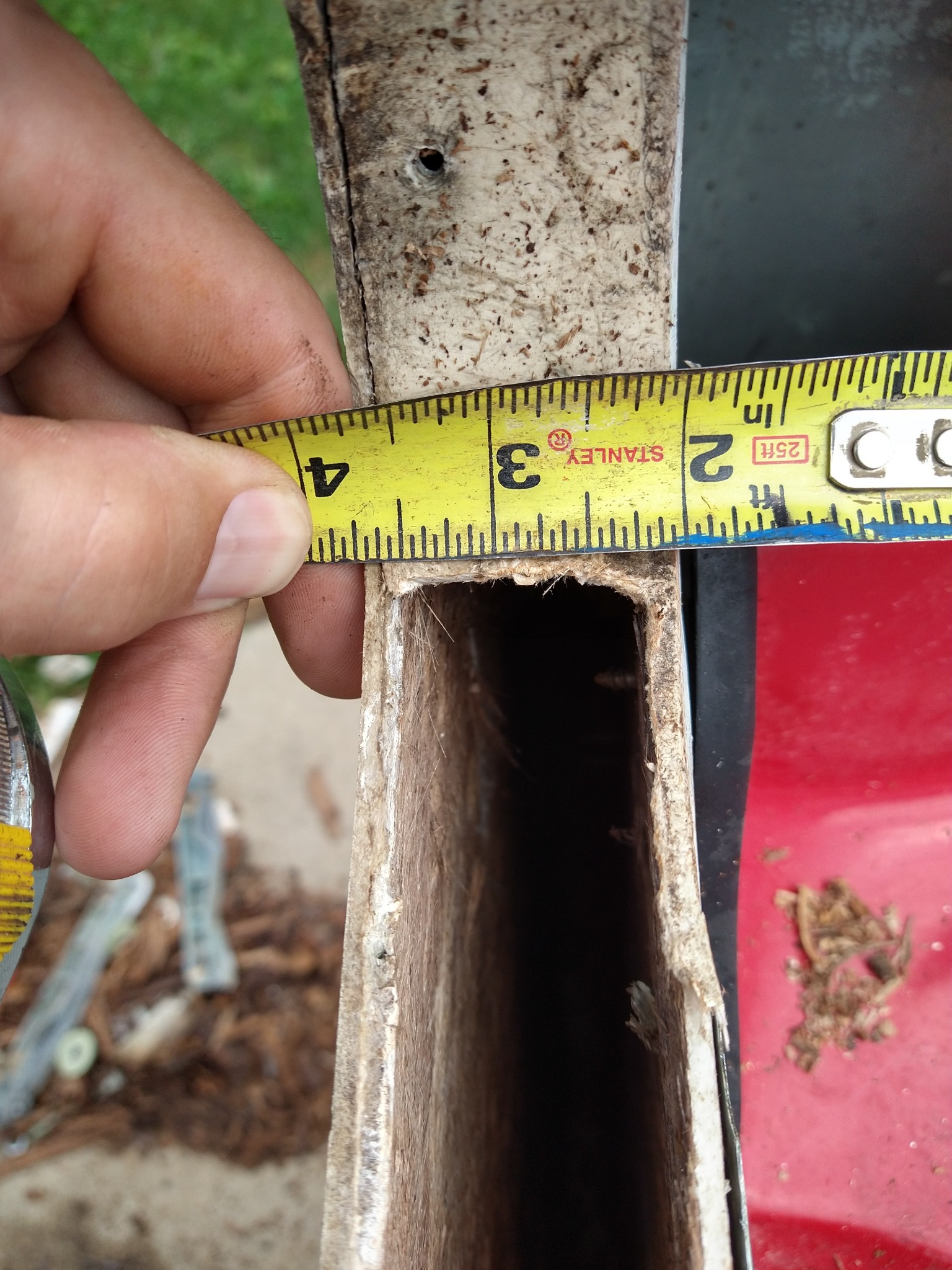

Not really any good pictures. I unscrewed the metal top cap of transom. Cut fiberglass cap off. Used a chainsaw very careful to get most of the wood out. Then used an assortment of steel brushes on drill extension. Used 2 PCs of gorilla tape on holes less than 3/8", for larger holes up to 1 1/2" I crossed crossed 2 PCs tape, followed by cardboard taped over it. All holes even from #6 screws need to be covered. Used a drill paddle slowly to mix the Arjay 6011 and poured till level with transom. I let it set up for 15-20 mins, gorilla taped the high sides and used a cement piping bag to fill those high sides up to top. Glassed up top cap with 2 layers of 1708 polyester resin. Then gelcoat.
In hindsight, it was a lot of work to do the liquid transom. I would probably just cut back skin off and use marine plywood, then reglass the back. It lasted for almost 60 yrs that way before.

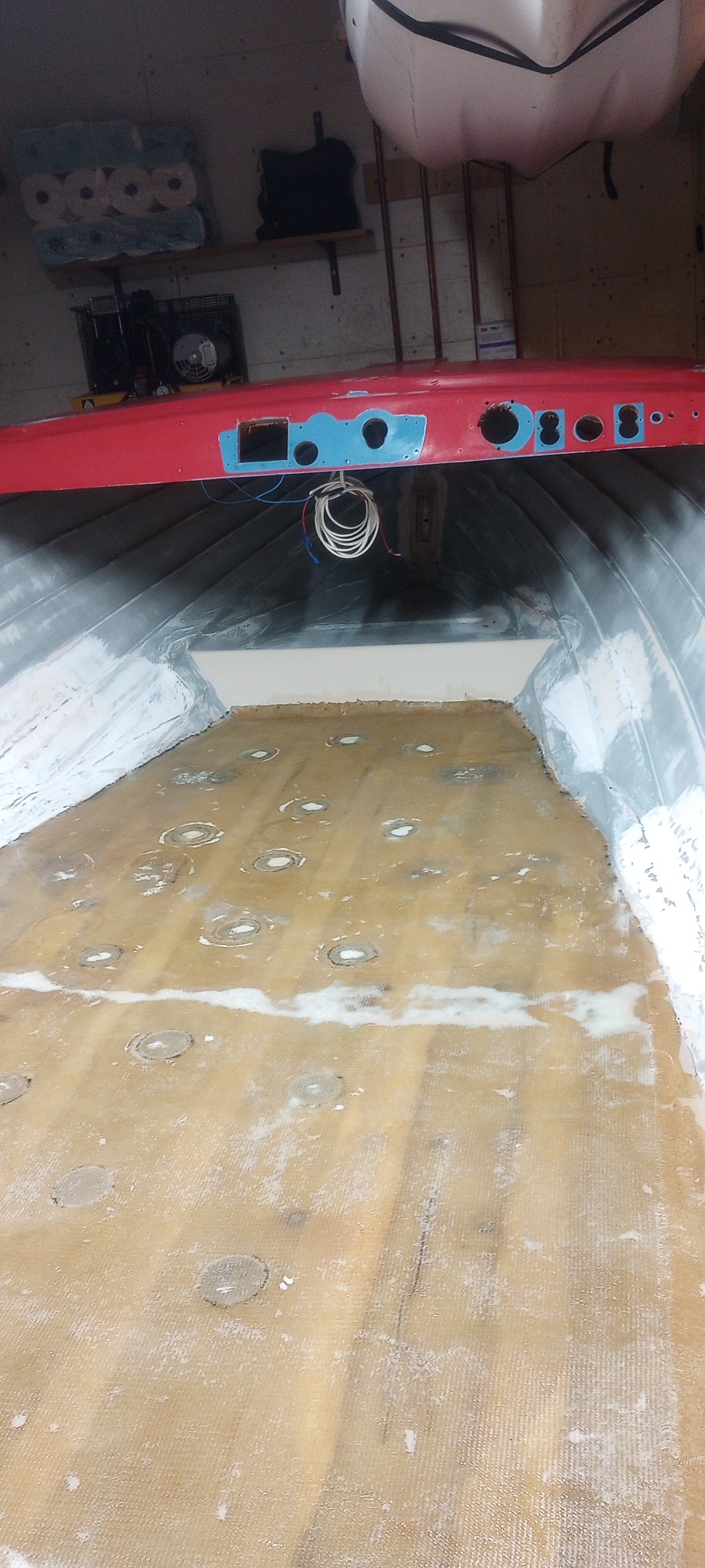

New MFG Westfield 65' 3 years 1 month ago #148407

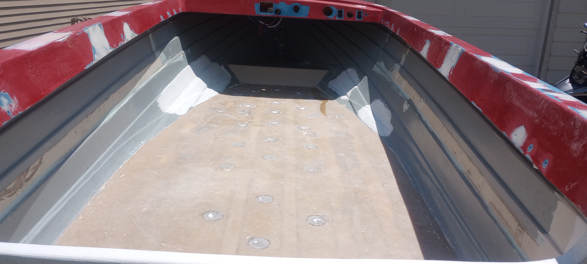

All holes and cracks patched, floor is glassed over with 2 layers of 1708 to stiffen up, need to fix that white line. Anyone have a source for windshield? Thanks
New MFG Westfield 65' 3 years 1 week ago #148502

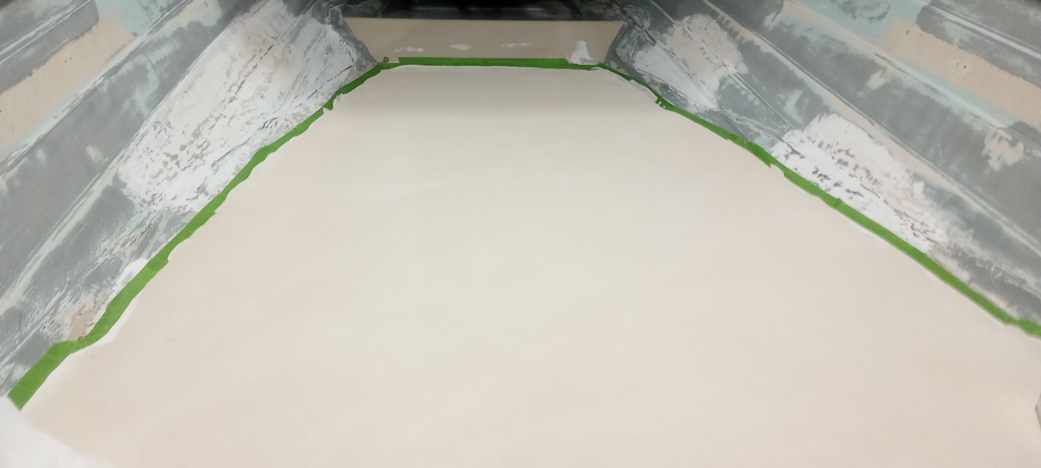

Slowly but surely. Using softsand rubber particles for anti slip floor. Using gelcoat and broadcast method. So far so good, need to add final top coat and floor will be finished. Also replaced wooden bow eye backing with a composite one. Still in search of a windshield for this old girl. Thanks
