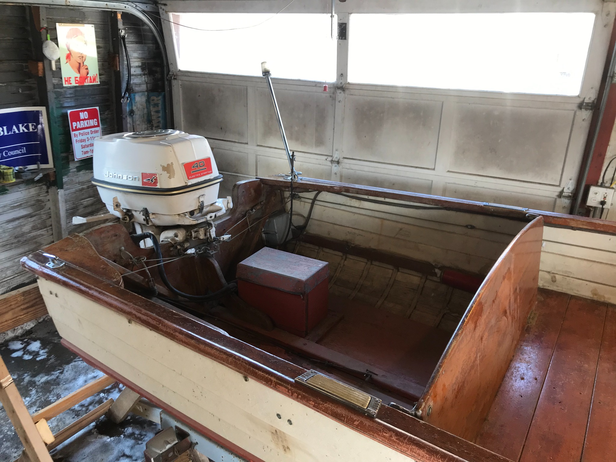

Hello all,
I recently purchased an MFG Cambridge - 1957 (I think it is a Cambridge). The previous owner had the boat in a temporary shelter which leaked, the mahogany deck will need to be replaced. Any tips/tricks or things not to do in this endeavor? I have fully restored a sailboat - I confess I am a sailor, but have always loved vintage runabouts. I am not afraid of the work and have skilled carpenters that I work with that can assist though they are not boat builders.
I also have another question concerning the ribs. They look like fiberglass cord? Does that sound right? I just got the boat home from Michigan and will be taking it down to my warehouse so that I can dis-assemble and check/repair the keelson, the thru-hull attachments etc. I will be attaching photos soon. Thanks to all.

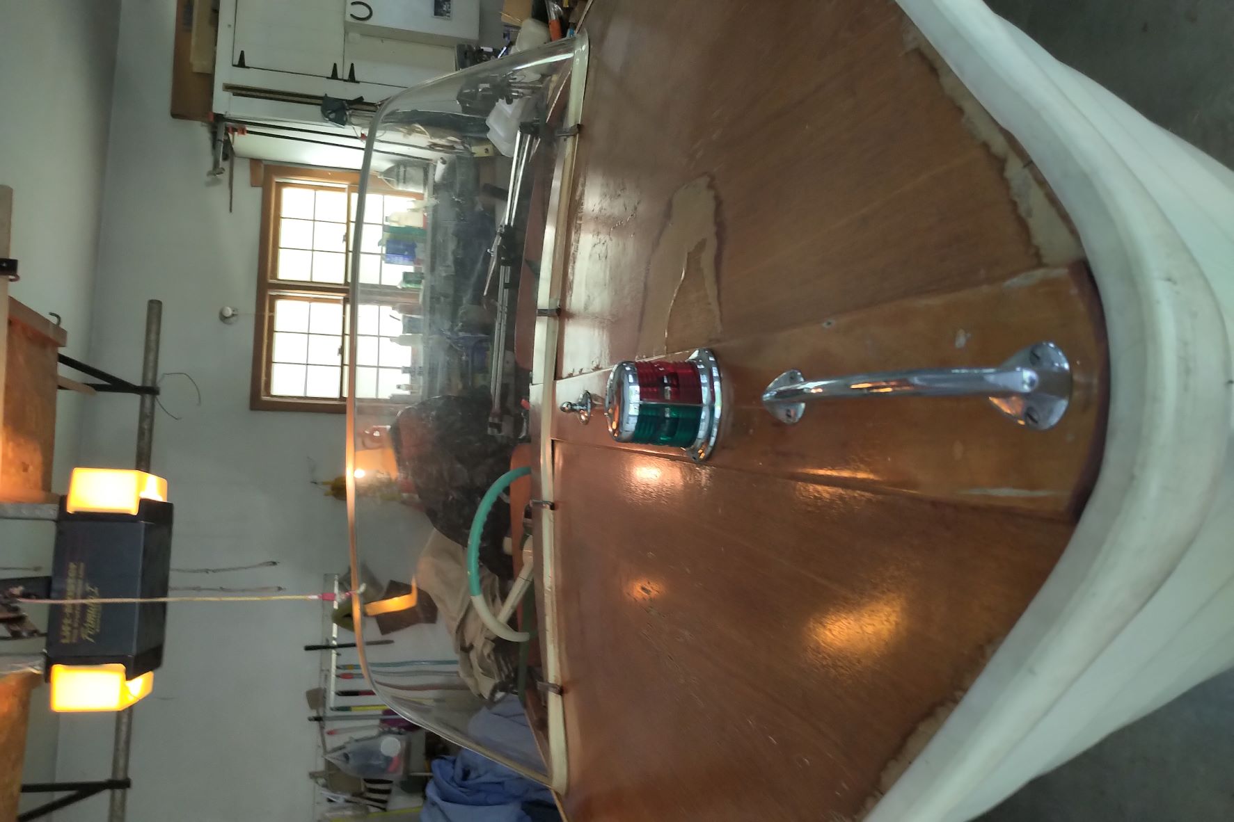

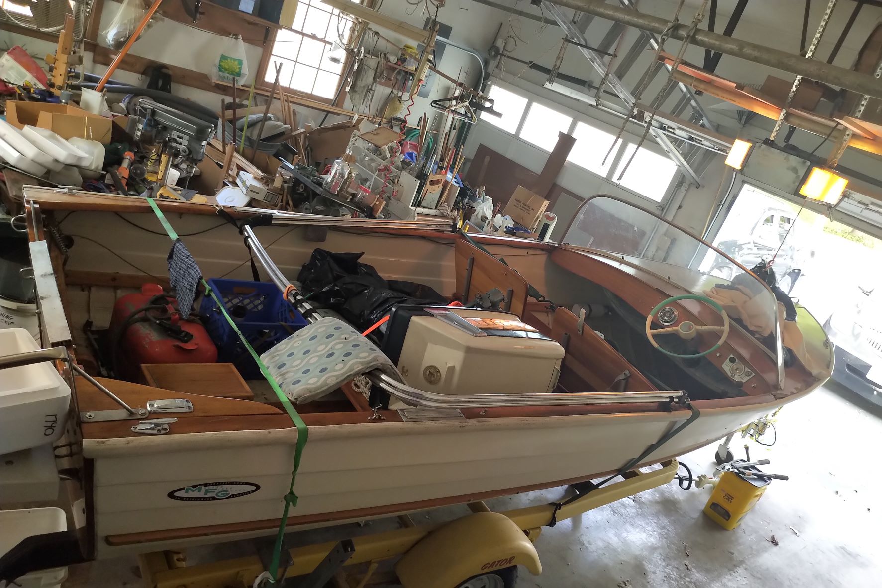

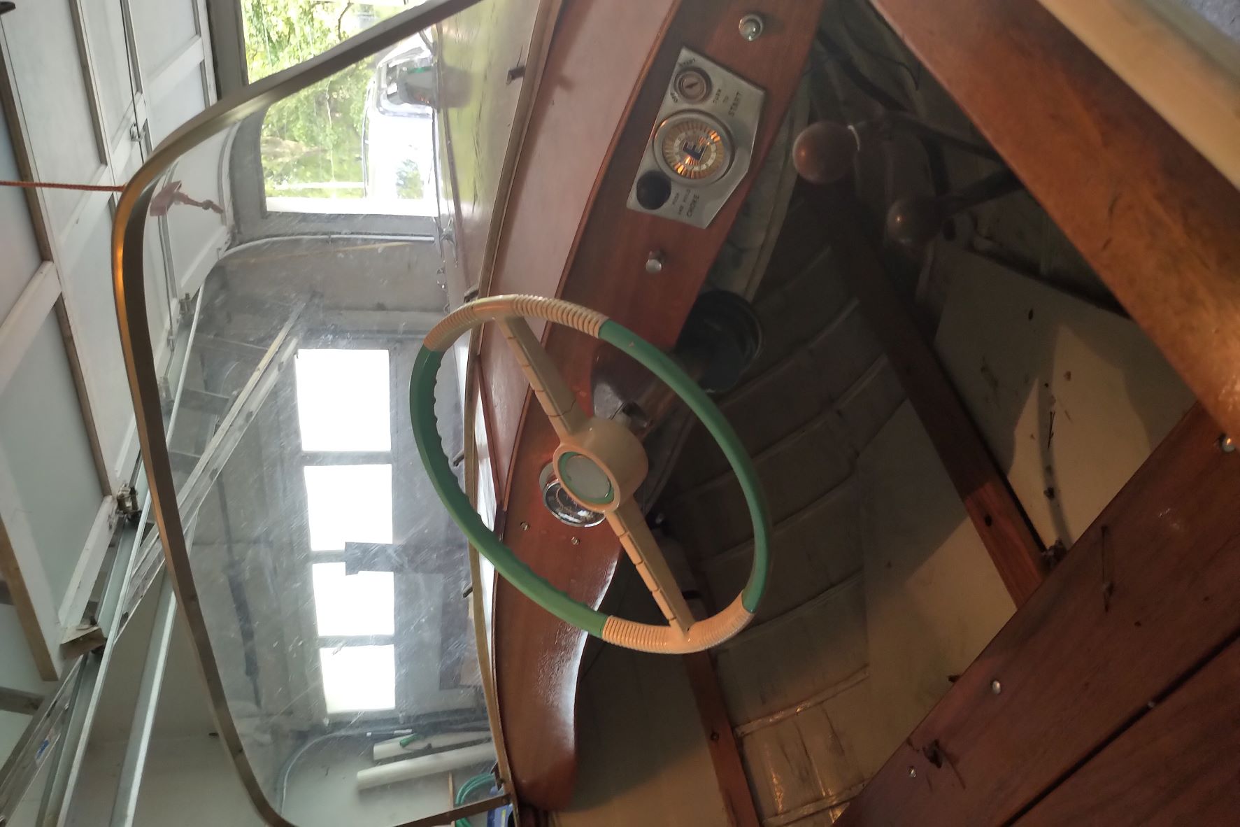

Well thank you so kindly! I took the photos at high resolution so they are too big to upload here. I will downsize them and upload to this site. At first I saw the ribs and thought "gee, why did they paint over rotted wood?" As the appearance is not of nice sanded and finished wood. Then I saw where the ribs terminated and saw some fiberous cord at the unfinished edges and realized it was most likely fiberglass. I have much to learn, though this won't be as complicated as the sailboat I restored, just different. I am so excited to have this boat and I stand corrected, it is a 1956 and the motor is vintage as well.
New MFG Cambridge owner, I have questions 5 years 3 weeks ago #145530

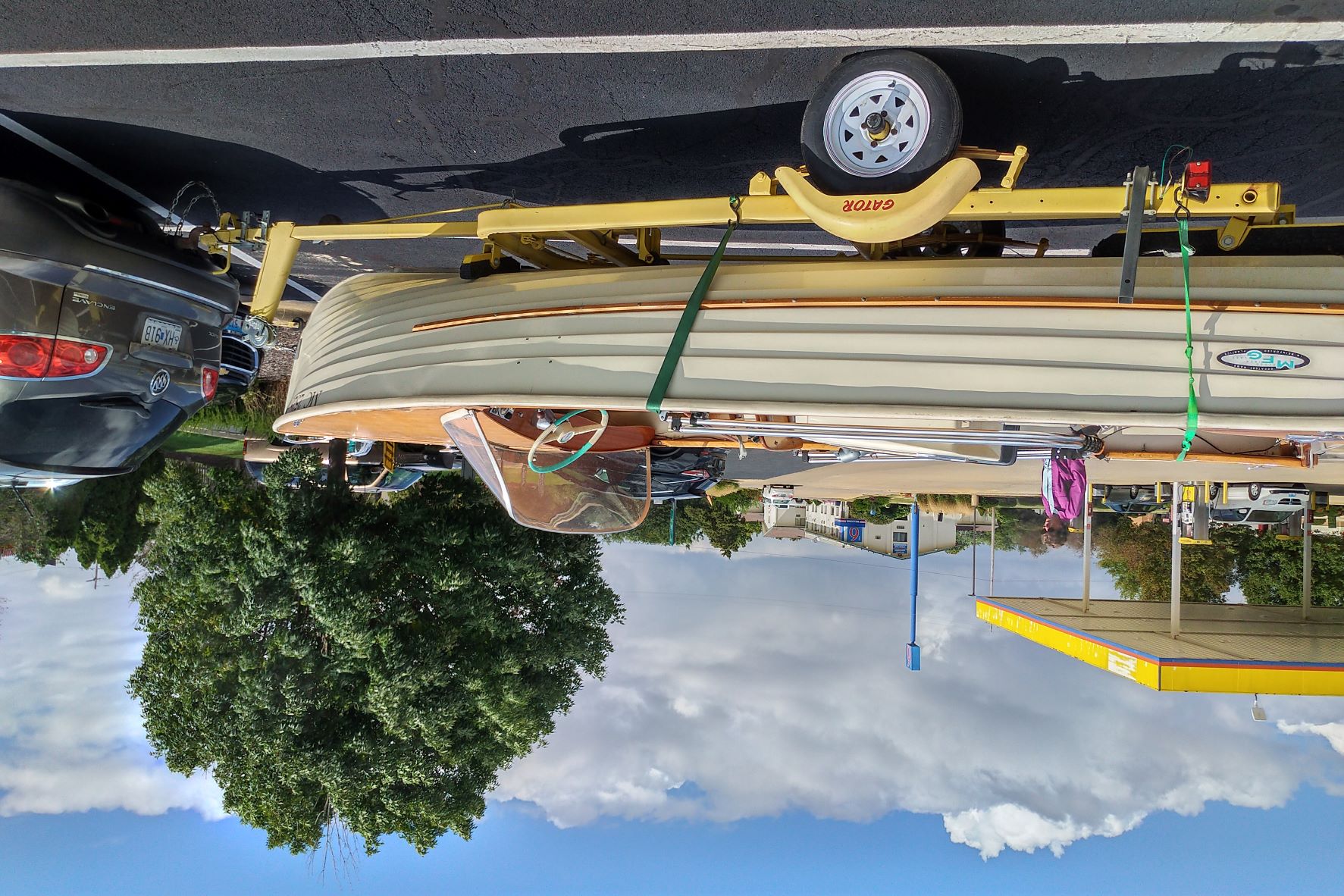

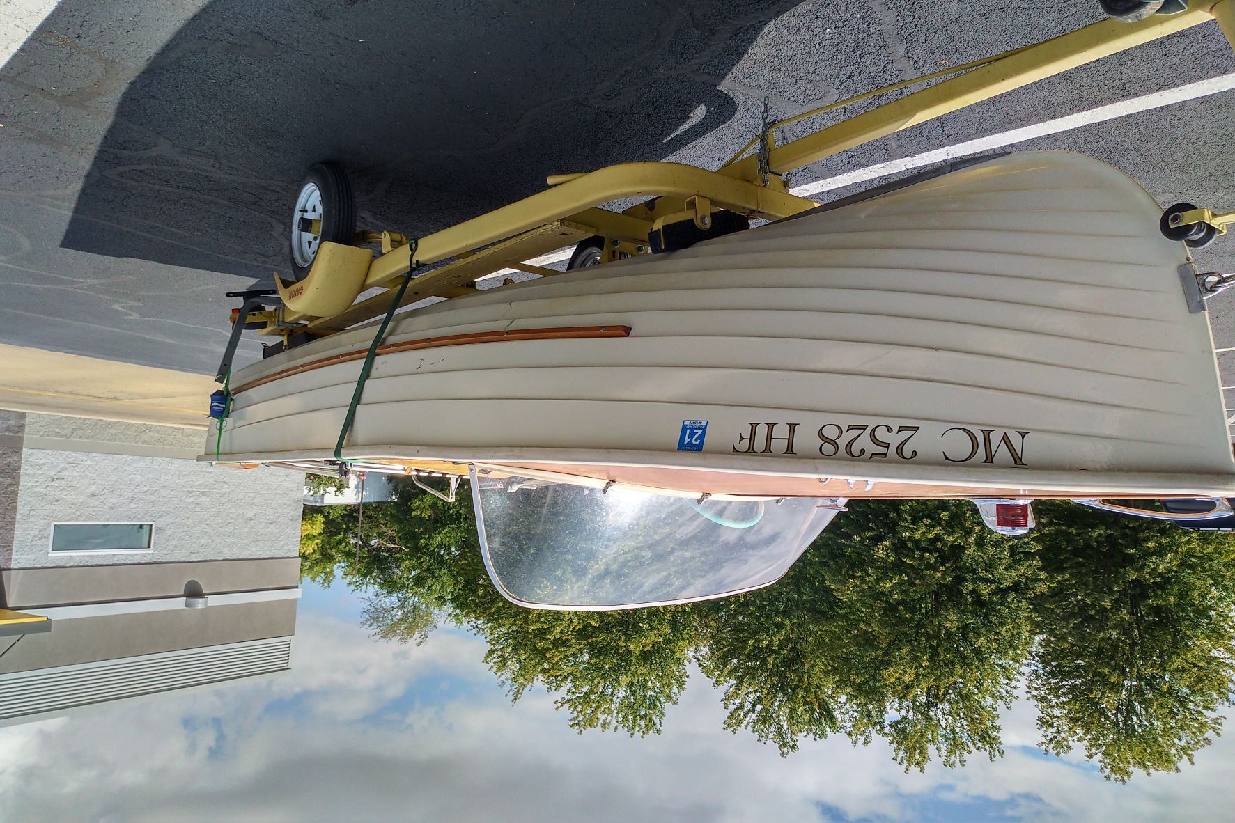

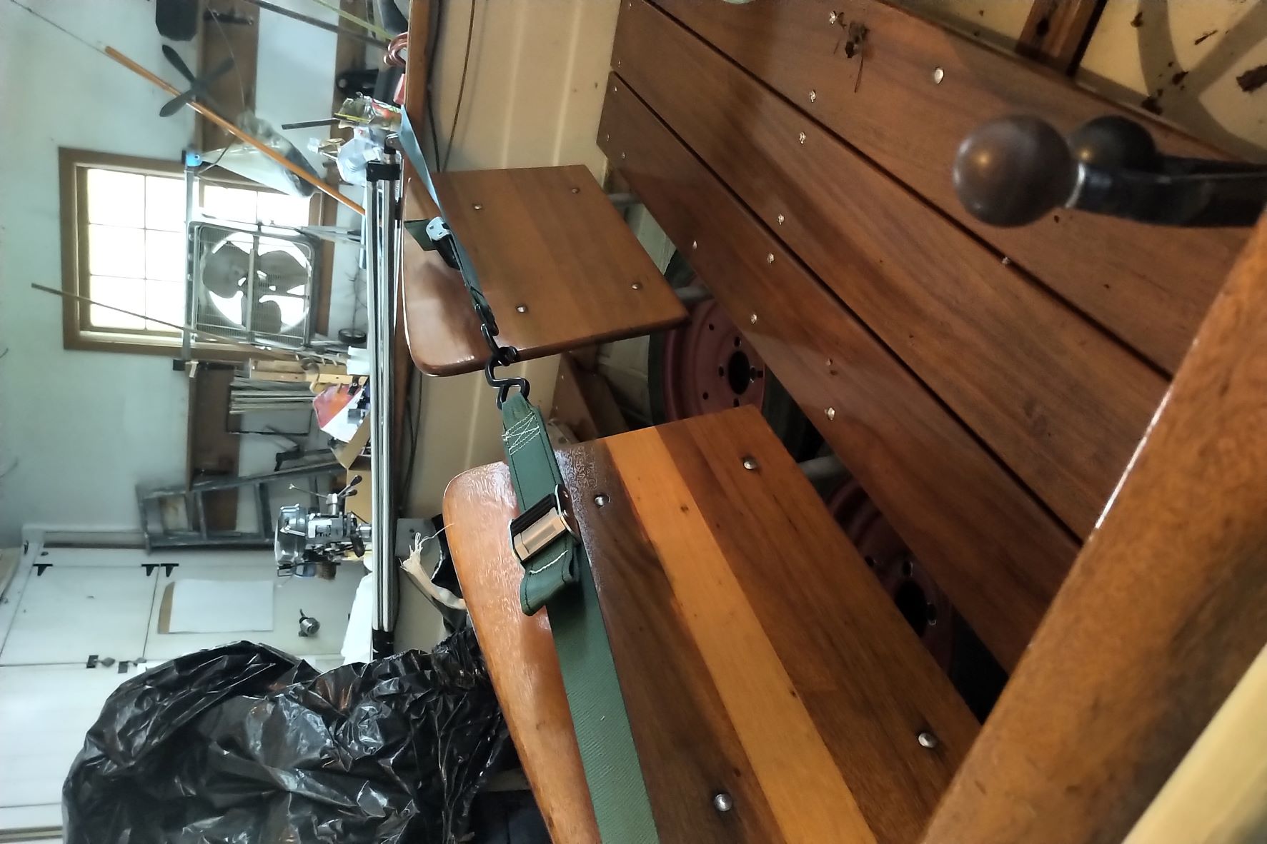

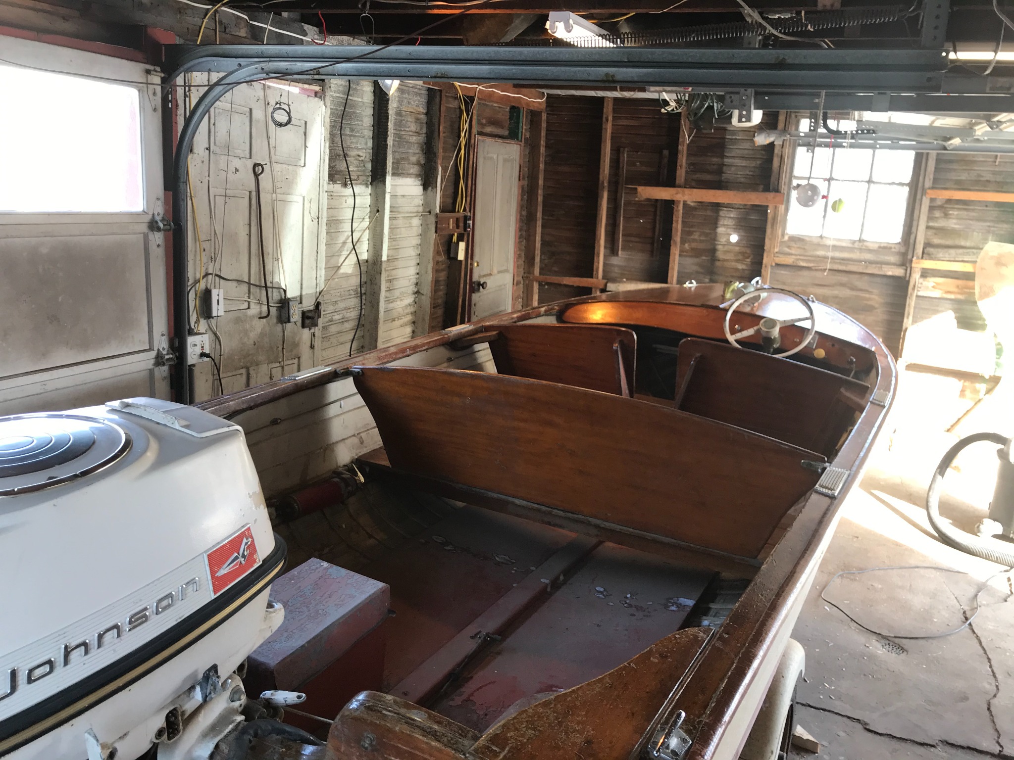

Ok I just tried to upload smaller versions of the photos of my MFG. Why are all the photos coming in upside down? I posted to the moderator and the photos showed upside down but once they landed on the page, they were correct.
Ok so here are photos of my recent purchase, a Cambridge, correct?

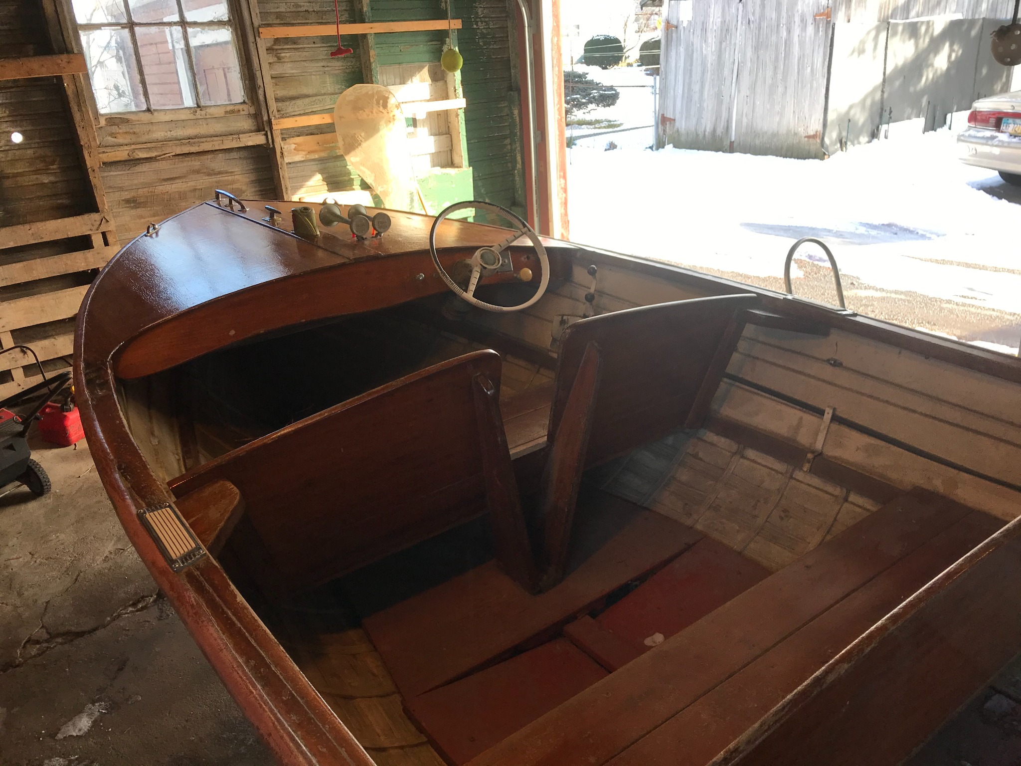

New MFG Cambridge owner, I have questions 5 years 3 weeks ago #145536
Hi, I have a 57 Cambridge that I replaced most of the wood on several years ago. I would be happy to share photos or answer any questions that I have experience with.

New MFG Cambridge owner, I have questions 5 years 2 weeks ago #145541
I have a Question Princess ?
The wood splash rail.... Is it all wood ? or it inlayed on an aluminum strip ?
I have aluminum strips with no wood. I'm guessing my MFG is a 59 ?
BTW... on you your simplex outboard controls, if you don't like the dull black and red knobs ?
Mc Master Carr has some shiny ones pretty cheap
www.mcmaster.com/knobs/threaded-hole-ball-knobs-6/
Really pretty boat by the way !

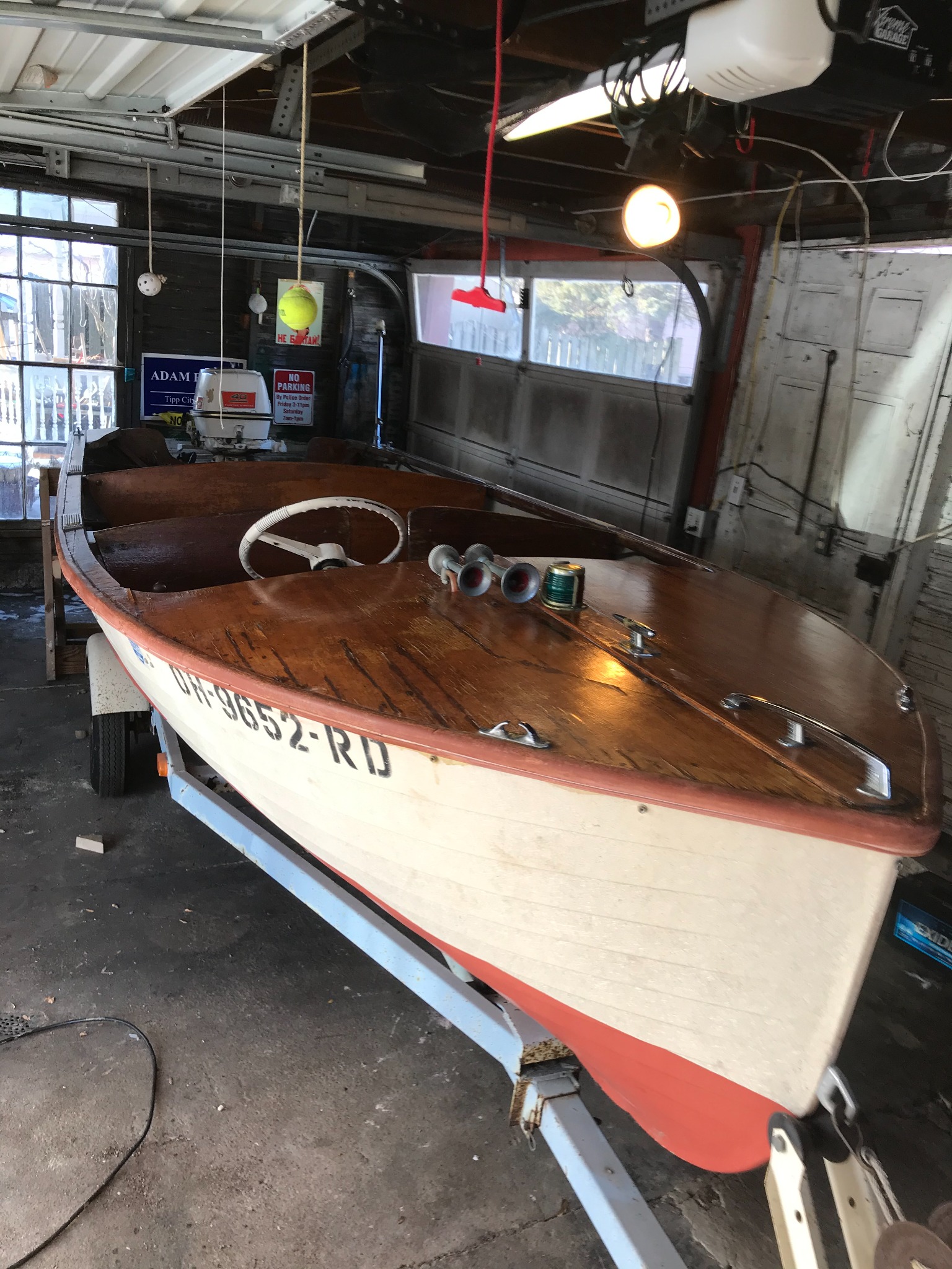

Here is a link to some photos that I took during restoration and some photos that I took of another boat
photos.app.goo.gl/Y95wfcAsMF23VS4Y7
photos.app.goo.gl/PAK8wytZdWZwseMi9
If you can't download let me know. I also have some notes that I made. Somewhat cryptic but possibly helpful that I could send
New MFG Cambridge owner, I have questions 5 years 2 weeks ago #145546
Hi Pirate, I just looked at the photos of your boat. It looks like my boat after restoration! I don't think you will need anything that I sent but might be fun to look at.

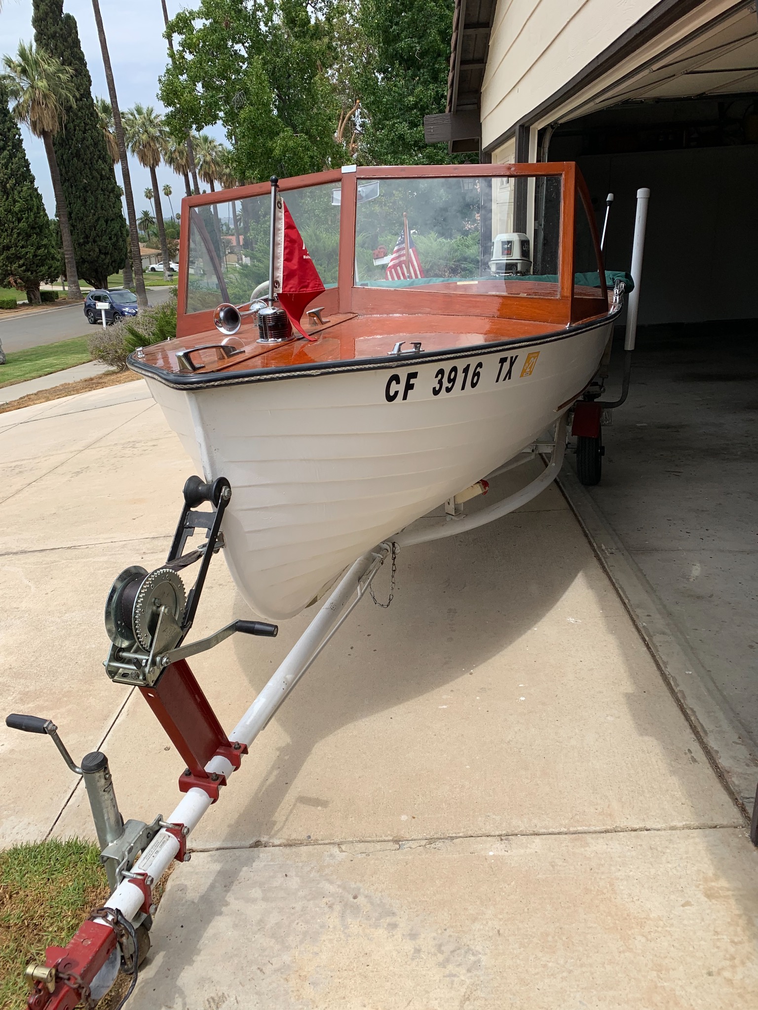

New MFG Cambridge owner, I have questions 4 years 11 months ago #145720
Welcome to MFG Cambridge ownership. Like you, I also have a sailboat and love to sail off the Southern California coast. My Cambridge is strictly a Newport Beach bay cruiser but the reception I get from other boaters is fantastic. Getting a “thumbs up” from a million dollar yacht owners is quite satisfying.
My boat was a mess, But with lots of sanding and patients, I was able to save the wood. Four coats of varnish and she will be a head turner. I see you have a Tee Née trailer and a period outboard. You have an absolute WINNER. BTW, the history of MGF is outstanding. The make the body panels for GM Corvettes. So I named my Cambridge “SeaVette”.

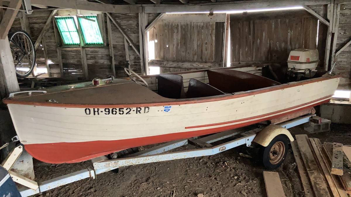

Congrats on the "new" MFG. I have the same boat. I purchased from the family who bought it, it was stored in a barn for 10 years after the last use. Once I got the 1960 Johnson engine running I had it out about 10 times this summer. What a great boat. Just can't take it out in the wind or you will definitely get soaked. Can't wait to see your photos.

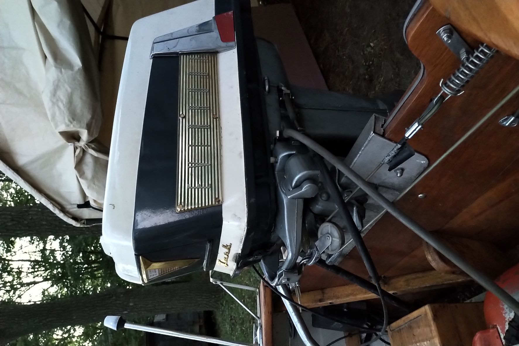

The other question I have is the 1957 Evinrude motor. When I transported the boat back to Kansas City from Michigan, I had the owner place the motor on the back seat so all of that weight wasn't riding on the transom. I had to use a forklift to hoist the motor up out of the boat and onto a stand. The 35 HP seems a bit overkill for the length of the boat. I am interested to know what HP you all use and also what vintage. I did find a fun video where a guy had taken a modern motor and "vintagized" it by using an old motor cowling over the top of the current motor. He filled the gap between the 2 covers with foam. But still thinking about what to do. I cannot lift the old Evinrude onto the boat myself. Heck it is all I can do to get my 5 hp on my sailboat. I don't plan to water ski or go zooming all over but want enough power to move the boat nicely. Any thoughts or recommendations are most welcome. Thank you in advance guys!

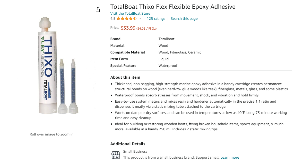

I saw a video where a restorer used thixoflex on seams of a Lyman boat to seal it. It may work for you ? But do some research to see if it suits your needs.
. Good luck on your restoration quest !
The following user(s) said Thank You: Pirate Princess
New MFG Cambridge owner, I have questions 2 years 8 months ago #148670
Thank you Chuck!
I did not realize that Lyman's planks were plywood. I will check out the Total Boat product. Something is telling me that I need to take apart the "sandwich" at the transom. I may need to strengthen and fill that joint first with fiberglass, but will need to be careful that the sandwich goes back together. Thanks so much!

As for your motor question ? I'm pretty sure one member on this site had a modern OB motor that he stripped the newer brand decals and badging. Then re-painted it vintage colors and put old style decals to give the illusion it is a vintage OB ?
I think he started with a Honda and re-decaled it into an Evinrude ? Jut a thought to get you thinking
New MFG Cambridge owner, I have questions 2 years 8 months ago #148681
That is an interesting idea. What I was thinking was more complicated. I will see how tired of the project I am once I get the hull and deck issues resolved. I have access to a gantry that I might be able to lift the boat a bit to access the keelson. Anyone else have ideas for hoisting the boat to get at the bottom - other than flipping it?
