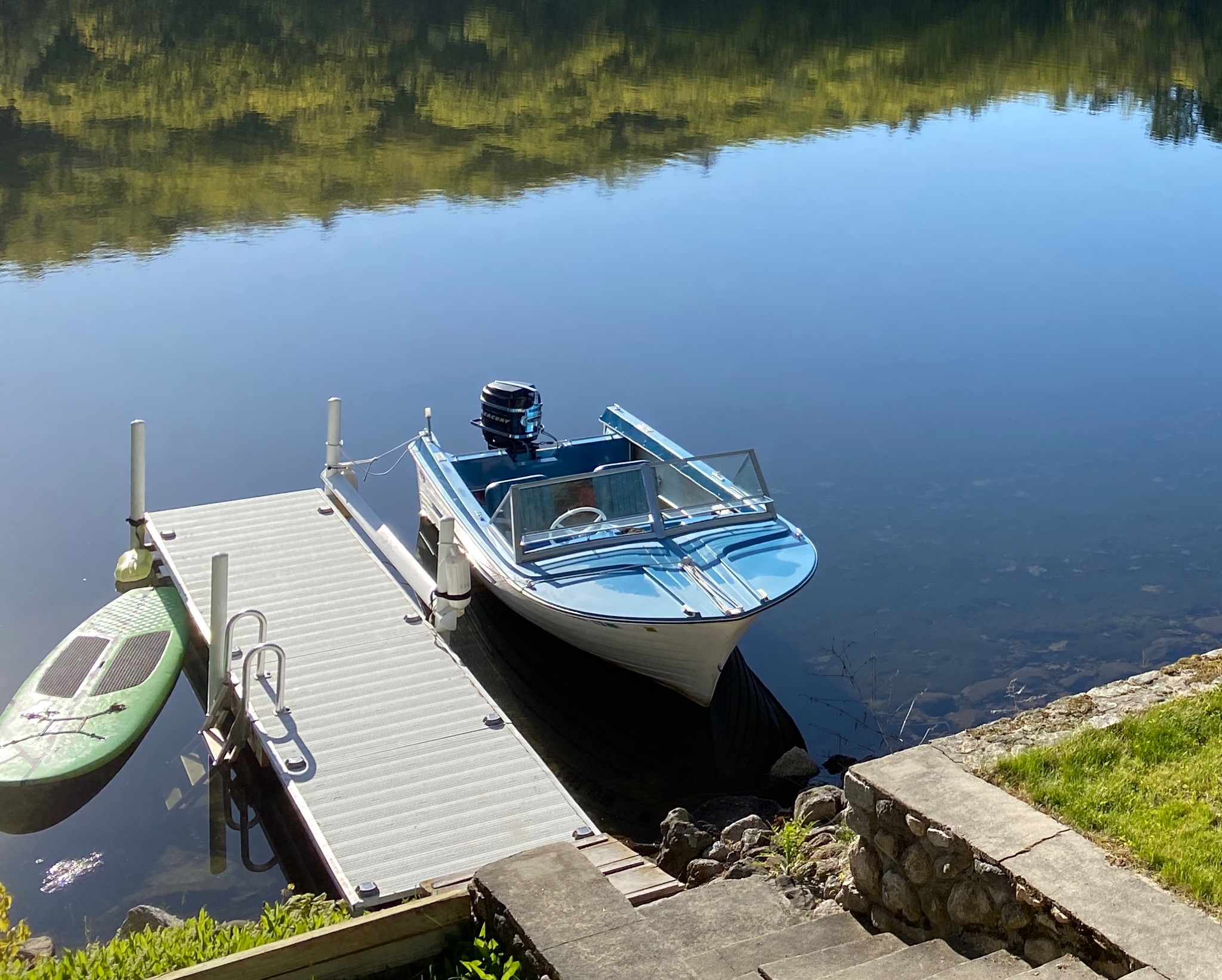

Aquired this sweet MFG Edinboro from a friend. We leave the boat sitting in the lake at our dock all summer and wonder if there is any cover that we could use while docked to protect from sun, rain and leaves etc.
It came with what I think is called a convertible top, as seen in the last pic, but didn't have any of the sides or back that maybe zip in.
This was also not that easy to put on and off. We usually just use it on the weekends and so want something to cover and protect it when we leave for the week.
Any ideas? We do have a cover that we use in the winter but that would be impossible to secure with the boat in the water.
Thanks.

Very nice MFG Edinboro. That looks like a 1965 model.
So really three options, and one is not good.
A premade cover will not fit right while docked, and is not a good option.
With a convertible top, you could buy side curtains(2) and an aft curtain, but the deck will site out in the sun and by the end of summer, be faded on that old gel coat. Also, the original canvas was OEM's from TaylorMade, and is no longer available. A canvas shop could make those three, but the white vinyl material is very tough to get.
Third option, this is the best, is to get a custom cover made at a boat canvas shop. WIll run $700-900. Mine for my 1962 Edinboro (Big Red) was $800 last summer.
