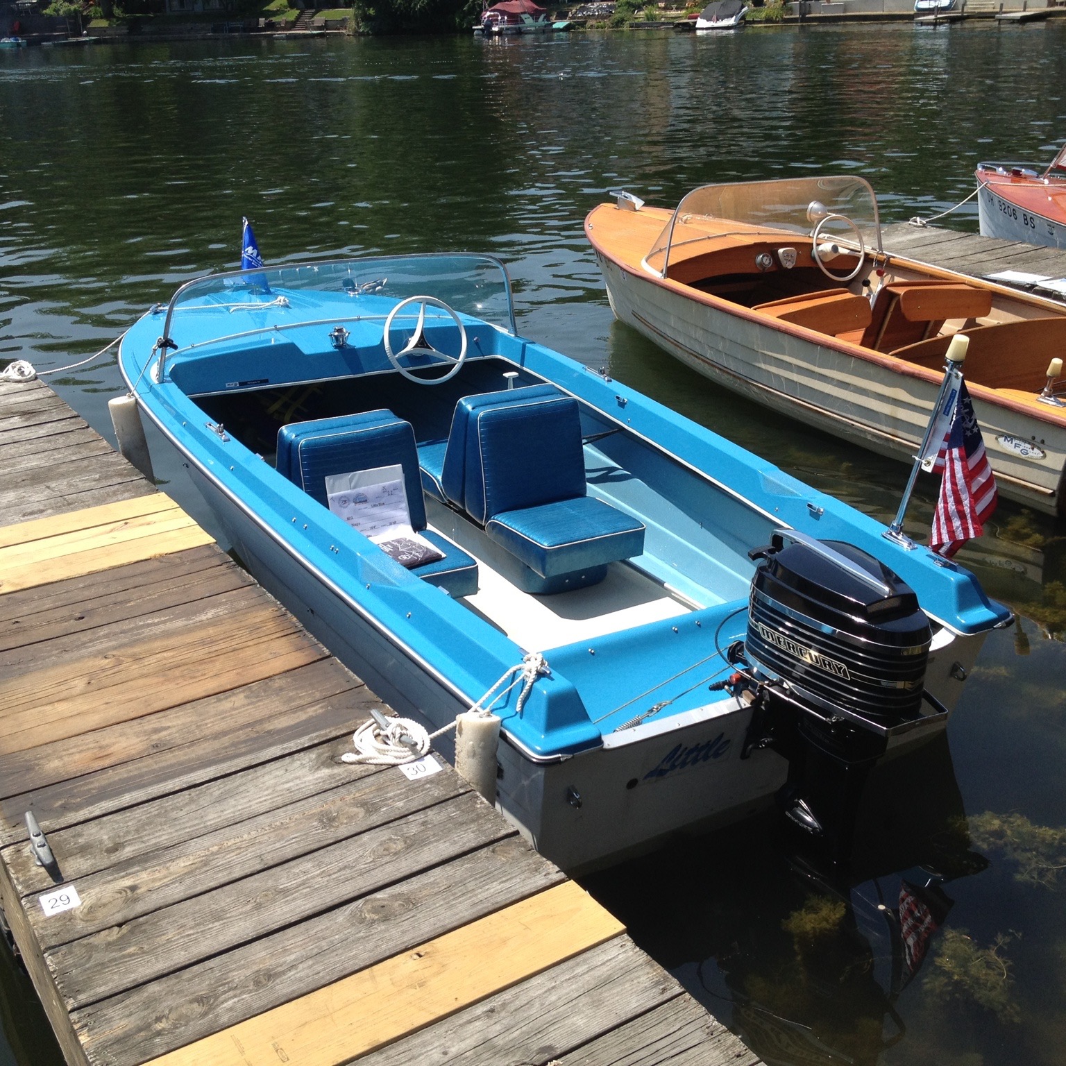

My Dad's first boat was a 1963 Westfield in red, just like yours - brings back the memories! He also had a 1960 Corry Carefree (aqua), 1966 Westfield (blue), and a 1965 Edinboro (green). Long story why so many.

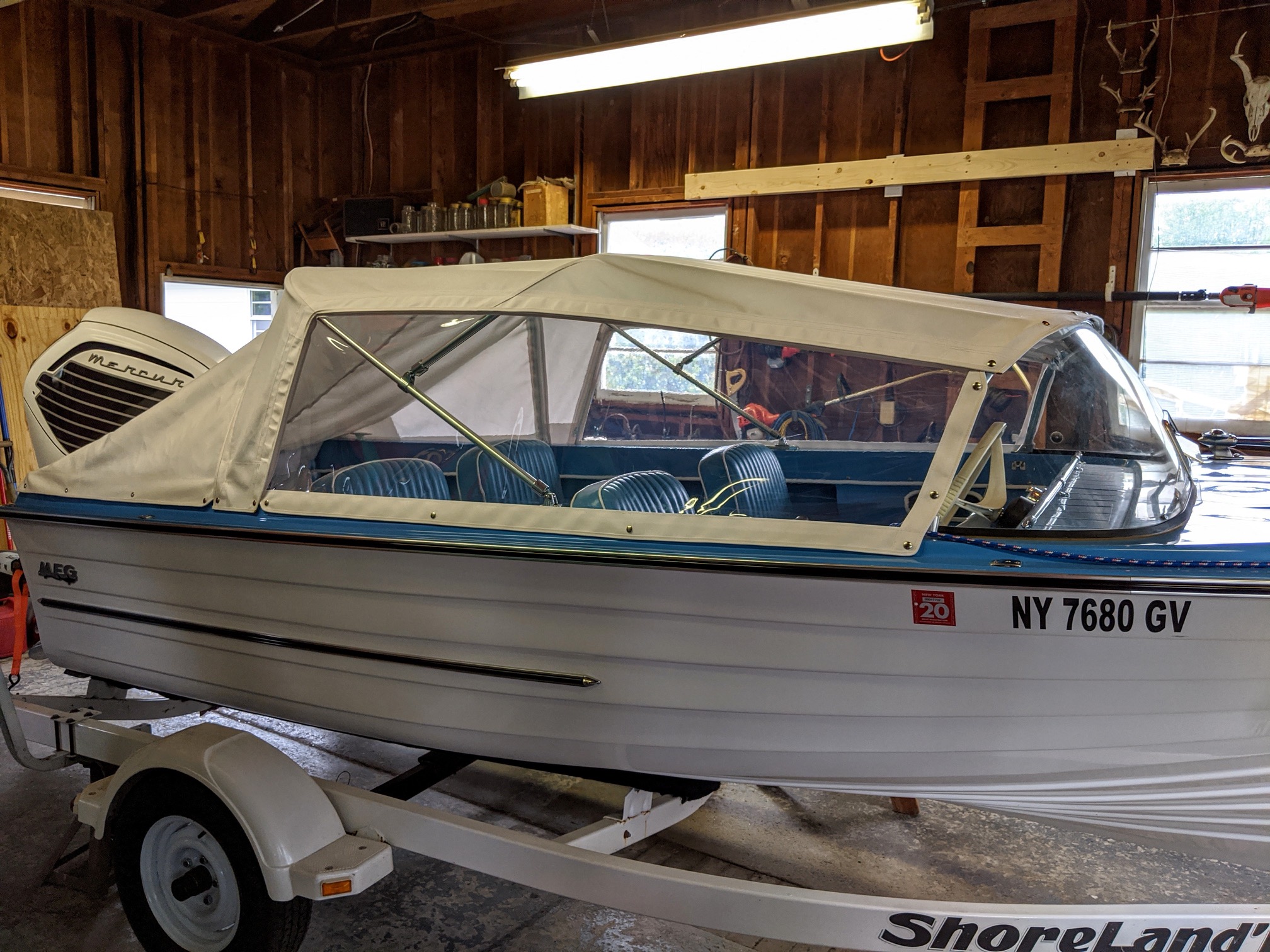

Canvas must be custom made. I suggest getting one made with the top raised like a bimini, but still a convertible top that attaches to the top of the windshield. Just had one made for my 1962 Edinboro (red) and will post a picture in a day or two.
White rub rail is no longer available, but black is. I went with the black for my Edinboro restoration.
The seats use well nuts that are available from West Marine and other sources. Had to replace them on the Edinboro.
I've included pictures of the Edinboro plus my original and unrestored 1966 Niagara. The latter was at the Keuka Lake Antique and Classic Boat Show two weeks ago. The seat upholstery is original in both, as is yours in your Westfield.

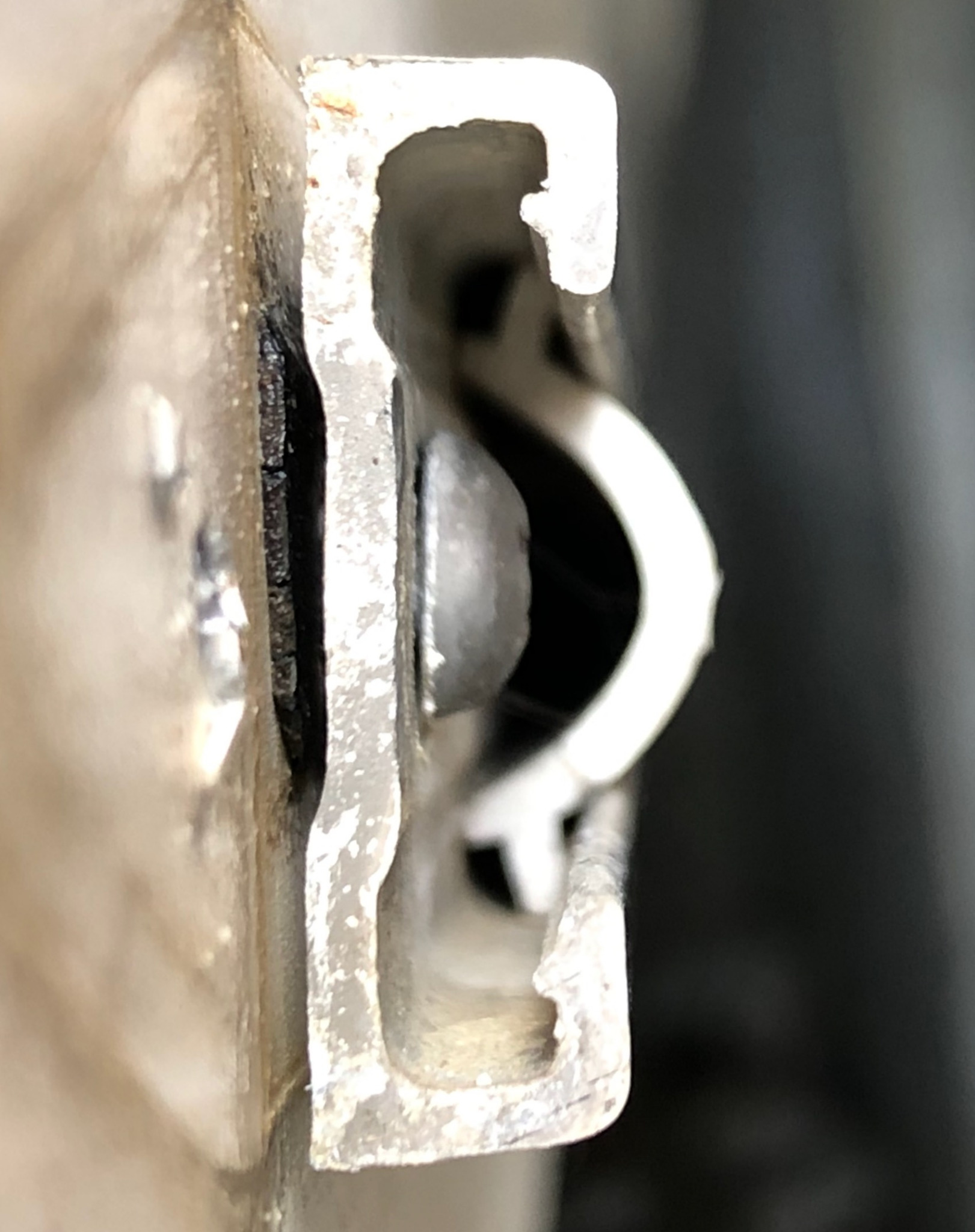

My boat actually has two sizes of rub rail, but that insert might work for both. It looks like a pretty good fit for the gunnels. I also have rails on the sides of the hull but that extrusion is about 1/8" taller inside and out, with about 1" interior dimension (vs about 3/4" for the gunnell), and a slightly narrow gap. The lower inserts are in pretty good shape but a little shrunken and probably stiff. I need to get them out anyway to replace the through bolts that hold the storage shelf inside the hull--they've all broken and the shelf is dangling! So I guess I would go with black on the gunnels and keep the white down below, assuming I can get them out and back in again without damage.

My 1962 Edinboro has a wood spray rail painted white. 1963 was the first year for the extruded aluminum/vinyl insert-type spray rail, which was really just for decoration.

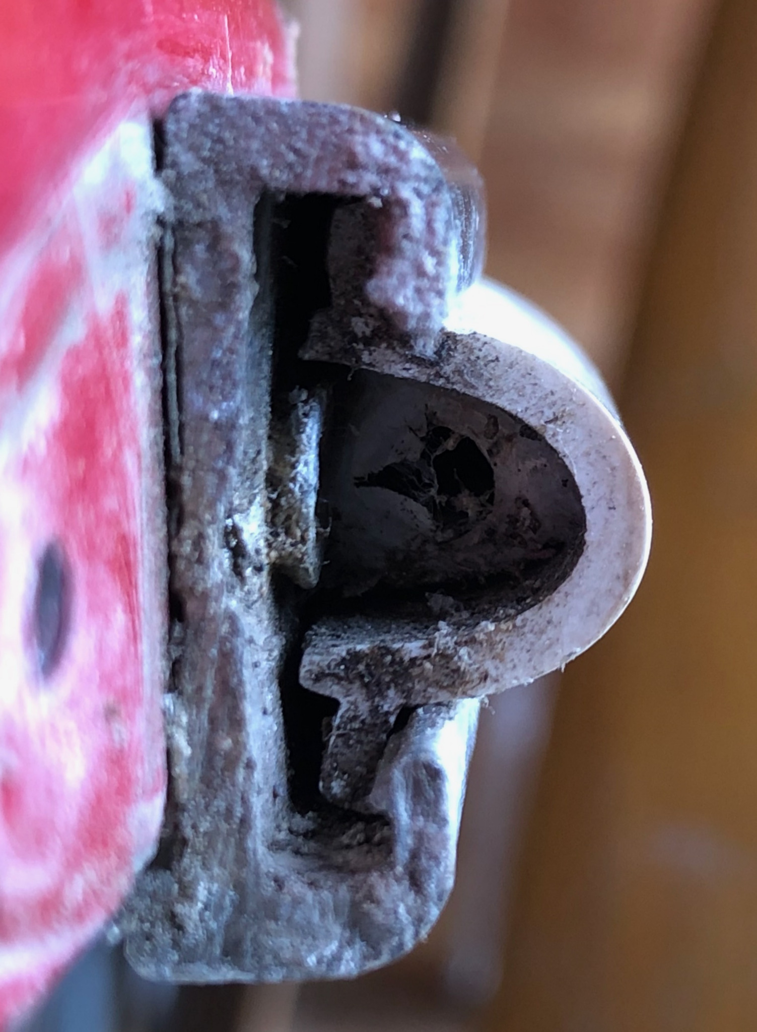

Taco Marine sent me samples of V12-0317 and V12-0334 rub rail inserts. The latter is available only in black but the former is available in both black and white. Lucky for me it seems like the one available in white is actually a closer match to original insert, and white is the original color. If I measured correctly the 50' roll should just barely do the whole boat, both gunnels and spray rails. Maybe I'll get it done before I button up the boat for winter and head back to California. If not, I'll know where to start in the Spring.
New member, new boat: '63 MFG Westfield Custom 6 years 1 month ago #143310
Did not know about the former. White works, but gets scuffed more easily. I had white on my Edinboro originally, but was thinking of giong with black even if white was available, which it was not at the time three years ago. It's a personal preference thing and both look good. White keeps it original.

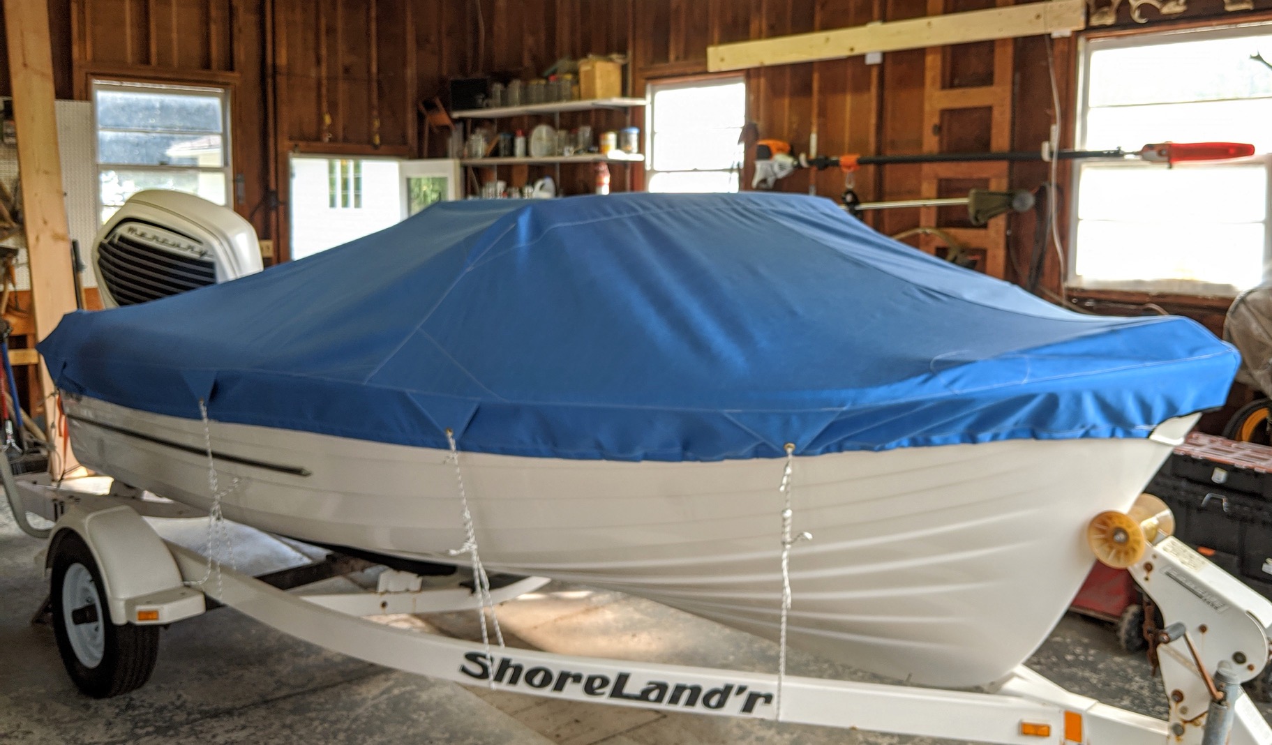

Whizfish, for my 64 Westfield Custom I had a new bimini (w wrap storage cover for laying down on dashboard), vinyl side curtains, stern mooring cover, under-splashwell cover, and towing cover made by a guy in Bath, NY. That is not too far from Canandaigua. He did an excellent job, but to be honest he took much, much longer than he said he would. He had some family issues + all the COVID impacts, but almost a year vs a month is too much. I had him create more headroom than the original bimini. It does not look racy anymore but is more practical (dry and comfortable) for the rear seat passengers. If you are interested in his info let me know.
