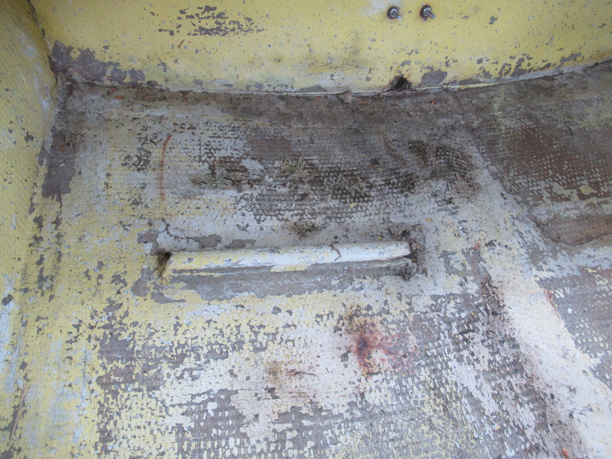

My wife was concerned about whether this boat would float, so my great idea was to fill it will water and see if it leaked. No leaks, so all good right? Nope. In the back where I want to glass a plywood base in for the battery, the floor did not dry out. It's delaminated. I'm exploring ways to fix it before I do anything else. It's probably why we got the boat at such a bargain price!
So it wasn't a bad idea at all to fill it with water. It's just not the problem I expected. Any suggestions?

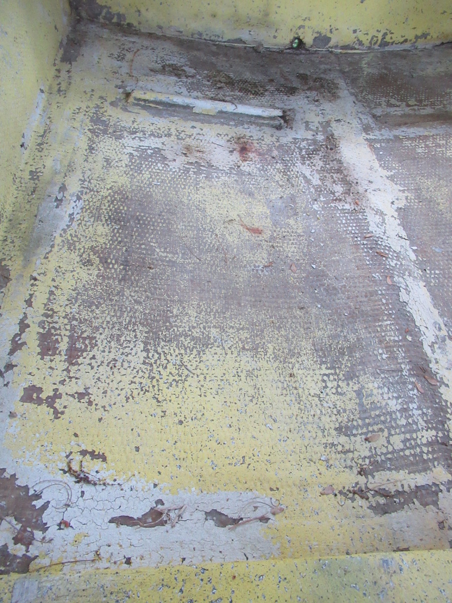

The closer I look, it seems to be the entire area behind the seat platform, like 4 foot by two or two and a half foot. First pic is of the wet spot, second pic if of the entire area.
Any of you who followed what I did with my old Power Cat know that I do not mind glass work, and/or fixing old boats! I just look for suggestions, as this is new to me. My wife loves this boat and I want to get it right.
I will probably be expanding the seat platform back on both sides for modern lounge seats and glassing a piece of 3/4 plywood where the current wet spot is for a battery location. I am still trying to figure out if I want to stay with a pulley system for steering, or convert it to a single cable. I have a covered space to work on it, but am also trying to finish a new hot rod, and get the house ready to sell. Plenty to do, but I retired in early December last year, and love being busy.
Back at work on our Carefree! 7 years 4 months ago #139839
Took out a piece of the floor this morning. Looks like the glass was over 1/4" plywood, though at this point it is hard to tell what it was other than 1/4". Removing very carefully with a dremel tool and cut-off wheel. Will keep going till I find solid wood under floor. Then will replace wood where it's rotted and glass everything back in. It looks like it's solid for maybe two inches side and back too, which will help.
