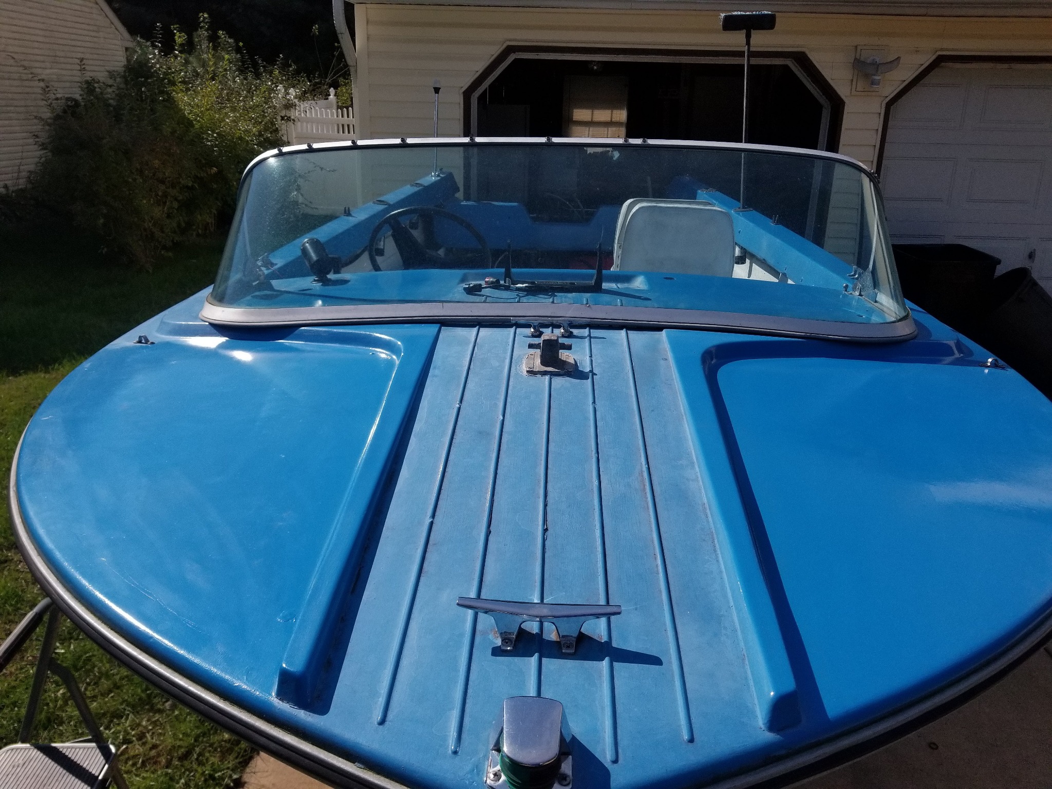

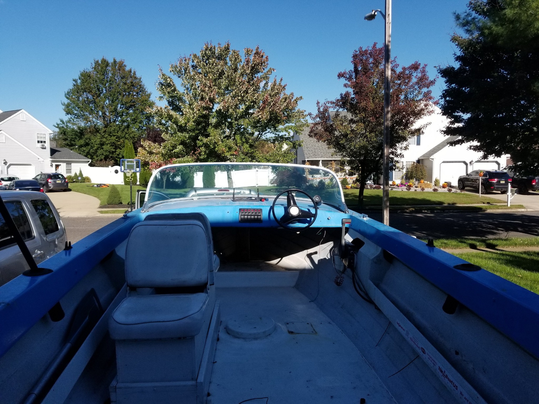

Hey guys. Just joined up here. I recently got my 65 Edinboro for free! Its a little beat up, needs paint, and some other stuff, but im hoping to turn it around into a good looking nice boat. Im pretty sure the windshield that is on it is not the correct one. Anybody know what style windshield this should have? So far i have replaced the steering cable that was completely seized and started buffing the paint a little bit.

With the style deck and motor well you have, your boat is definitely at least a 1965. The style windshield you have was used on Edinboro models up to 1964, but for 1965 and later, it came with an aluminum frame skiff-type windshield with safety glass rather than plexiglas. Yours looks like it is not fitting real well, probably the wrong size, but I'm sure that led you to believe is not the right one, and you are right.

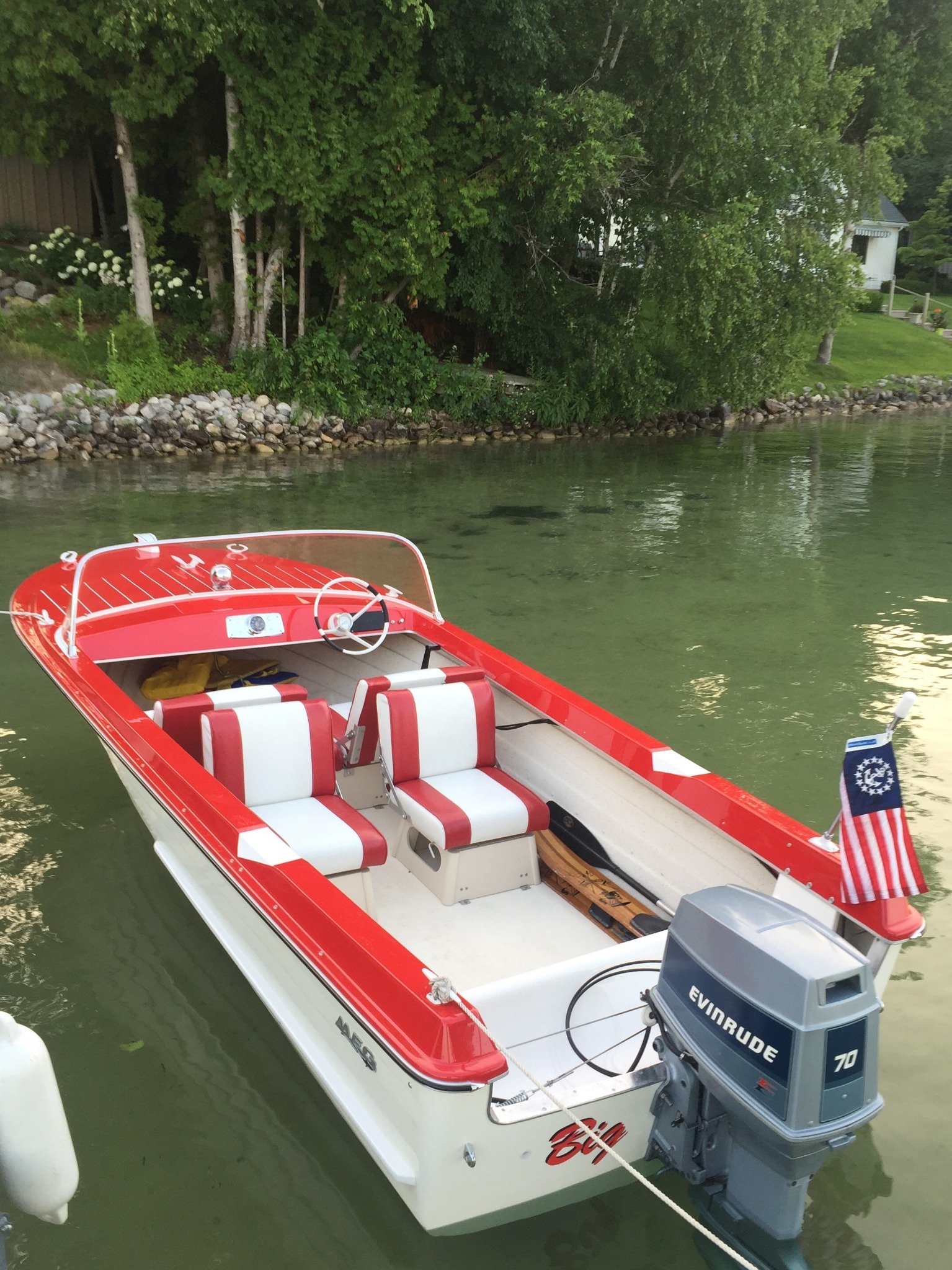

I've included a picture of my 1962 Edinboro.

Thanks for the warm welcome! guys! And also thanks for the info. I did realize that the windshield is wrong while researching the boat. My title says its a 65, just didnt add up to me about the windshield. I did see that my style windshield was used up till 64. And your right it does not fit, it is not wide enough. The floor more towards the sides is a little bit soft, so i will probably have to do a floor in it soon. The transom is solid, no flex in it what so ever. The motor is a 40hp 2 stroke suzuki from 1995. Starts up and runs perfect, just put a water pump and changed the lower gear oil. I will definetly make a post in the member projects section. Just finished working on the trailer, that needed more work than the boat itself i think.
