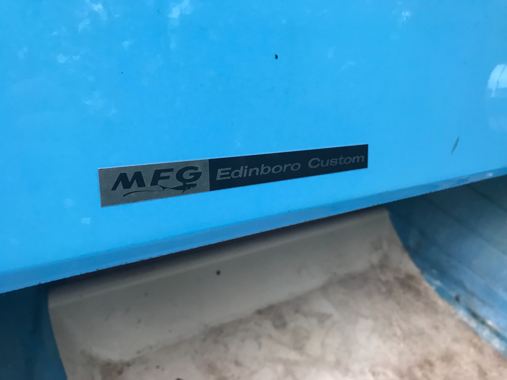

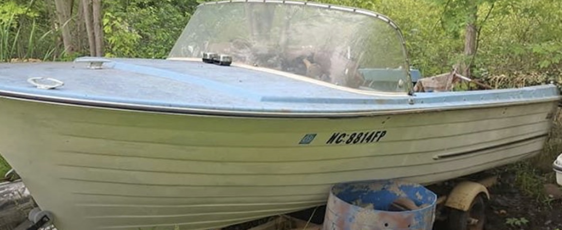

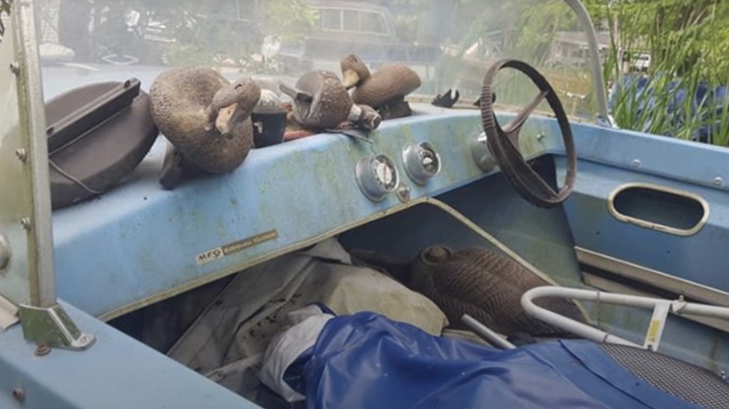

Hey fellas, I picked up this old MFG Edinboro custom by accident (boy was my wife thrilled). It was on a trailer I bought and the guy just said take it with me. Im thinking it will be a cool project for me and my boy. I did a little digging, but couldnt nail down the year more than 1964-1966. its all fiberglass (except the transom which i had to vaccum out). I dropped it in the pond, and by some miracle it still holds water.

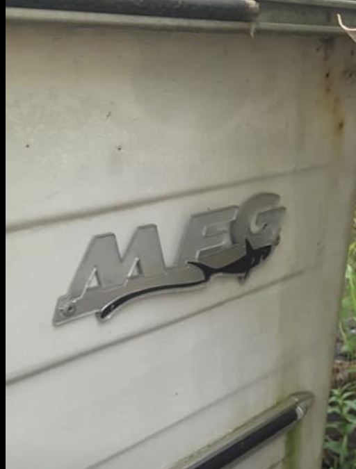

With the blue storage cubbies, and the aluminum ski racks with black trim, it is a 1964. That year, some have a MFG sticker on the gunwhale near the stern, and some have the usual MFG side emblem with the black shark below. Yours has the latter.
Is your emblem die cast metal or the later plastic version? I am curious as the only 64 I have seen close up had the sticker. I know for sure the 1961-1963 emblems were metal, and our 65 was plastic.

That is some great info, I knew somebody here would recognize it. The emblems are plastic. Structurally it seems in pretty darn good shape. My plan is to rebuild the transom and drop an older evinrude i had already on it. Were these built with floors inside the fiberglass? I dont care much for the idea of bolting seats into the fiberglass.
The following user(s) said Thank You: davnau6345
What year is this MFG Edinboro Custom???? 8 years 3 months ago #137210
Plastic emblems, OK. Now we know MFG switched to plastic in 1964. I suspect the stickers were for early in the 1964 model year, with the plastic emblems likely delayed from their supplier.
