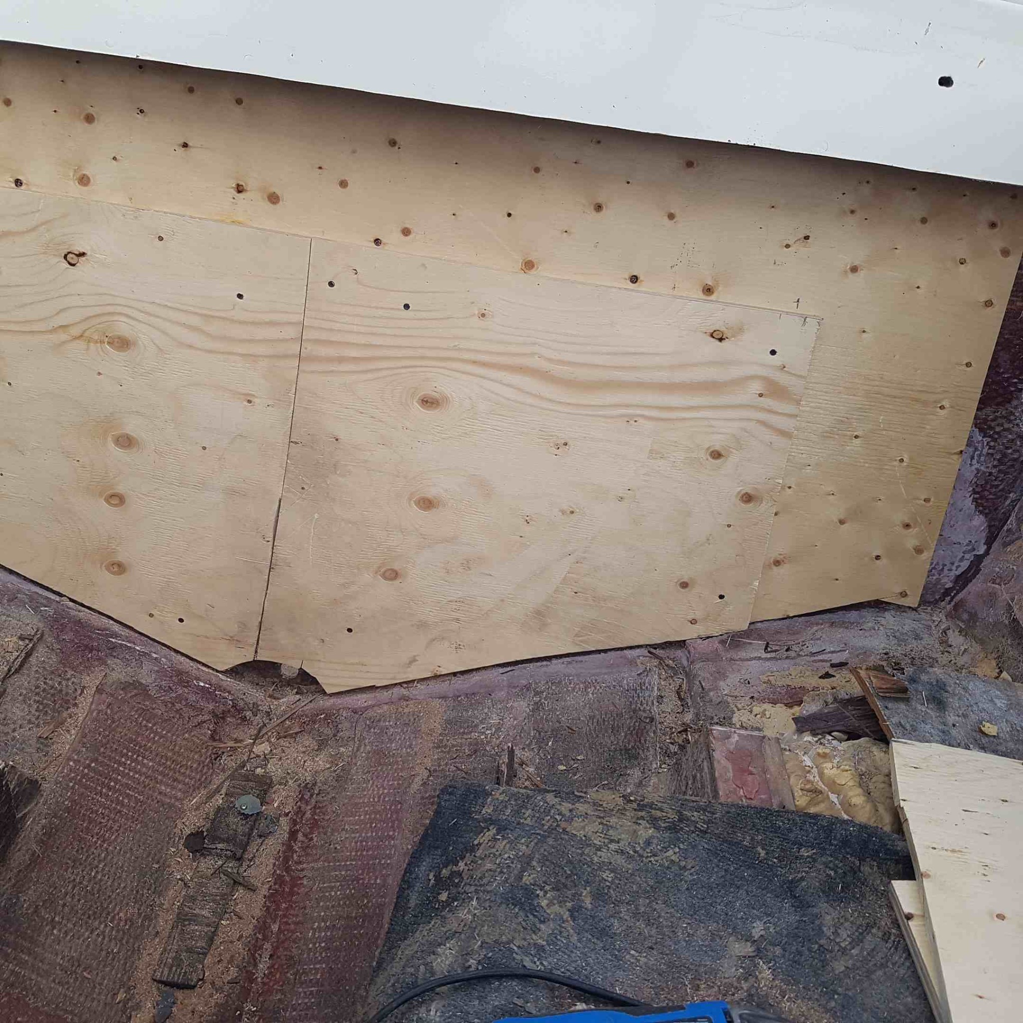

Hey guys has post way back and can't seem to find it so I will start a new one own a 84 mfg caprice 165 merc inline 6 with mc1 outdrive bowrider that had some transom problems looked like one of the bolts leaked and yeah u know the rest so I have the transom all out and I am preparing to put the new one in. So my problem I traced the transom cut the wood and went for a dry fit and it won't go in any suggestions on maybe doin it in more then one solid peice or am I gonna have to take the cap off thanks for the help

Can you upload some pictures? Those will help a ton.
Taking the cap off is always an option but I'd avoid if you can.
If you have to break up your board into a few pieces, you'll want to layer it so you get a nice, strong, and even pressured fit.

Transom help 9 years 2 months ago #133736
Here are a couple I built the transom last nite
Transom help 9 years 2 months ago #133737
Here is a couple more
Transom help 9 years 2 months ago #133738
And one more
Transom help 9 years 2 months ago #133766
I'm a great believer in poured transoms (CarbonCore CarbonBond or Seacast) -rather than using wood again.
Transom help 9 years 2 months ago #133794
It won't let me post anymore I compressed them down to nothing I would love to do a pour in but bigest problem is that I need the boat for my honeymoon so trying to get it done before the 2nd of October also trying to do this on about 4 hours a night lol yeah I know far fetched but gotta try thanks guys for all the help
