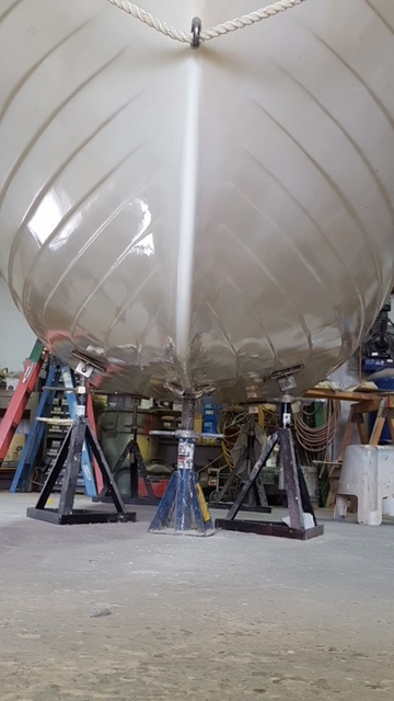

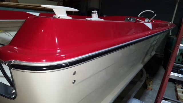

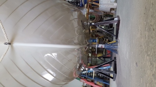

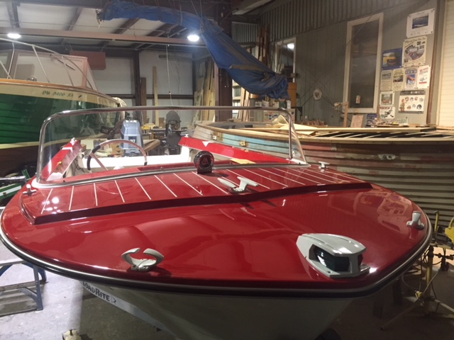

By the early 60's they were using different resins, and that did not happen. I'm getting my 1962 Edinboro restored, and we did not have that problem. We did have to do some repairs on the keel due to trailer roller damage, along with a skinny hole caused by a rock (I think). The whole hull buffed out nicely, without having to re-gel coat the whole thing - only the areas repaired. The deck responded well to wet sanding the oxidation off, followed by polishing. The plastic coating on the deck hardware was delaminating on a number of pieces, so they were all stripped and powder coating in semi-gloss white. Came out well.
