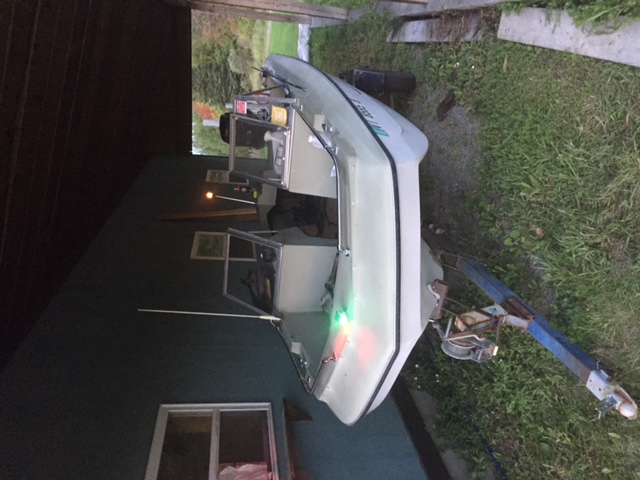

Re:17 Ft MFG Gypsy 10 years 1 month ago #127109

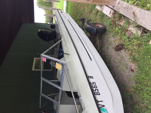

Here are a couple of pictures...

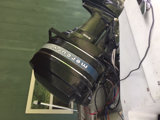

Re:17 Ft MFG Gypsy 10 years 1 month ago #127110
80 HP Mercury 800 THunderbolt

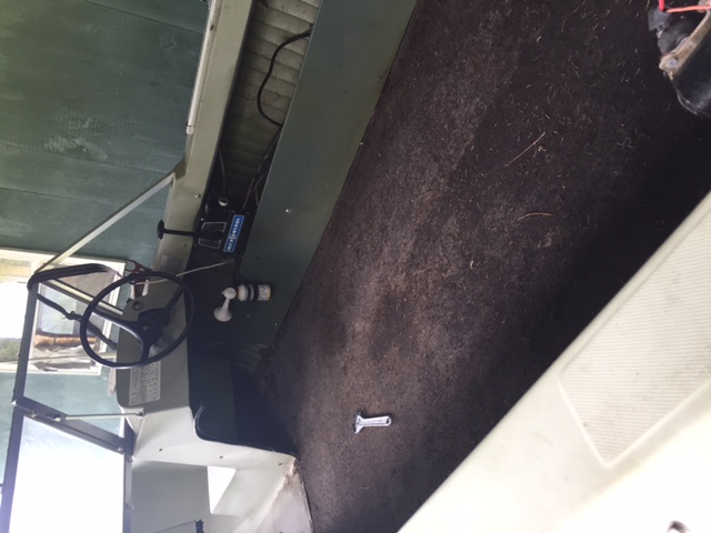

The interior floor is in great condition...I am redoing the seats the steering cable is getting replaced with new one along with the wheel...I have checked out the wiring system and re-run it and will be adding some 12 volt plugs for charging cells and laptops all told I expect it going to take about 900 to sort it out...I slapped a battery box on the system cranked the engine but did not fire it up..I am rebuilding the lift an tilt system....

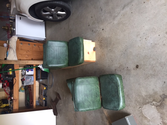

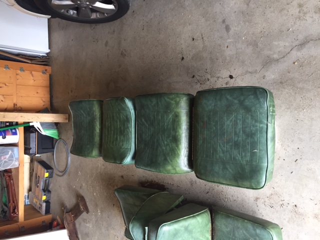

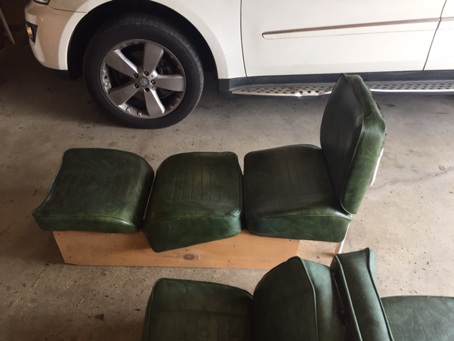

Pictures of rebuilt seats...the seat themselves were in excellent shape....but the base had rotted out..I rebuilt the base using cedar..and will cover it in carpet when I reassemble the interior....
The following user(s) said Thank You: MFG58
Re:17 Ft MFG Gypsy 10 years 1 month ago #127125
IN in lounge position
Re:17 Ft MFG Gypsy 10 years 1 month ago #127126
Seat in bench position

Looks great! I have a soft spot for these. Any side view pics? Is that a holsclaw trailer? Looks like a '1979 merc. Very nice.

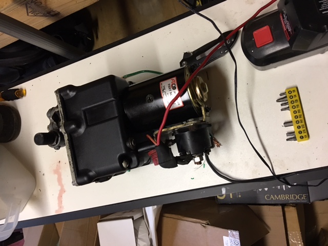

Well life intervened and my restoration of my boat got delayed. I am back on track. Ran into two issues. The lift and trim pump motor was bad. I found rebuild kit online and rebuilt it of less than two hundred dollars. The next issue was the steering cable and rear support for it by the motor. The old support bracket was threaded on the inside. The new steering cable connection requires the support to be threaded on the outside. A fast trip to a plumber and he threaded it on the outside for no charge. The work took five minutes to do with a pipe threader. I have attached pictures of the two items. The rebuilt-lift trim motor and steering cable attached to the support bracket. If I get the weather I will be putting all this together before the snow.
