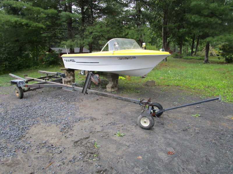

Re:My "new" 1971 MFG Carefree (off the trailer) 10 years 4 months ago #124041
Did good this morning. Got the MFG off the trailer so I could rebuild it. Boat doesn't need much help, other than bolt on stuff, but trailer needs hubs rebuilt, paint, new wheels & tires and wiring/lights.
More to come.
Frank

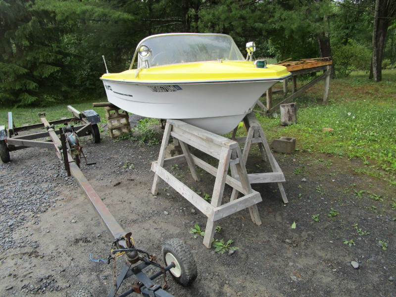

Re:My "new" 1971 MFG Carefree 10 years 4 months ago #124042
From the side...
Those sawhorses in the pic above keep the boat from rocking. I don't have much lumber around right now, but may make a cradle for this baby before I'm done.

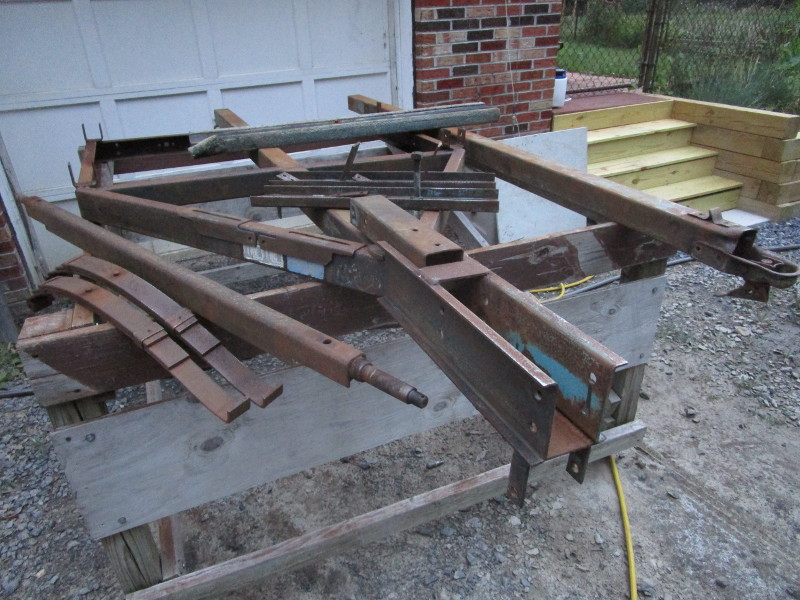

Re:My "new" 1971 MFG Carefree 10 years 4 months ago #124204
True color (or close) of my trailer:
How do you like these safety chains?
Finally, trailer all apart for paint. I pulled the axle and springs this morning, but gotta get going. Busy day at work!
Everything moves into my garage tonight (with AC!), so I can get stuff prepped for paint and figure out what I need for fasteners. All new fasteners.

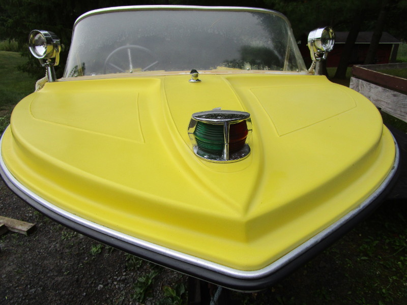

Convertible top help? 10 years 3 months ago #124324
I don't know if anyone can help me with this Carefree windshield set-up, but here's what I have. In part, because I don't have any snaps on the windshield top frame, I have a hard time imagining how it works.
Here is a visual walk-around of the starboard side of the boat showing all the snaps, from one centered on the deck in front of the windshield to a loop back at the splashwell. They are all matched on the port side.
For all I know, these snaps are for a cover? I have no clue, but sure could use some sage advice!

Re:Windshield help 10 years 3 months ago #124328

Re:Windshield help 10 years 3 months ago #124331
It sure seems indestructible! This weekend I will wax the rest of the boat. That's the best way to get up and close to everything. Can't wait to re-power this baby and get it on the water!
Frank
Re:Windshield help 10 years 3 months ago #124345
On the windshield: it looks like it had the clips. Mine are all the same, and are u-shaped that snap on both sides to hold the top.
Another way to do it is with snaps. My setup is a hybrid on the Niagara - clips for the top, and three snaps on the vertical part of the windshield frame on each side to hold the side curtains.
