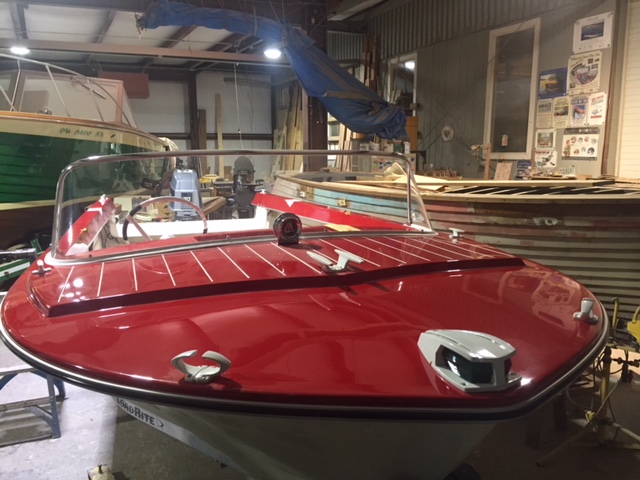

Has anyone had any luck restoring the white plastic-coated MFG deck hardware? Any tips to share, such as materials used?
My new to me Edinboro really could use some help in this area. My Niagara has good chrome hardware and did not need this step.

Congrats! on your new boat. Looks good. Although I haven't started on recoating the deck hardware on my 65 Niagara yet. I was going to try the rubber coating sold on Metro Restyling web site. I bought 3M vinyl too redo my ski racks & pockets form them. Their sercive was excellant.
