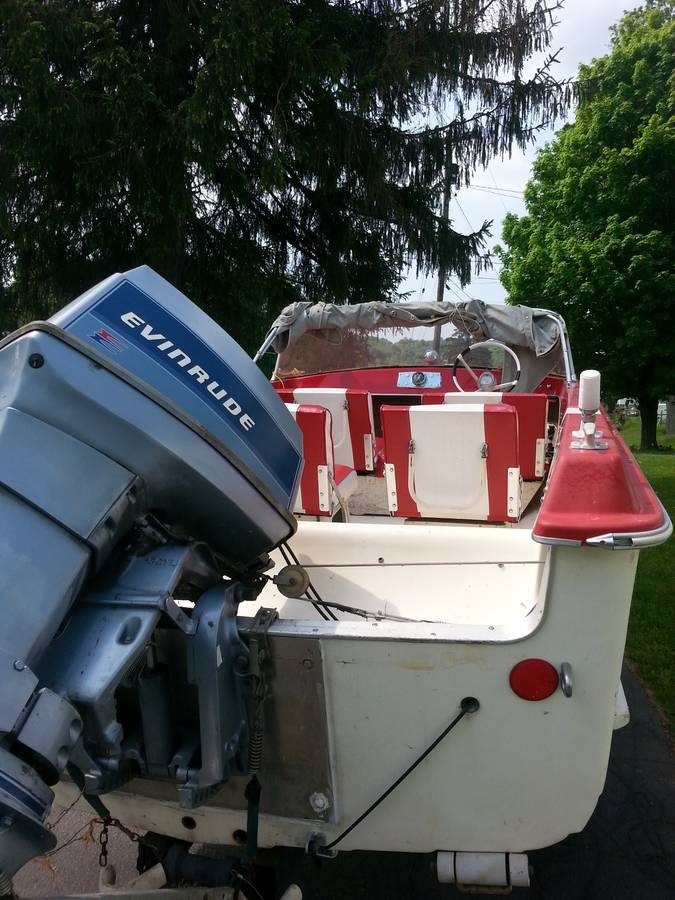

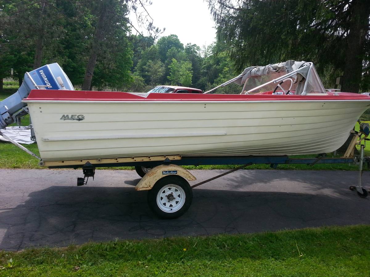

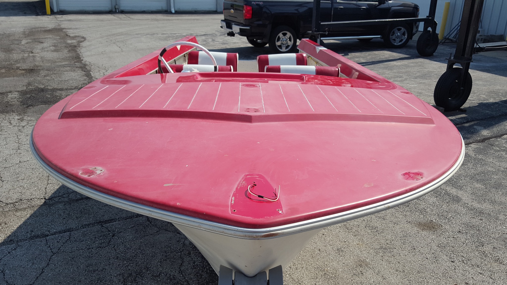

Been looking since I got my 1966 Niagara in October, 2013, for a 1962-1963 MFG Edinboro in red that had the original Sun 'n Fun seats. I was again looking for a boat that had always been stored in a garage, so I would not have foam under the floor water saturation problems. The holy grail for me was the Sun 'n Fun seats from those years, as they were a modified bench style that had a cushion in the middle on the front seat that could hold a child. Needed a place for our little granddaughter! The Edinboro is also the biggest model that will fit in our garage and also still be able to be pulled by my 2010 Toyota Matrix with it's 1500 pound tow rating. (It is the "S" model with the old Camry 2AZ-FE 2.4L engine and 5-speed automatic. Pulled the Edinboro home from Olean, NY yesterday just fine.)
Looked and looked at a lot of boats that were too far gone for me, and never found a red one with the Sun 'n Fun seats.
Finally found one last week for sale and bought it yesterday and brought it home. It needs a new transom, the red deck is oxidized pretty badly, particularly in the bow portion, but it's all there. The white plastic coated hardware needs refinishing - its pretty worn and cracked with the coating missing in a number of places on the parts. Good news, it has the original die cast MFG emblems on both sides of the boat, and they are not in too bad of shape - only a few pits.
But, as usual for these, its very solid, except for the transom. (I'm realizing how lucky I was to find my Niagara with the original transom instact.) I plan to tackle that first, then restore the rest. The motor is a 1984 Evinrude 70hp model, but I eventually plan to try to find a 1962 Evinrude 75hp Starflite with manual shift. Those were charcoal in color that year, with red, white, and chrome trim that will go real well with the boat, and of course would be the same year. The boat has been in the same family it's whole life and was originally equipped with a 1962 Evinrude 40hp Lark that was replaced with the current motor in 1984.

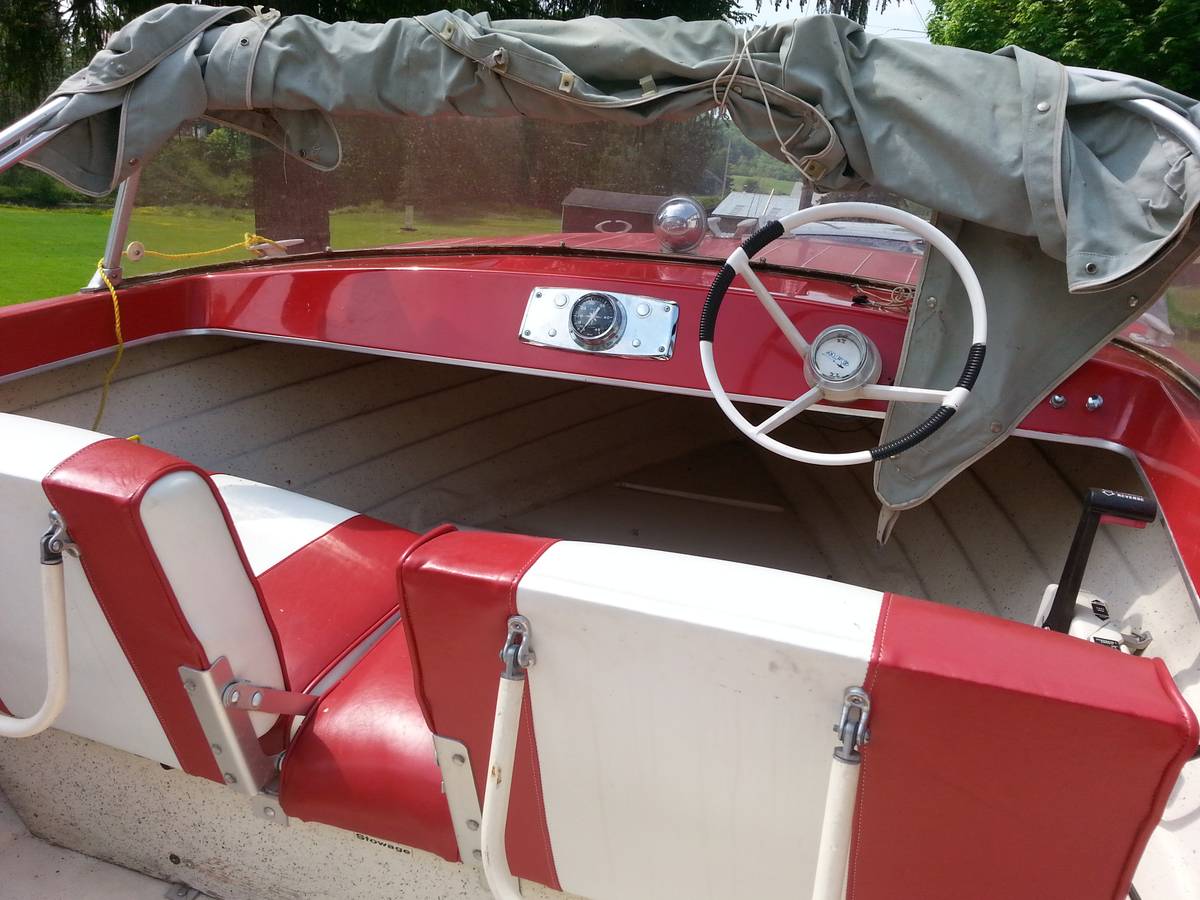

It's going to take some work, but it's the only one I've ever seen that still had the original Sun 'n Fun seats with the seat wood and vinyl upholstery still in good shape and in red! Interestingly, the sprays rails are clearly original from the factory, but are white-painted wood, in decent shape. (I think they went with rub rail style spray rails in 1963.)

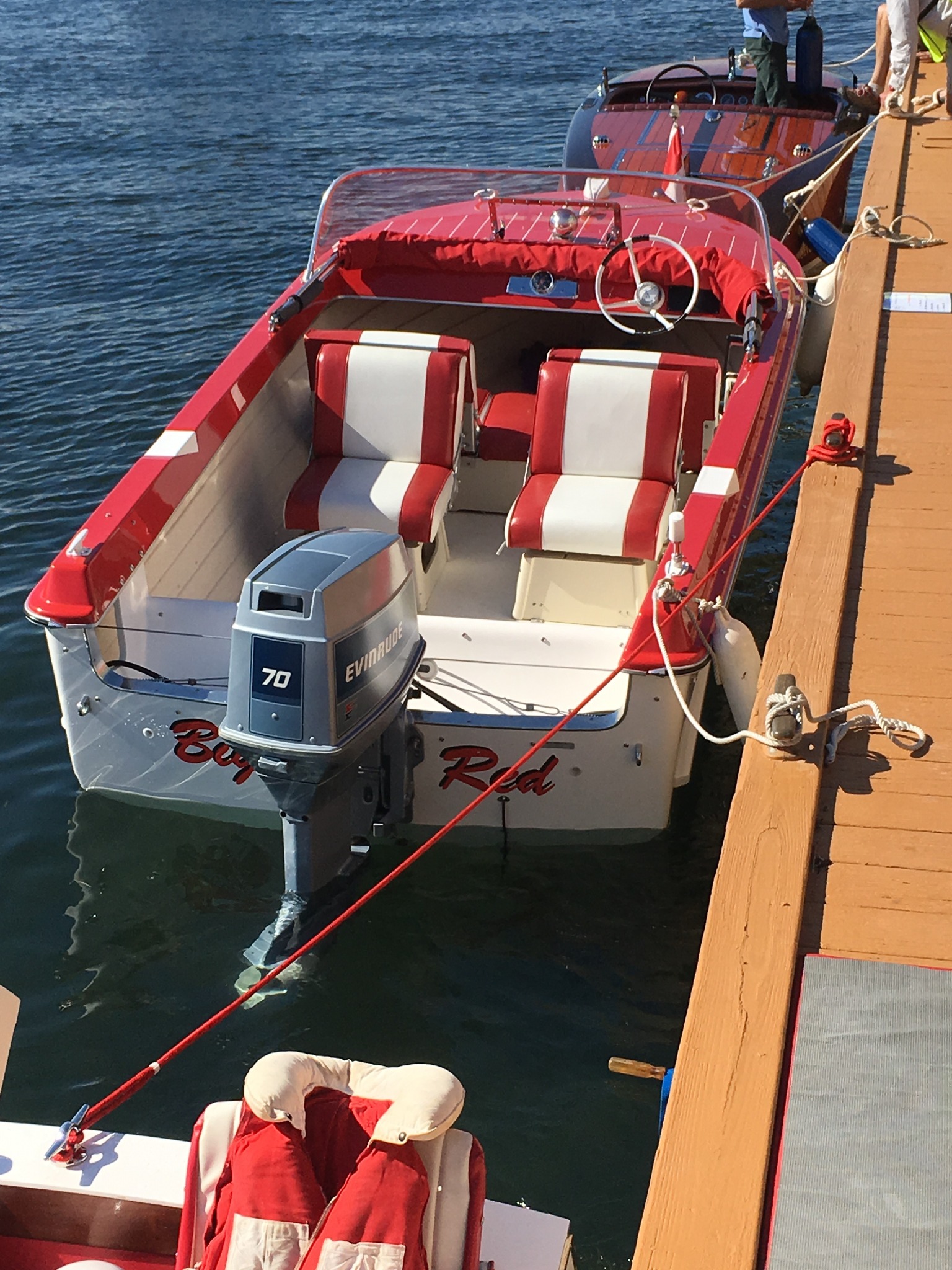

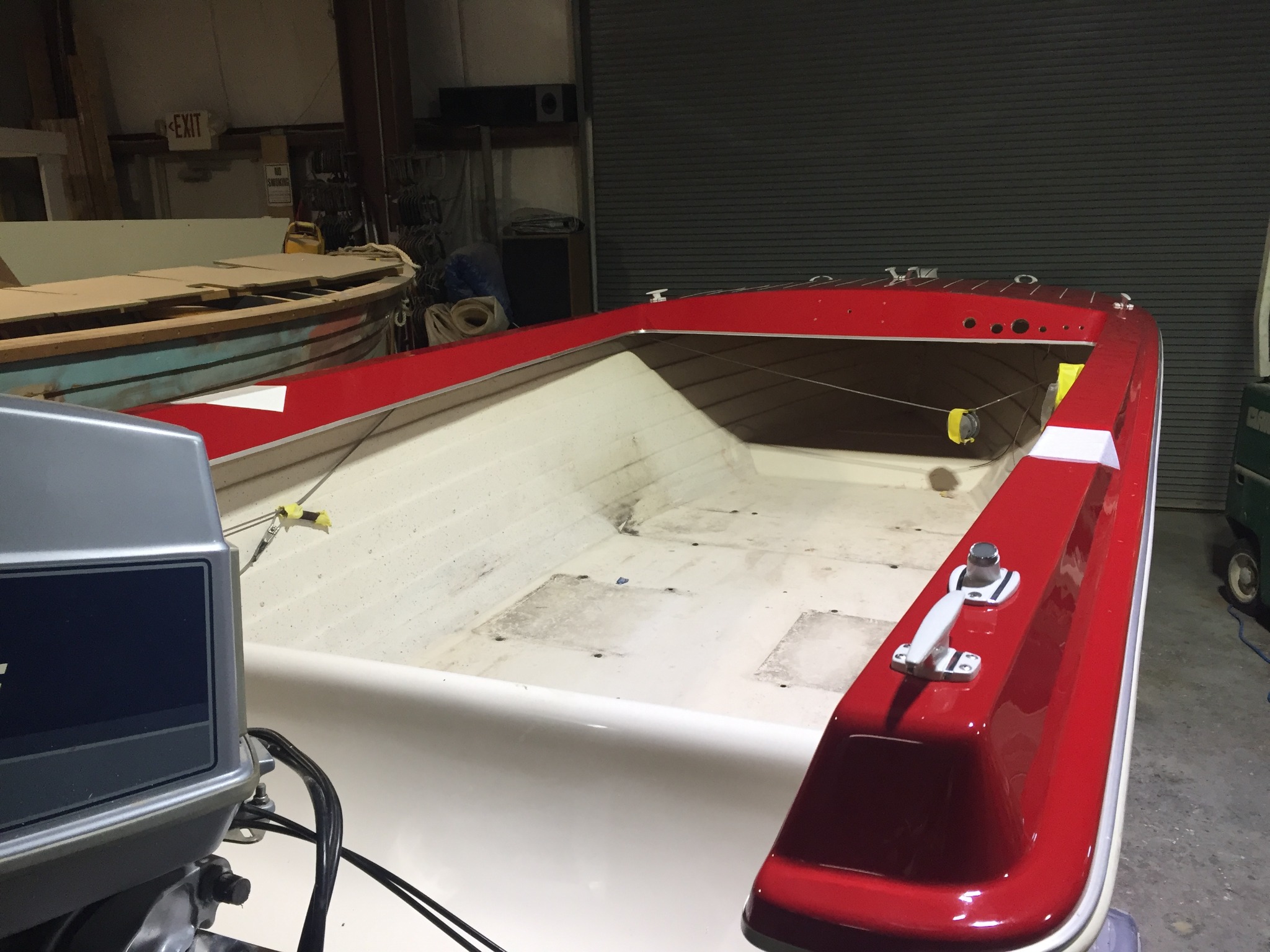

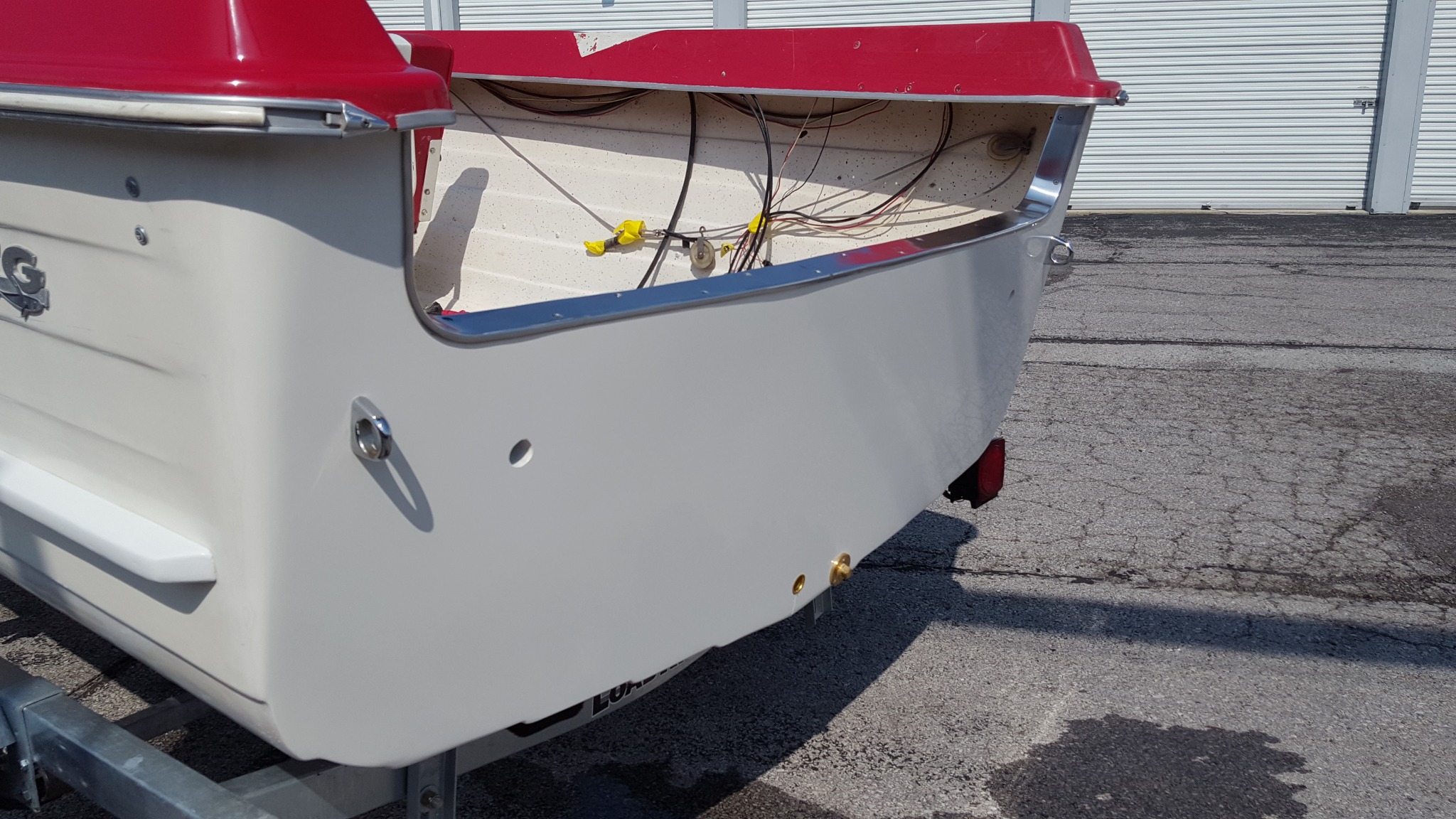

So it has been awhile, but my Edinboro is slowly coming together. I decided to have most of the work done at a local restoration shop and the work had been of the highest quality. The transom has been completely rebuilt, using Cabon-Core CarbonBond, the fiberglass skins repaired, the inner skin of the transom repainted with duplicated splatter paint, the outer skin re-gel coated, the keel cracks and small holes repaired and re-gel coated, the motor well completely rebuilt and re-gel coated, and the seat boxes rebuilt and repainted. The deck was sanded four times with increasingly finer sand paper and polished. (The MFG gel coats from back then were so thick, that sanding and polishing brings it back without having to repaint or re-gel coat it.) The deck hardware has been stripped, powder-coated, and new tape strips applied, along with the 16 deck pin stripes redone. The windshield had a big bend in the middle from the previous owner falling on it while trying to tie a line to a cleat. That's been repaired and the windshield will be polished the reinstalled with a new gasket along the bottom. One picture shows how faded and oxidized the deck was before restoration.
It's all coming together for a spring relaunch from the new Load Rite trailer. The 1984 Evinrude 70 has rebuilt carbs, new fuel lines, new impeller, and repaired prop. The seats will have the original vinyl and new mounting hardware in most cases, on the rebuilt boxes.

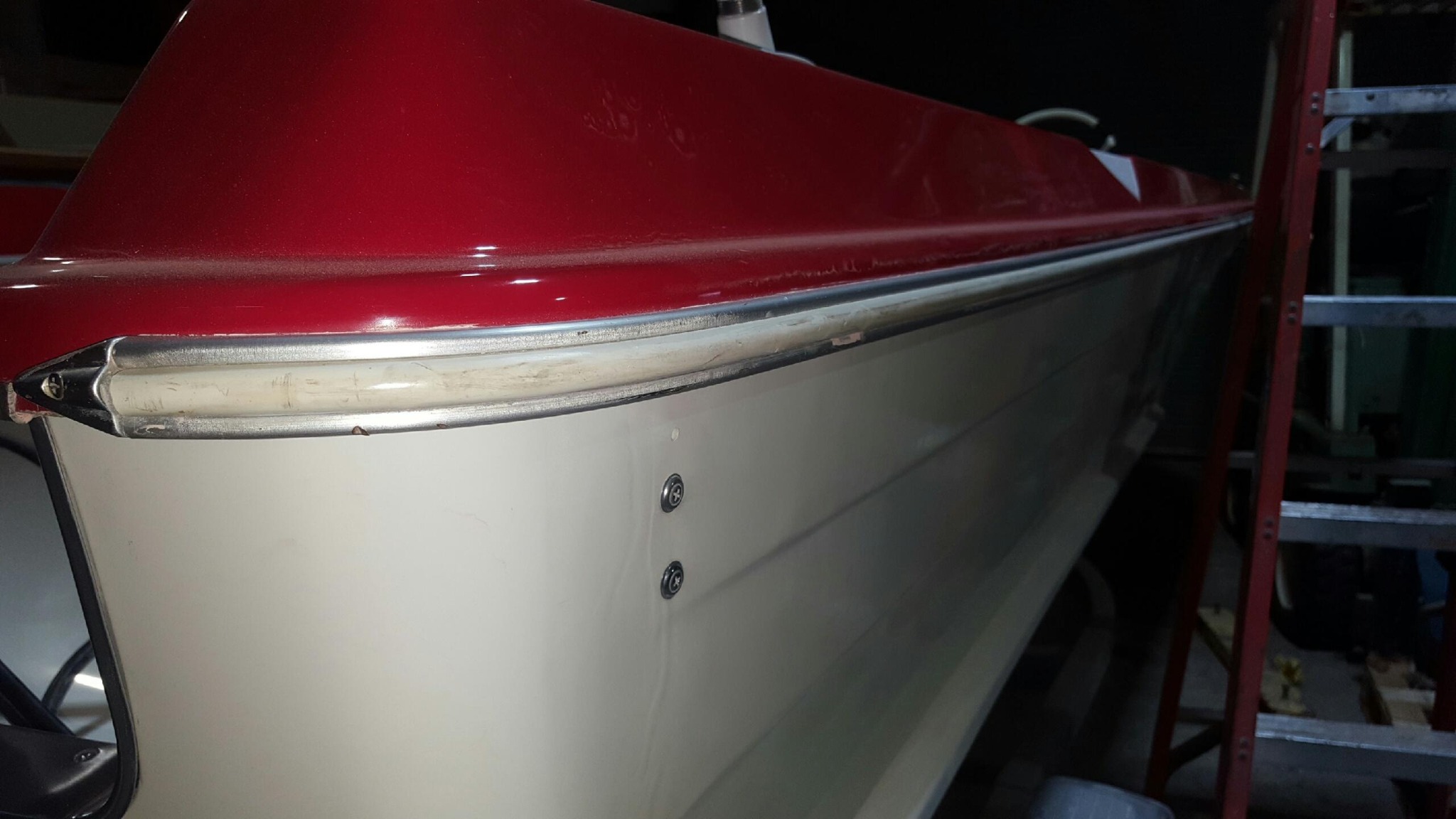

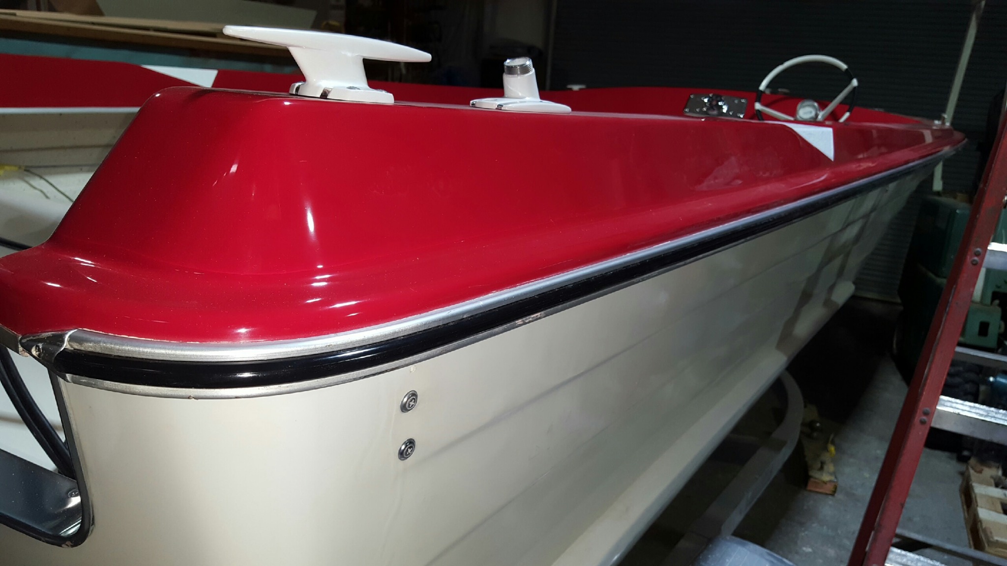

Turns out that TACO Marine no longer carries the white rub rail insert for 1961-1963 MFGs. Their supplier in Maine no longer makes it. He has the tooling, but there is no demand. Cost to run a batch would be too much, as he requires a run of several thousand feet. Starcraft also used white in the early 60's.
However, black is still available and used by MFG starting in 1964 models. So, my 1962 Edinboro now has a black rub rail insert. Before and after pix below:
Re:1962 MFG Edinboro with original Sun 'n Fun seats 8 years 10 months ago #135386
Black may not be original, I think it looks better! adds a break before the white hull, just another opinion, I think your boat is beautiful.

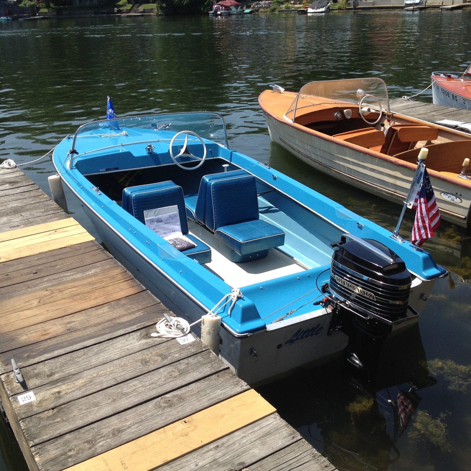

Thank you for the kind words. I'm beginning to like it better. My 1966 Niagara, of course, has this, as it came that way from the factory. So they are both black now. The black trim on the steering wheel helps to show it better, I think. My dad's first boat was a 1963 red Westfield, and it had the white rub rail, so that's what I had in my head as a memory.
In any case, it's coming together, with the goal to have it ready to show at the Piston Power Show at the IX-Center in Cleveland, March 16-18, 2018. I expect to launch it in the spring.
The Niagara is shown below:

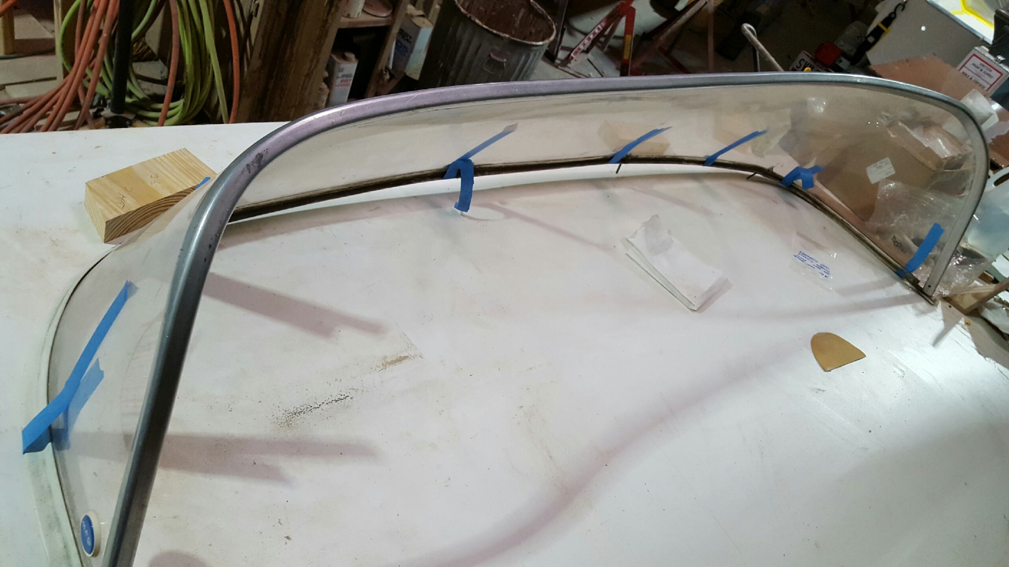

The repaired (bent frame) and polished windshield got remounted this morning, with a new bottom gasket.
Looking good!

That windshield bottom gasket looks great! My gasket is still intact, but very yellow looking. Not yet cracked... not even on thin edges, so does show tmy other boat is a 1965 survivor. However, if you can let me know where to buy that bottom gasket , maybe I should consider getting it and setting aside for a rainy day project if mine starts to crack with more sun exposure ( likely will crack from minus 25 degree F temperatures before the sun gets it.)

For the TaylorMade Plexiglas windshield, we got it from A&A Marine. These were used by MFG, Starcraft, and many others. Comes in 110" length. for $59.95.
See:
www.classicboating.com/parts/windshield-gaskets/windshield-gasket-taylor

Thank you for the link. I have never replaced one before. When the new trim is put in place with hidden fasteners. Does there need to be any sealant or rubber type glue used to grip the bottom of the windshield, or is it strictly gripped by friction? Just curious what keeps it from popping out in case I decide to push the boat a bit faster than original recreational design.

Just held in by the frame itself, plus the slot for the Plexiglas that is molded into the gasket. No sealer is used. Once it sits out in the sun for a while after installation, the vinyl gasket kind of molds itself to the deck surface. In my picture, you can see that some of a edges area bit upturned inside the cockpit side, but the shop the boat is in is only about 60 degrees on cold days like today in winter. Once in the sun for a time, it will be fine.
1962 MFG Edinboro with original Sun 'n Fun seats 8 years 10 months ago #135408
I let my windshield with new gasket just sit in place without tightening for a week and it all flattened out.
www.jamestowndistributors.com has them for 39.95

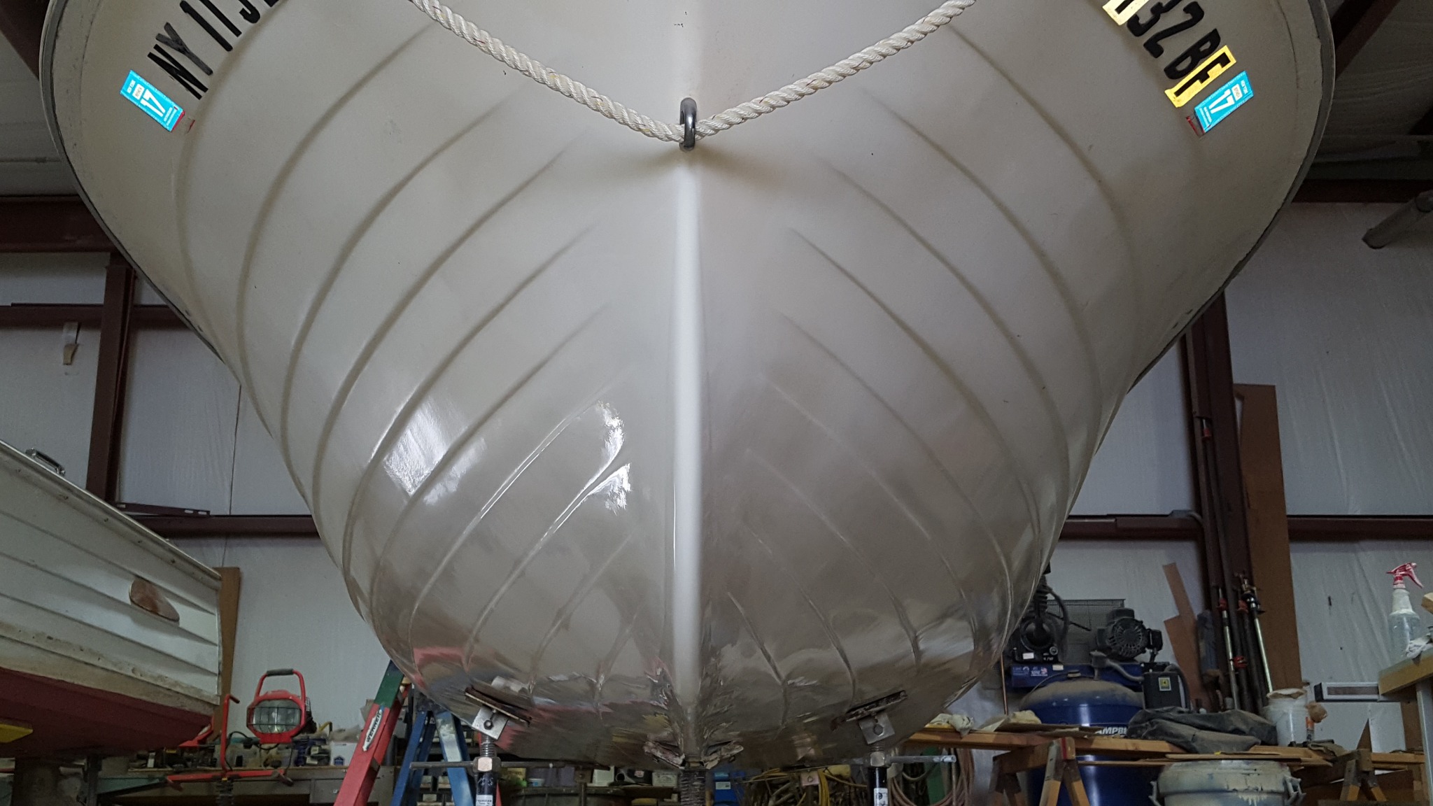

Following up with weighing the boat to see how much water might be under the floor, it weighed 865 pounds after taking out the trailer wight, and without the motor mounted. Subtracting 40 pounds for the weight the new CarbonBond transom added, it came out to 825 pounds. Subtracting out 10 pounds for the motor control and about 20 pounds of gear still stored under the seats, that left 795 pounds. The weight was shown as 720 pounds for years, but near as I can tell, that was low, and was only for boat with only a front seat, and I had the front and rear Sun 'n Fun seats. I estimated the true weight with all seats was around 760-780 pounds. Weight in 1970 was shown as 934 pounds, but that included an internal gas tank, a heavier windshield, plus ski racks and storage bins. So, thinking around 775 is about right, I decided 795 was not enough to really worry about, as it might really have weighed close to that anyway. So for now, I decided to leave the floor alone.
We'll see how it performs in the spring.

So, after three years of work, Big Red is just about done. Took it to the 2019 ACBS Annual Meeting and Boat Show this weekend in Alexandria Bay, NY. Got Silver in my class: Outboards-Restored. Better than I thought, since I lose so many points with the newer Evinrude on it. It’s my primary user family boat now to take the grandkids out on.
