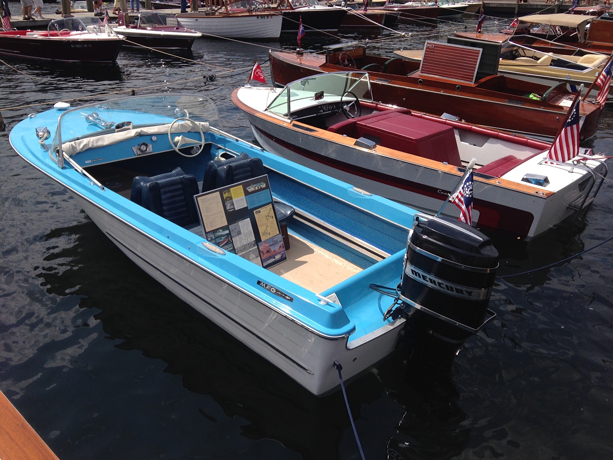

Restored this this year, for a change an oldie that did not need much. PERFECT transom but ya still gotta do work to keep them that way due to factory oversights. As a tribute to original owner, I've named it "Walter" .
Re:Finally can post a pic of my 65 Erie! 11 years 4 days ago #116896
Wow, that's really a great looking boat! That model is hard to find - only made 1965-1966. I remember a 1966 Bronze Mist-decked one on Lake Chautauqua when I was a kid, owned by the owner of the cottage resort we would stay at and powered by the then new 100hp Johnson.
Where are you located and where did you find it? I'd love to see it. I'm really partial to those MFG's with a Horizon Blue deck.
What factory oversights were you referring too? I think those hulls are hand-layup with fiberglass floors and wood stringers, like the Seaway. I'm sure volume was too low to pay for the tooling of a matched metal die set.
Also, I've found the finish on a factory original hull of the Erie was shiny like the deck, unlike the pressure molded Niagara, Westfield and Edinboro, which have a more satin finish. Lost two points at the Clayton show this year because the judges were not familiar with the satin finish of my Niagara - they did not think it was as shiny as it should be.
You should show that boat at an ACBS show - it would be a hit! Your Erie shows really well with that black Mercury on the transom.

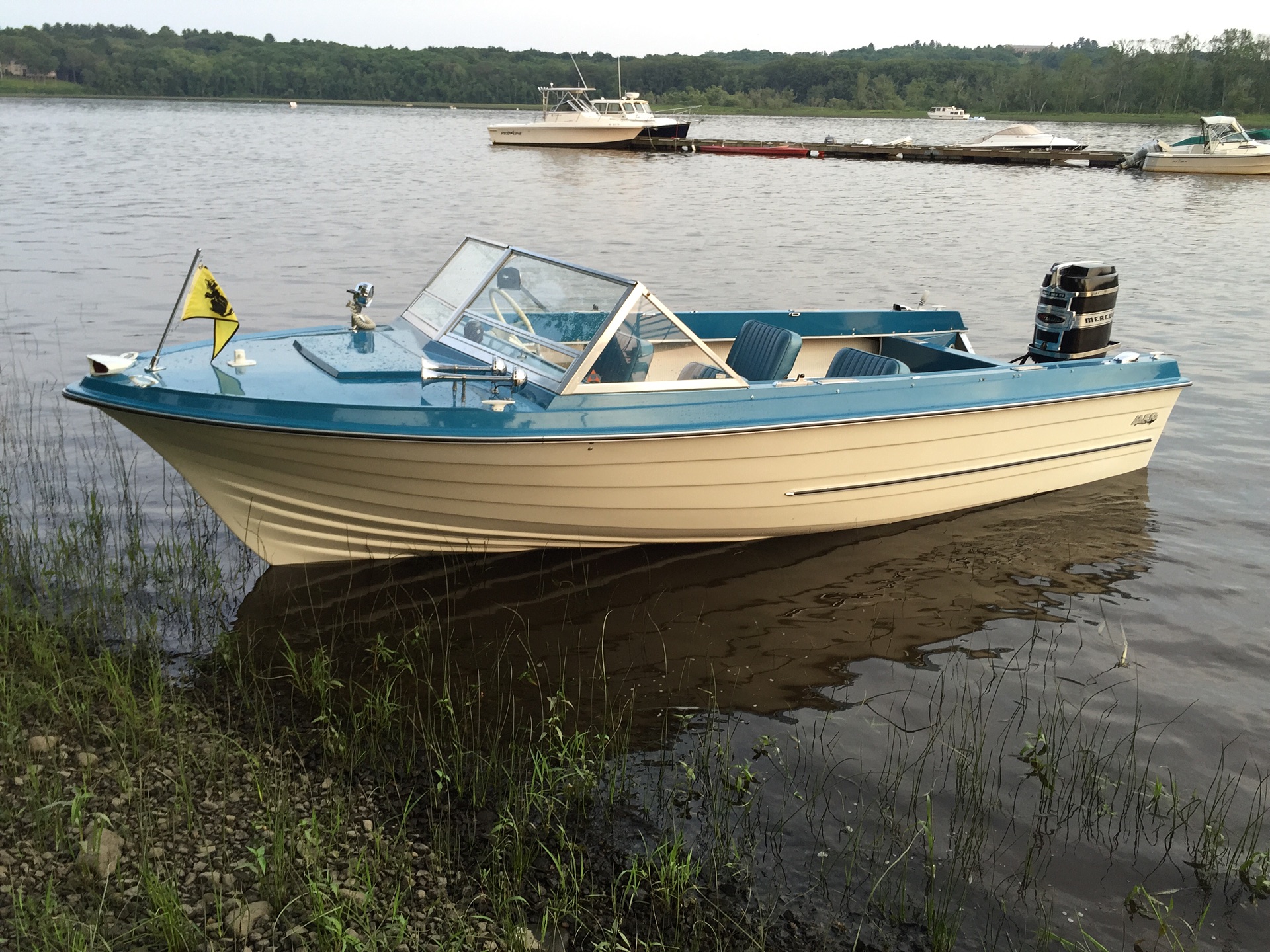

I got somewhat lucky with my Niagara. It took two years of looking, but I was trying to find a blue Niagara or Westfield, in great unmolested, original shape. Finally found one on the Pittsburgh craigslist. Just took time and effort, along with some luck to actually find one. I guess I'm too lazy to do a complete restoration!
For your boat, just keep working on it, but also use it and have fun on the water with it. From the small picture, it looks pretty good. Looks real good with that Mercury on it. Most MFG dealers back in the day were Johnson or Evinrude dealers.
The biggest issue I have found with old boats that otherwise look good is with the seats - they go bad first. Just got done doing minor restoration of the seats of my 1970 Arrow Glass Flyer by fixing some wood rot and rusted screws, replacing them with stainless. Finally got it out yesterday (76 degrees and a calm Lake Erie off Cleveland!) but found the 33 Johnson on it probably has a bad coil - only running on one cylinder. At least I got out.
I'm now looking for a nice Westfield or Edinboro Custom with intact Sun 'n Fun seats. I've found that's been been a tough boat to find. (My brother's 1965 Edinboro Custom is a mess and the Sun 'n Fun seats are starting to fall apart.)
My Niagara is the base model with the original back-to-back lounge seats. Those were OK with me because my favorite boat we had growing up was a blue 1966 Westfield (base) model and mine is just like it, with the same seats, just the one size smaller Niagara.

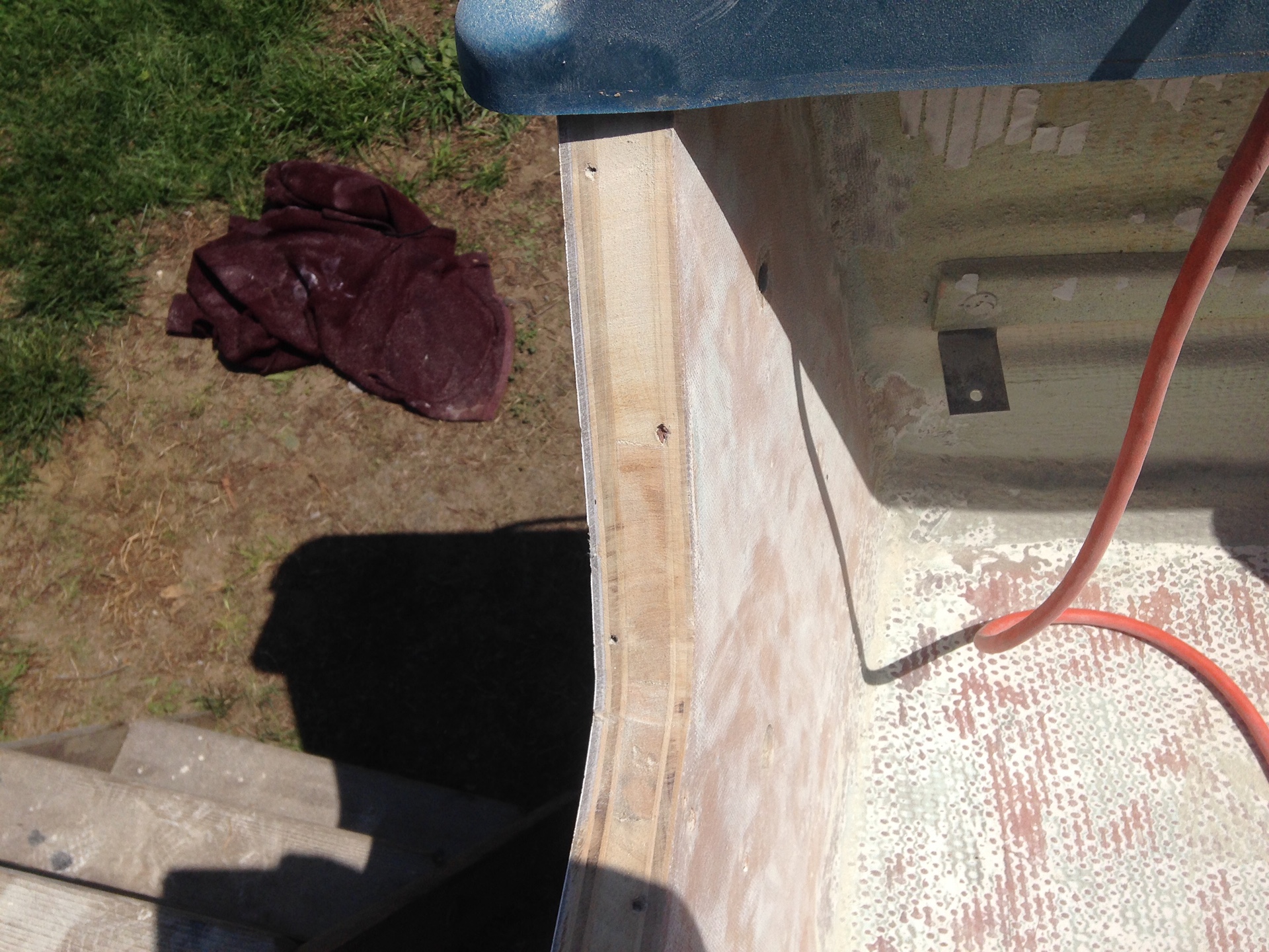

So a few things to do once you have a good one is to protect the transom from water intrusion. Any through bolts are obvious but the not so obvious is the transom top under the aluminum trim and the two drain tubes.
Here is a picture of the Erie with the motor well out and transom trim removed and the side storage shelves off to give unrestricted access.. The wood is perfect, so I got busy protecting it. The transom was two layers of 1/2 inch ply with a 1 inch layer of end grain balsa sandwiched between them. I ground the inner glass clean to remove the paint layer and ground the top edge just to clean it.
The weakness is water will easily wick in through the trim screws or right under the trim itself. The end grain balsa and plywood edges will wick in as much water as gets to it, there was no real sealing of the transom top wood from the factory and what was there was hardened and now useless after 45 plus years.

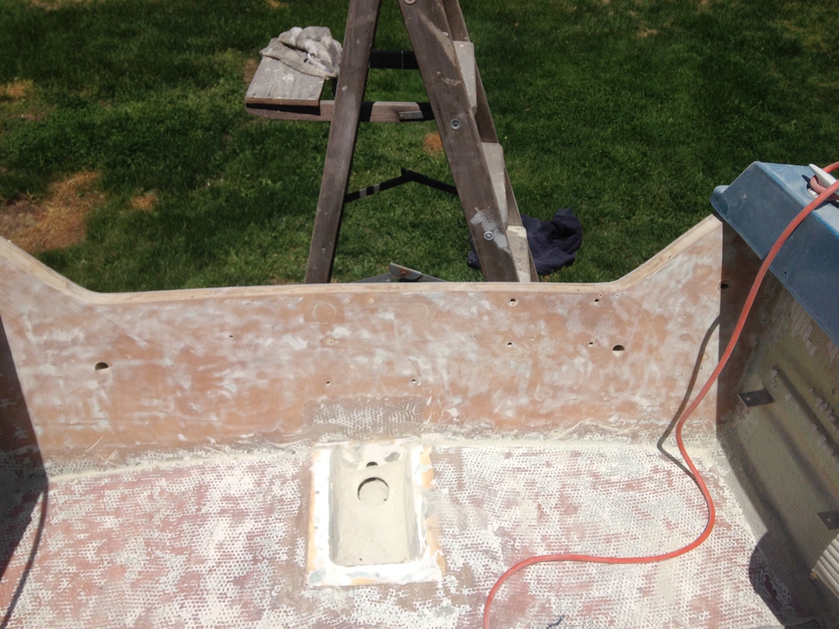

Here you see I have some drilled holes to be concerned about. The original transom motor bolt holes, 4 holes from a trolling motor bracket and screw holes from the motor well. You will also note I cut a round hole in the drain sump to get access to both sides of the below floor area drain tube. I also removed the speedo pick- up and the the trim and pitot tubing itself to treat that hole through the transom as well. Anywhere a hole touches the wood needs attention because no sealer was used or its old and crumbly due to inferior materials available at that time.
The drain tubes are a real weakness because water will wick into the wood around the outside of the tube, they have very tiny flanges for sealing against the transom face and they are just pressed in, no sealing at all. Where the edge is rolled on the inside, again no sealer so any water that runs into the sump will wick in between the tube and the wood core. The same is true for the motor well drain tubes but they are not as problematic being above the waterline. Once this process starts its certain rot which speeds this process allowing more to wick in. All this is fine for the boat to last 5 years or so,which was the only intention. You will also note I ground the floor in the tank area so I can add new glass that will roll up the transom making a seamless layer of glass at the floor transom corner.

I can now start the preservation process but first I let a hair dryer run in that sump hole it blows air through the drain holes to insure wood is real dry around the diameter. I felt dry and zero rot but just playin it safe.
Interesting to note is that the brass tube in the lower hole started to corrode in one small area on the O.D. on the tube not visible till I removed it...whew caught it in time. Thank goodness this boat was in a garage for years rarely used and even at that some, seeds of destruction where starting but, no progression.
I'll continue on with the preventatives but that'll be the next post

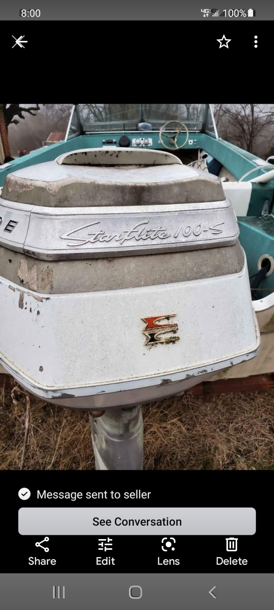

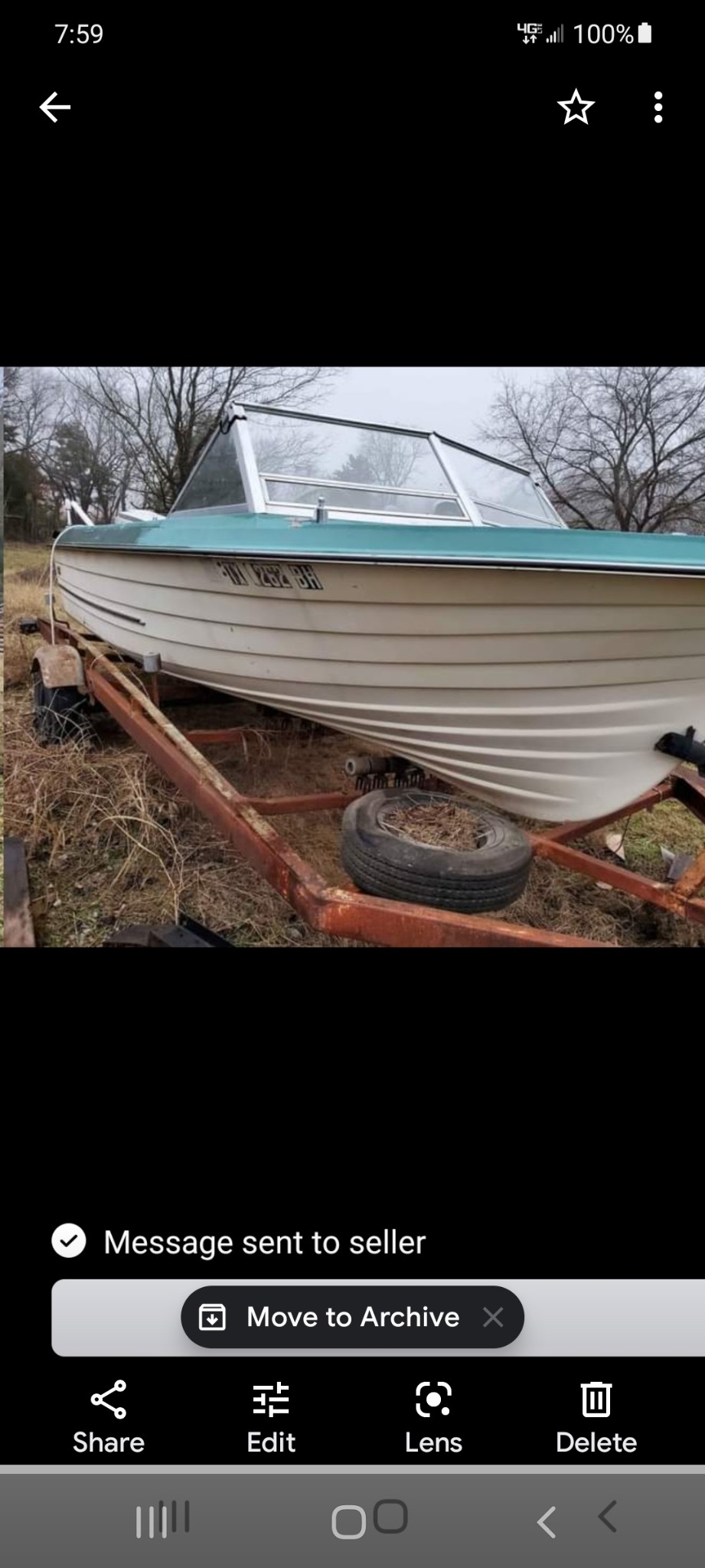

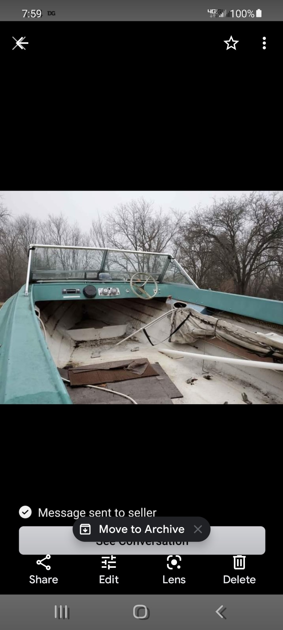

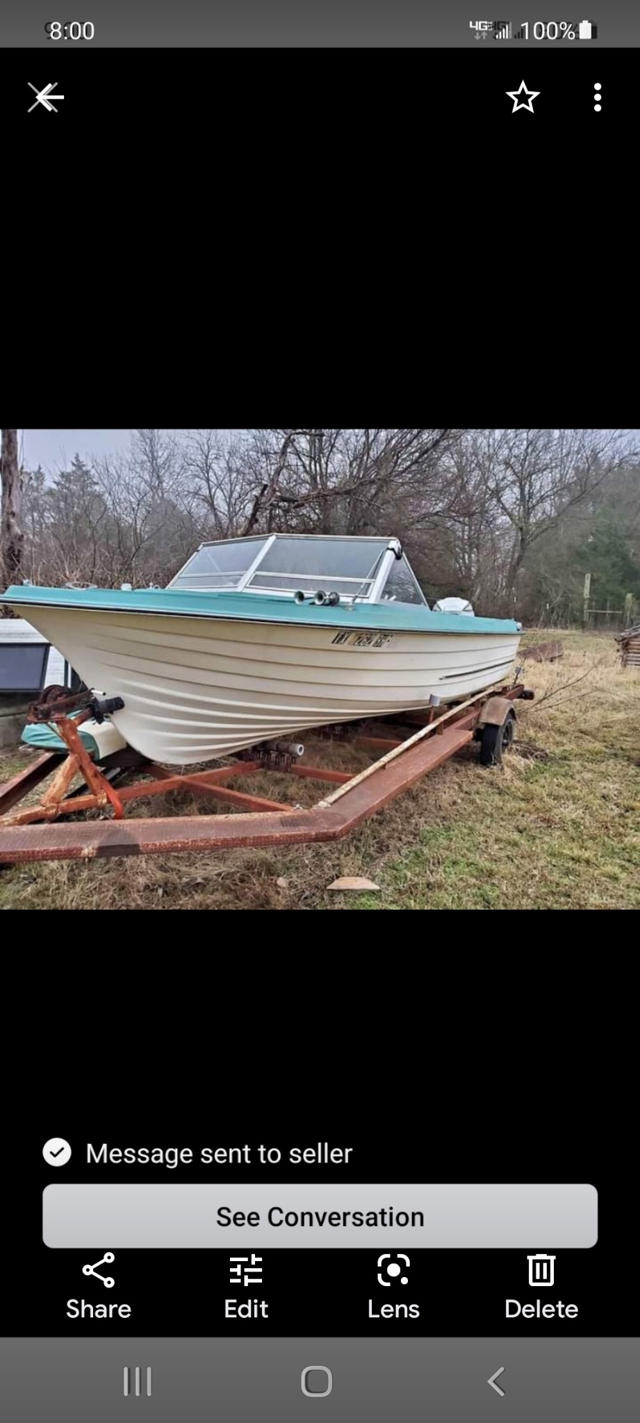

I realize this is an old post but I wanted to share my boat as well. I absolutely know very little about boats, however I do know a little about fiberglass. My husband and I were browsing Marketplace looking for a fishing boat. I came across this little jewel and it spoke to me....volumes! We even drove 7 hours to pick it up and drove it back home. This boat was bought from a girl whose grandfather bought it and the trailer new in 1965. It had sat for 15 years without any use. We took the boat to a mechanic friend in Houston and believe it or not, it started up first thing! There are no noticeable defects, however the seats were missing, dang it!
I'm very excited to spruce it up but definitely nowhere near what you guys do. I'm finding people from the north are much more likely to refurb older boats and I'm excited to be able to check out this website to see what replacement parts I will need. I haven't had the boat in my possession but about a week before we took it to Houston so I'm not sure what parts are missing other than the light on the bow and it appears something is missing on the passenger side bow as well. If anyone wants to look over my pictures and help me figure that out I'd appreciate it! Thanks
Finally can post a pic of my 65 Erie! 5 years 3 months ago #145019
Looks like I didn't quiet learn how to attach photos. Sorry for the duplicates!
