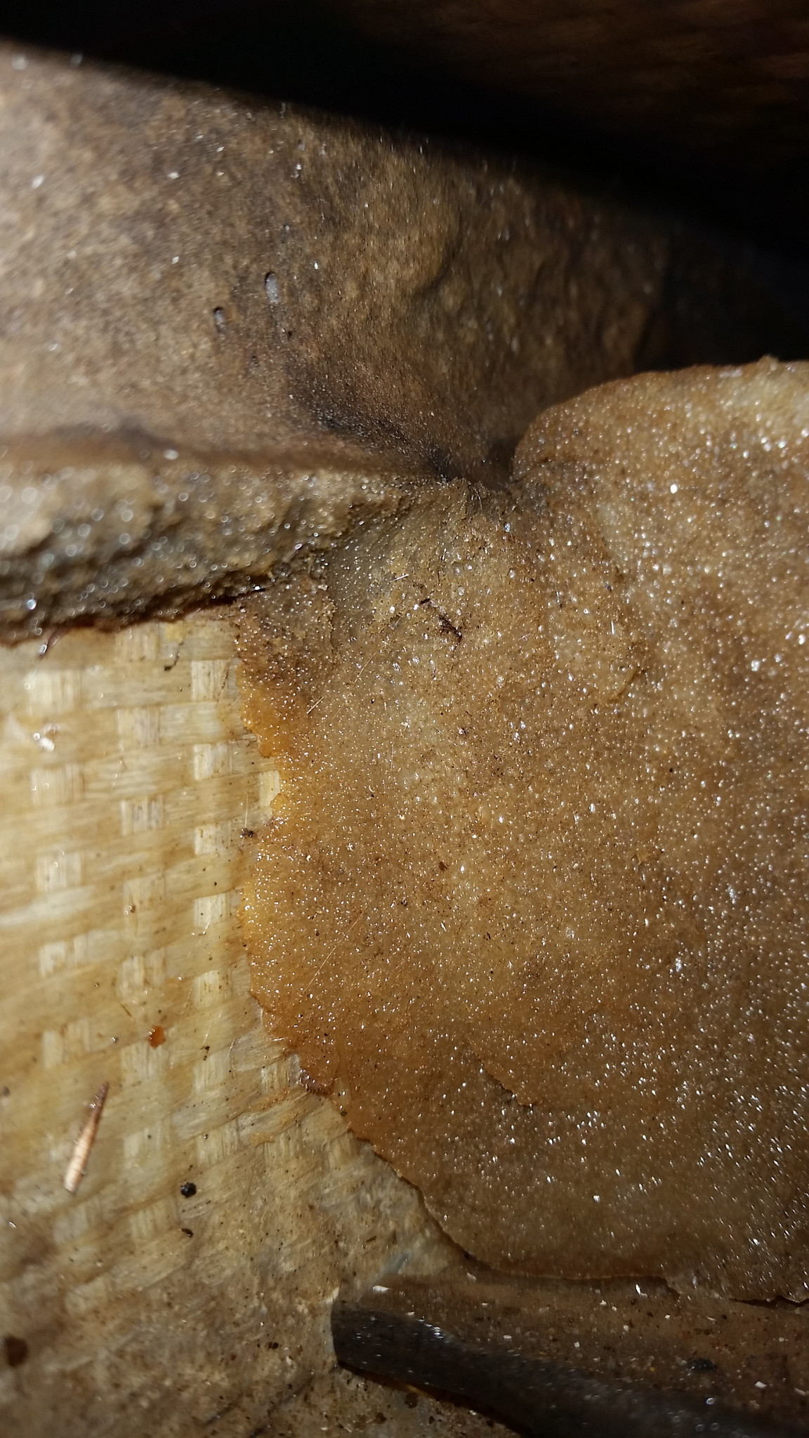

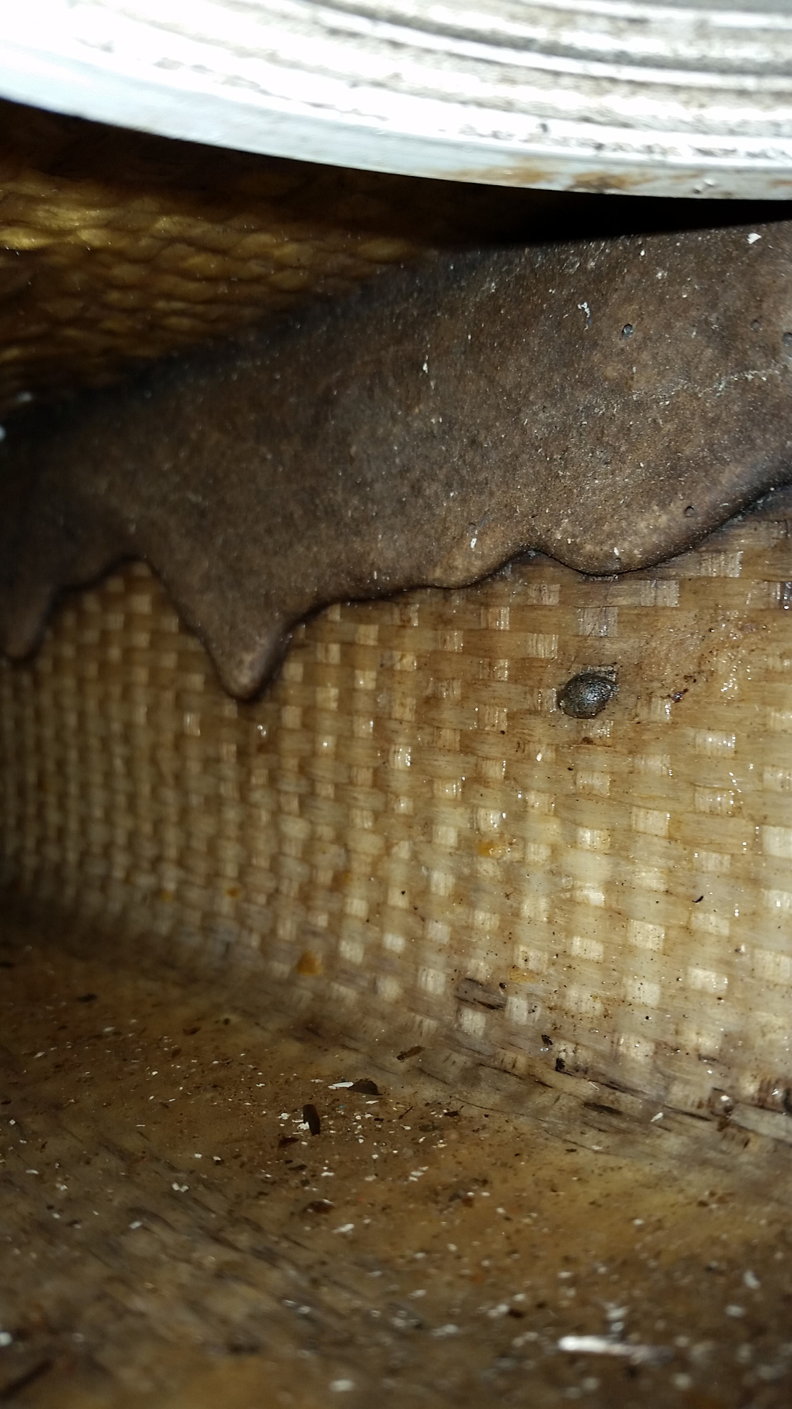

On the Westfield I just picked up, one of the prior owners put two 6" inspection ports (flanged screw in type). One just in front of the drain well and one under teh bow. I opened the rear one yesterday. It looks like the stringers are glued to the floor with something similar to a construction adhesive.
I'll see if I can get a picture of it tonight. I should be able to stick my camera inside and get a picture up underneath.
Good luck!
Re:1963 MFG Edinboro Floor 11 years 1 month ago #115299
Thanks kofkorn, if nothing else, I'm curious about what it looks like under there. Say, does anyone know how far forward the foam goes? Does it fill the entire floor front-to-back, or does it start at the stern and go forward a certain distance?
Re:1963 MFG Edinboro Floor 11 years 1 month ago #115305
I was able to get in quickly, but due to the foam, I couldn't see too far back. Also, now I know I need to clear out my foam too. Anyway, it appears the stringers are built into the exterior hull and then glued/bonded to the floor above.
Good luck and post pictures to help the rest of us!
Re:1963 MFG Edinboro Floor 11 years 1 month ago #115320
Thanks for posting the pictures, that helps a lot!

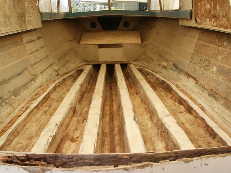

Well I never back away from a challenge I'm on boat resto #9 right now but, I agree on the wet foam as a possible show stopper on these.
Ironicly the bottom/ floor/ stringers are built too well to be easily removed as the structure is usually fine it's just the foam. Too bad they did that, it does make the boat quiet though. Glasspar also used the corrugated stringers but did not foam fill so they don't suffer from water logging. I live in New England too, Massachusetts, I would also be concerned what that freezing water has done over many winters. You can still find cream puff MFG's out there but it might take a year or so to find one. I'm sure transom core is junk too.
If you do the boat I don't see how you can remove the floor but you could save most of the stringers. Circ saw through floor and the stringer top cutting strips above the stringers so you have channels to dig the foam out.
Foam is only on the corrogation between the hull and stringer top not between stringer bottom and floor, at least that's what catalog shows in the cut away.
Once it's all out its up to you to refoam or not but there should be new glass used to reinforce the now exposed stringer edges. I would either try to tab back the floor strips and glass over the whole floor or bond plywood sheet down and glass over.
Plywood should be glassed before bonding it in, I would think 3/8's or 1/4 would be fine it will be well supported.

Yep, I would love a nice dry floor, but alas, have not found one. The foam is remarkably soft with all the water in it. I'm going to play around with ways to remove it without cutting up the floor. I will post the things I try. The boat was darn near free, and so far I have just put some time into it. So it has not become financially expensive (yet).
I think you are correct that the foam is only in the spaces "between" the stringers. I am estimating its around 3 cf of foam, which would be just shy of 200 pounds. Lots of weight in a 750 pound hull.

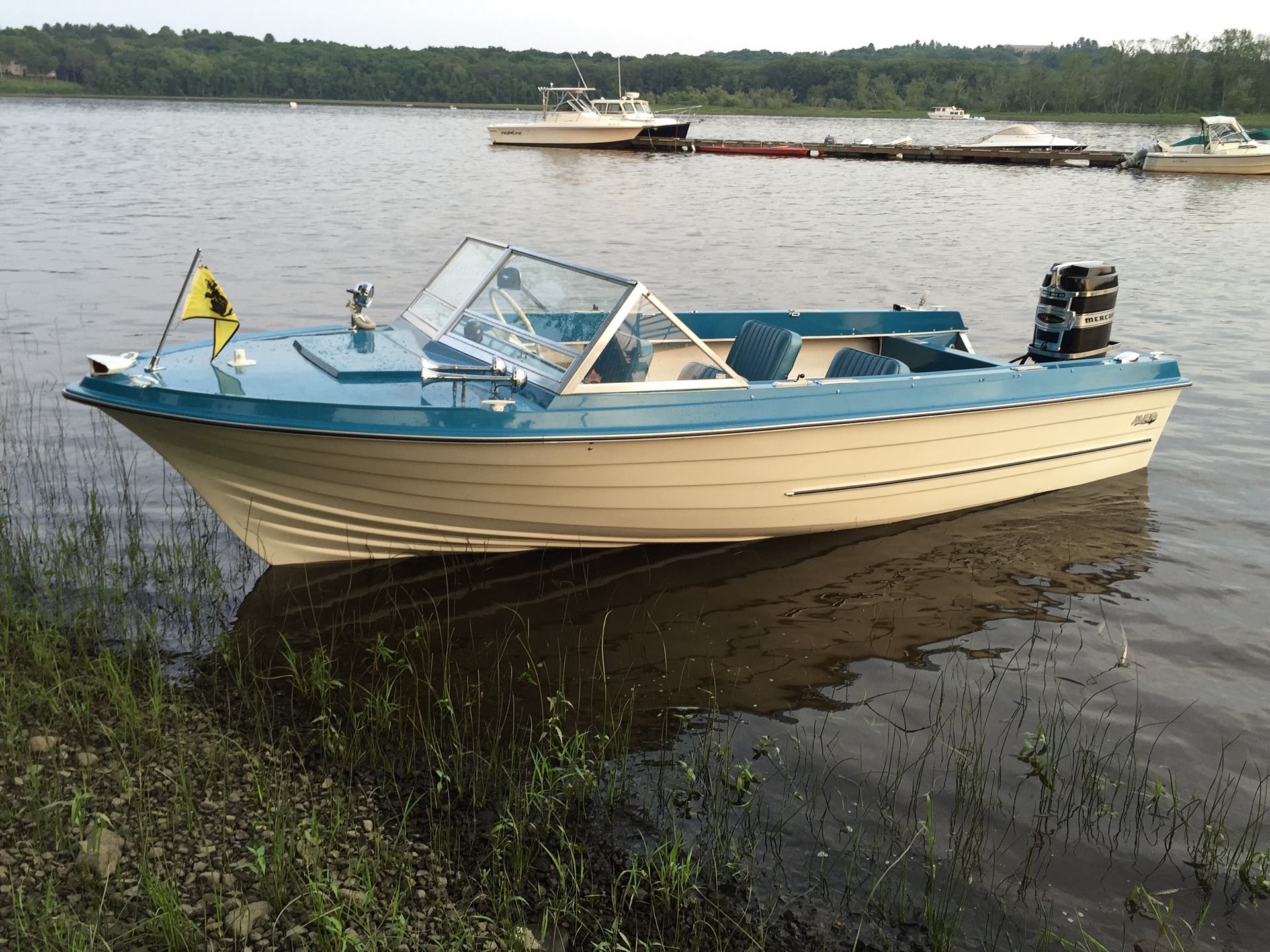

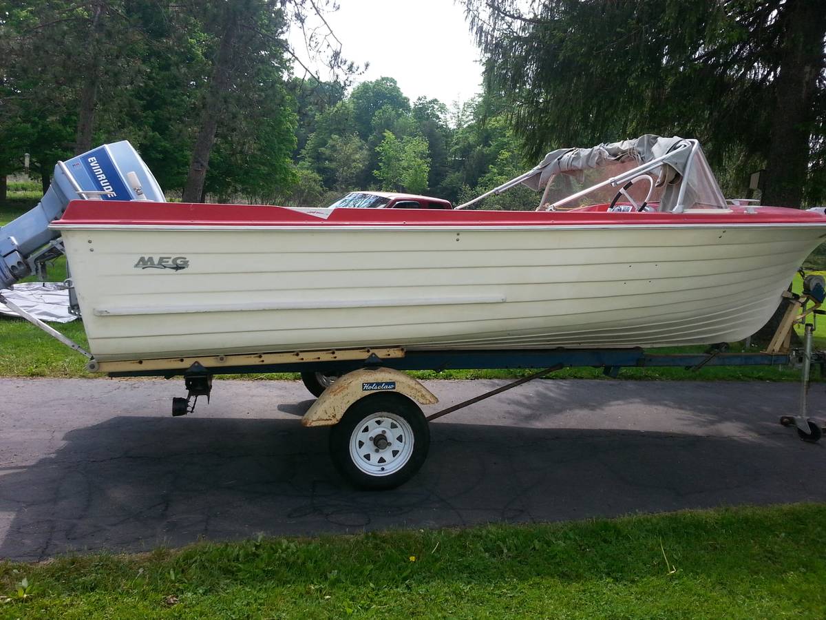

Ha that's my Edinboro! Sold it fire sale to make room for the MFG Erie picture attached, I just had to have, otherwise I would have never parted with it. You will see I post here on occasion. I live in Massachusetts and boat went down South. It sold on eBay, that listing you saw must be a site that gathers stuff from everywhere and agragates it. I never get any messages even though it looks like people are adding questions.
There are two perfect MFG's I've found forget if west fields or niagras but are mint original, one is in the glassifieds. If looking to ship try Uship.com I've used them quite a bit, things don't always go to schedule but in the end it always worked out.

Re:1963 MFG Edinboro Floor 10 years 5 months ago #122755
That is one very nice Erie. Those are really hard to find - a blue one in that shape next to impossible.
I can see why you had to have it!

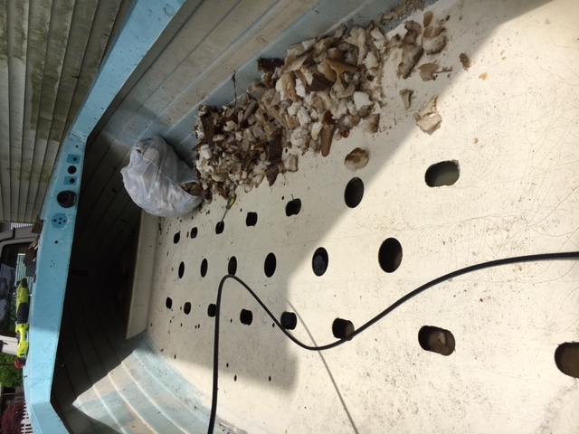

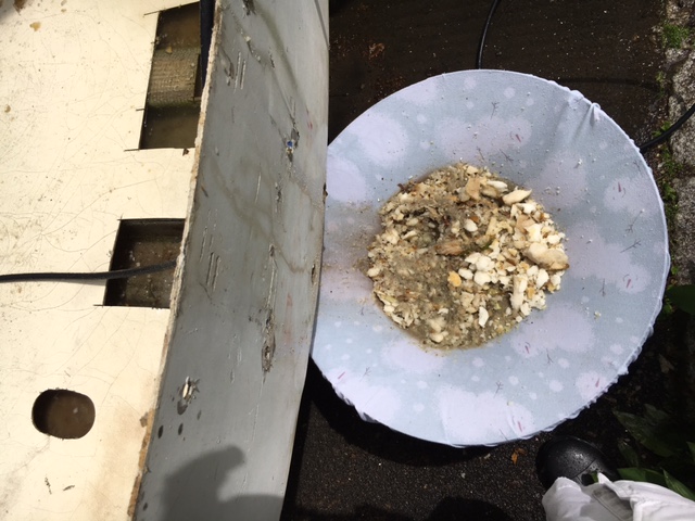

The foam is out! That foam holds a LOT of water. I cut holes in the floor between the stringers, in the three channels that have foam. Then used a screwdriver and a pressure washer.
That Edinboro looked great!
Re:1963 MFG Edinboro Floor 10 years 5 months ago #122881

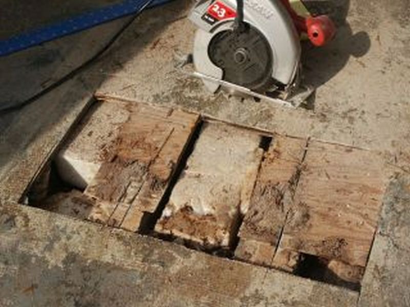

OK, finally found a way to get my photos on here. This shows the holes in the floor for the foam-ectomy
The following user(s) said Thank You: charlieross
Re:1963 MFG Edinboro Floor 10 years 5 months ago #122882
I was able to get a lot of the foam out in chunks, but I also used a pressure washer, which chewed through it. I put a towel on a rack at the stern to catch the shredded (practically powdered) foam as it drained out. A slushy mess. One of the things I found that I was surprised at was how much the foam was blocking drainage. Even if the foam was not saturated, it would seem to keep a lot of water from draining.

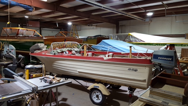

My windshield is bent in one spot where the previous owner lost his balance in waves and fell on it, bending the frame. I'm going to try to bend it back, but if not, I'll try your route and get a new one.
Right now it's in a restoration shop getting a new transom, fixing the cracked motor well, plus getting some repairs done to the keel. I plan to do the deck, windshield, seats, and redo the white plastic-coated hardware.

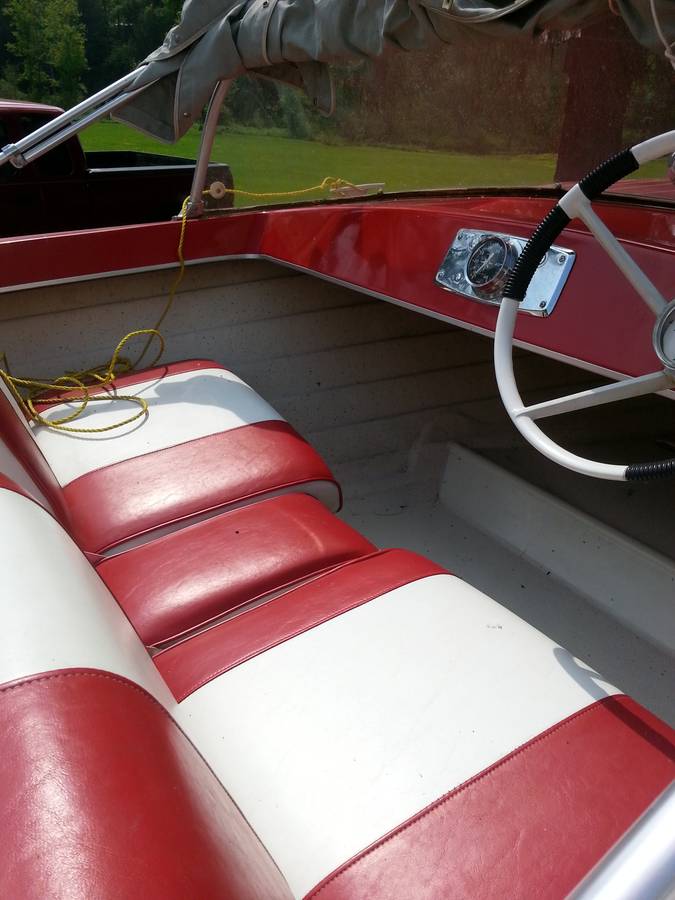

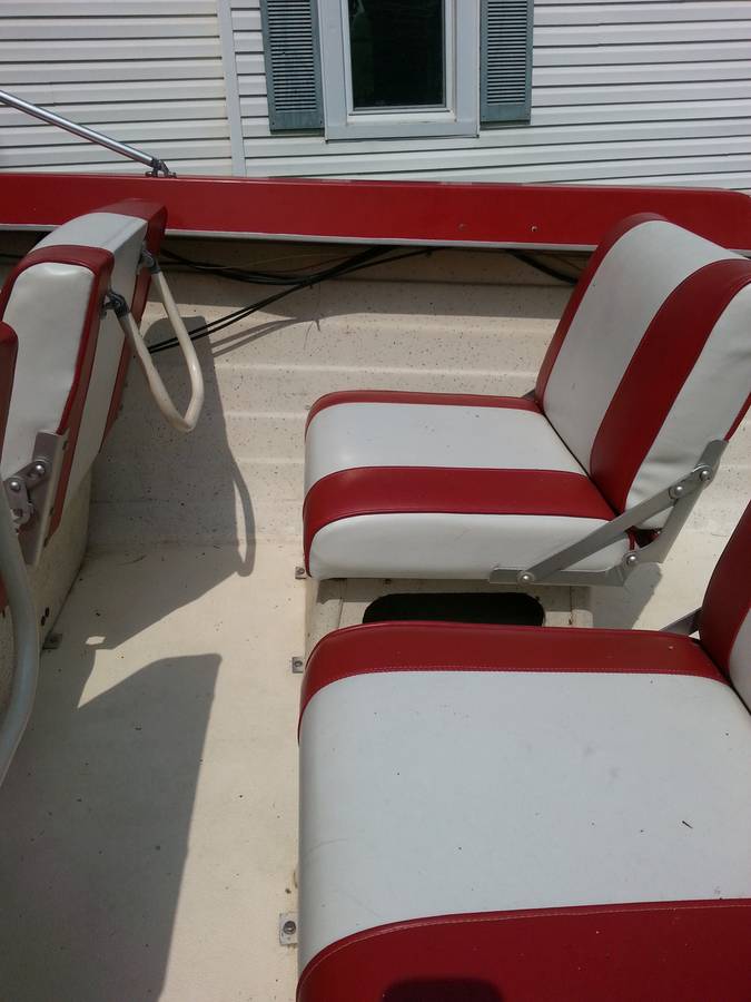

I have all the hardware, plus the complete Sun 'n Fun seats. It was really hard to find a red Edinboro that still had the original seats. My Dad bought his first boat in 1963, a new red Westfield, and I always liked that boat. It had the white and charcoal seats used that year, but I like the red and white seats in this one even better. This is the only Edinboro I found with a red deck after looking for three years, so I got it, even with the significant repair and restoration it needs.
We'll find out soon if the floor foam is saturated once the inside of the transom comes off. Going to use Carbon-Core CarbonBond (like Nidacore) for a new transom - you mix then poor it.
Here's some pictures of how the seats look now:

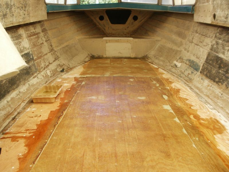

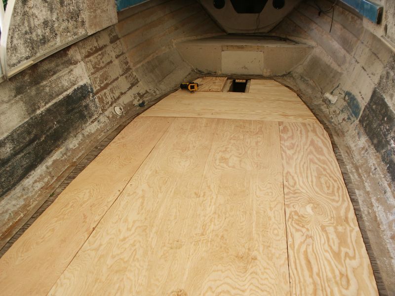

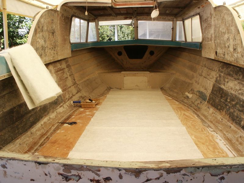

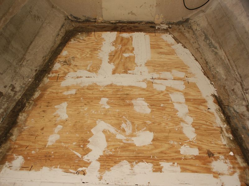

Re:1963 MFG Edinboro Floor 9 years 11 months ago #129145
replacing the floor, well from what i learned here i attacked the floor and foam problem. new at it but confident with the help here i could make it. first of all set your saw a little less or at 3/8" to cut just through the floor but not into the stringers cut across from port to starboard just two or three inches wide. this will mark your stringers pop a chalk line and cut in between the stringers they are hollow fiberglass .. so if you damage one you can fix it with no problem. mine had screws i dont know if that was factory or after but i pried the rest off the stringers . bought a belt sander and dressed up the stringers . i left a lip down to blend the edges back . i bought 3/8" marine grade plywood. and i took a compass and drew the edges to match what i had left. i flipped the plywood over and anywhere i might screw something down , seats cabin walls batteries , anything i laid a piece of 3/4" marine plywood .. to build a plate to screw through ... then i coated it with resin. top bottom sides. now some say leave the foam out some say pour foam. i had gotten some dock foam to lay the boat on off the trailer. i tested it and then cut it up and filled the bilge back with it. for sound deadening and flotation. then i added backing boards where the sheets overlapped . laid a good line of 5200 down and dropped the floor down screwed it to hold it to the 5200, but i know some who use resin to coat the stringers and put weights down to keep screws out. * note when i took the floor up it had a layer of glass on the bottom side too. i just coated mine. some say seal the bilge up some say you cant i cut an inspection plate into to keep an eye on it. after the floor was down i went back and filled the cracks in with gorilla glass and filler putty . then i laid two layers of roven back down. that is what was there before , i saved a piece of floor to go by . i ran the glass up the sides about 6 inches . i have a lot of pictures but i wont post but a few, if you want more let me know my love for photography overtook the love for boats. here are the basics. hope you can benefit from the rant. * note one thing i would do now is i would paint the bilge area with some bilge paint just to clean it up but also to keep whatever gets in there moving instead of sticking to bear fiberglass .. just a thought.
billy

Fantastic Billy!!!! Your idea of the inspection plate is a good one. I've had a few MFG's and put one up under the bow on the raised floor area. I do this on all my resto's now, almost all the boats I've done have this similar raised area under the bow, or I make one.
Cautionary: Something to consider is a small diameter vent pipe to let the underside air pressure equalize as temperature changes as air expands and contracts with temp. MFG did this with a small rubber tube glassed in somewhere. I've seen it in the transom corner and along the v of the bow. I use small dia pvc conduit so you can bond to it to seal when duplicating the vent pipe. Another possibility is to simply drill a small hole in your inspection cover if it's up high where water won't sit? That's why I mounted my inspection cover up high in the bow. I used the screw in type cover so It can be a little loose so the o ring does not seal but eventually I drilled a small breather hole in the cover so I could snug it in place and still provide a measure of breathing. You don't need a big hole to vent, mine is only 1/4 inch which is a tad larger than the inside diameter of the original rubber vent hose I eliminated during my transom resto's.

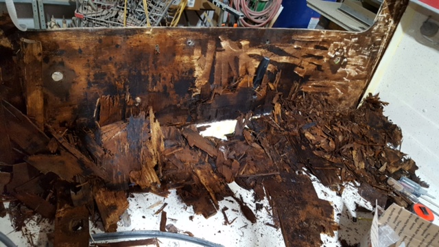

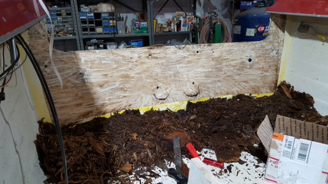

So my transom has been cut on my 1962 Edinboro and all the old plywood (a curious mix of mahogany and other woods) is gone. I'm paying a professional boat restorer to do this, the splash well and the keel. I plan to do the rest of the work. We cut the interior skin to create good access, removed all the wood, will tab and glass it back, then pour in a CarbonCore CarbonBond (like NidaCore) transom into the empty form of the skins.
The keel and splash well are straightforward repairs. The big issue is the water saturated foam under the floor. The original seats are with the boat, intact, so I thought I was good on the floor. However, the previous owner at some point drilled a hole into the floor at the stern and water got in that way, something I missed before buying. Going to weigh the boat after the transom is done, and figure out how much the whole thing weighs vs. what it should be - about 750 pounds, then will decide from there. If not too much weight, this may be a repair for another time, if ever.
Here's pix to date:
