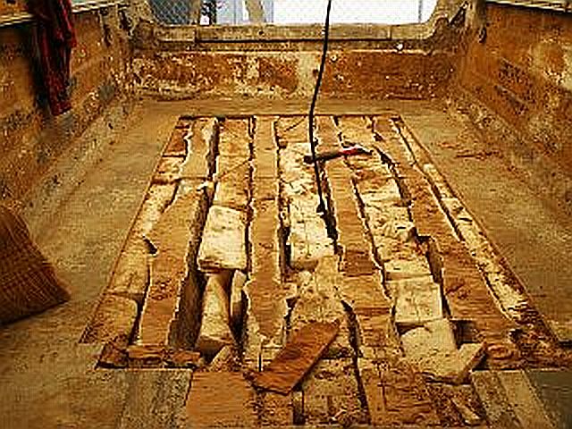

pictures i know the older ones have glass stringers like 4 inches wide at the top and taper down about 6 inches tall. i would like to see cabin pictures i am rebuilding mine 60 sea cruiser 21 foot and my cabin was at the most on its last leg , so get a few pictures and i was told to drill a small hole about the size of the coat hanger then probe down to see how much space you have between the floor and the hull that will give you an idea of what you have under there and if it is like mine the foam was water logged ... soaked so pictures get to the top of the list around here.
