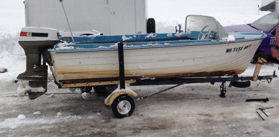

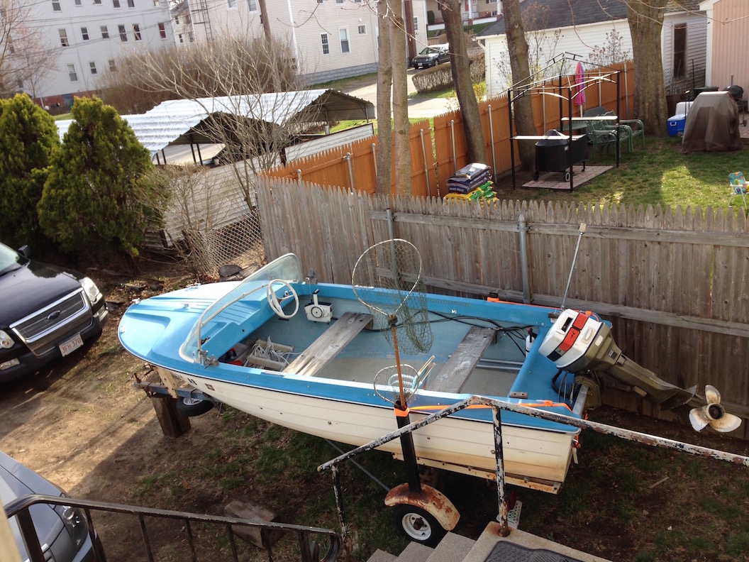

Hello Guys,
My name is Mike, I am 31 Years old and a first time boat owner.
First of all I have just bought my first boat. I grew up on the lake and my dad had all sorts of boats growing up but they were never mine. So I started looking for one in January and found someone who wanted a bigger boat and was getting rid of this. I didn't want fiberglass at first, cause I just wanted to use it for fishing.. But when he told me his price of $300.00 I had second thoughts one for the price the second because I have 4 kids.
I finally got it last Sunday. The kid who had it did not know what kind of boat it was and on the reg it said MISC, after about 5 minutes of looking over the boat I found the MFG symbol on the windshield and also on the plate with the serial number. I looked it up to find to my surprise its a pretty rare boat! Its a 14ft 1966 MFG Niagara, it came with a 1973 50HP Johnson Evenrude that was pretty much rebuilt except for the carbs and a Holsclaw trailer model a-900 that I cant find any information on.
It has no real seats and no ski racks. it also has a new bow light that only has 2 screws instead of 3. Im gonna restore her as I have already started the process. But I'm gonna keep the "bench" seats and cover them with white marine vinyl and foam to give it that nostalgic look. I am also going to put in a Fish finder and trolling motor as well as a fuel water separator and update the steering wheel and cables cause there still on pulleys and there illegal here in RI. Im gonna paint the bottom of the boat (Inside) White and the sides of the boat on the inside the color the boat is because its easier to clean and i think it will look nice as well.
I cleaned her up and re wired the entire boat just because. I named her Irene after my grandmother who lived on the lake I grew up on for 50 years. My dad passed away in 2010 and I know he would have wanted me to name her this My dad was a huge boat guy!
I attached some pictures but I will definitely take some more detailed pictures for you all to see
So I have some Questions.
Does anyone know what the original Bow light was called? It was much bigger and had 3 screws. Looks kind of like the end of a horn.
There is a place right in front of the windshield in the middle where something was once attached? a Horn?
Does anyone know where I can find the Dash trim that said MFG Niagara for the passenger side of the dash?
Does anyone know where I could get the windshield replaced or repaired?
Does anyone have any idea if the Hull grommets for the old seats, will they fit the new style seats? like same bolt pattern?
Does anyone know what the top paint color is called for this boat?
Does anyone know where i can get a boat cover for this Boat?
Thanks guys! I read so many great things on this sight that I had to join in on the fun. I hope you all can help me out! Look forward to your responses!

Congrats on your first boat. It looks great, and ready to use. Have fun wit it.

I can help, I have one exactly like yours - same year, model and color. Both of our boats are the base model and they came with MFG-made back-to-back seats from the factory, with no ski racks, but did include the splash well that year. Obviously a previous owner removed the seats and installed the thwart seats. This model never had that style for seating, but if you like it, go with it. Niagara's were MFG's most popular boat at the time and are pretty easy to find, especially in Ohio and Pennsylvania, where there were lots of MFG dealers around years ago.
To answer your questions:
MFG used these lights on a number of model and went to a chrome hardware rather than the previously used white-coated hardware on this model in 1966. You might be able to find one on ebay or from a donor boat. I still have the original chrome hardware, including the light, on mine.
There should be a cleat on front of the middle of the windshield area. If your cleat is there, then a previous owner mounted and then removed something else - maybe a horn or light.
That will be tough - you would need to get one from a donor boat or have one made. I still have mine there - if you can find someone to make one, I could get the dimensions and take a picture of it.
Yours does not look that bad from the pictures - what is wrong with it? The original Taylor-made windshield is out of production, but there are companies out there that will make a replica, or if the frame and white gasket are still good, try polishing it if is scratched and hazy.
Not sure I know what you mean here.
MFG called it Horizon Blue. MFG never used paint - it's gel coat. Try polishing it out - instructions are on this website.
You can get covers most anywhere. I got mine at Walmart recently, but I have not tried it yet for fit. I'll let you know how it works out.
