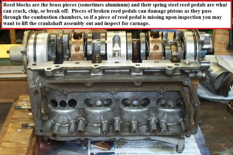

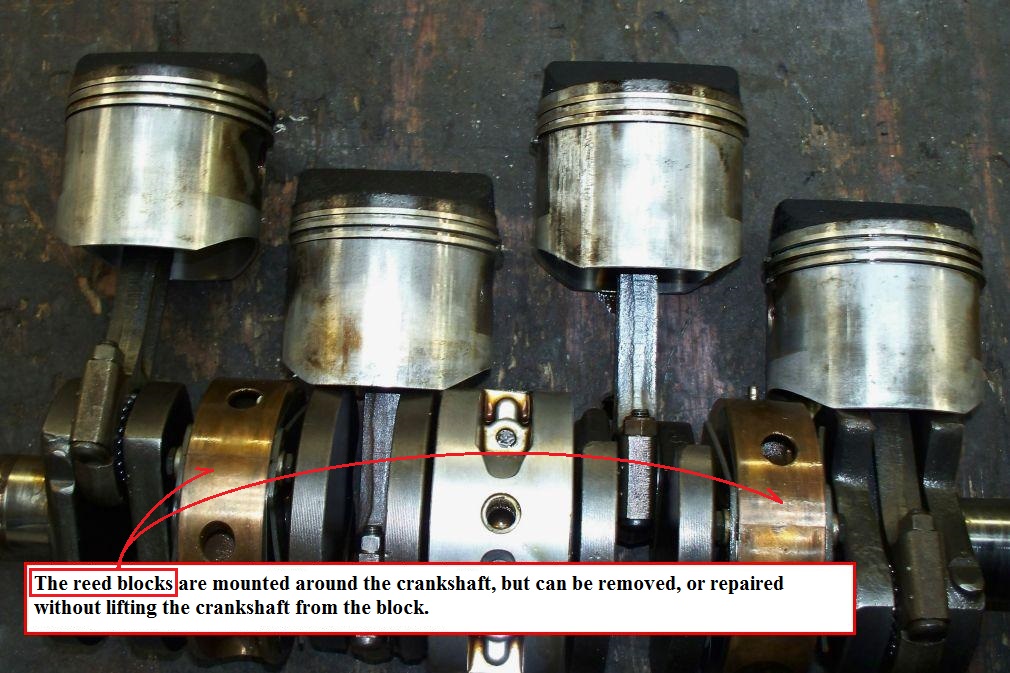

I'm not sure if Boyesen makes reeds for the 650 4 cyl or not. If they are the same as the reeds in a 1000, then 'yes'.
A typical symptom of a broken are damaged reed is a mist of fuel mix being spit out the throat of a carburetor. Use of a bright flashlight or a piece of glass held out in front of a carb throat to 'catch' gas spit are a good way to see if a reed pedal is damaged.
If the beast seems to be running fine at around 1200-1500 RPMs, but begins to act up at a lower idle speed, I would try opening the idle jets a bit and see what happens.
Typically (at sea level) the 650-4 idle jets should be happy somewhere between 3/4 turn to 1.25 turns c-clockwise from gently closed clockwise.
Idle speed on water muffs should be set at somewhere around 1000 RPMs, as once the motor is down deeper in the lake water back pressure on the exhaust will pull the idle speed down to around 850+/-.
You may eventually find you can slow the idle speed down out in the lake, but for initial tuning-troubleshooting I recommend setting the idle at 1000 RPMs on the muffs.
IF the results of the tests conclude a fractured reed, we can walk you through the labor intensive 'heart surgery' required to replace the reed pedals.
