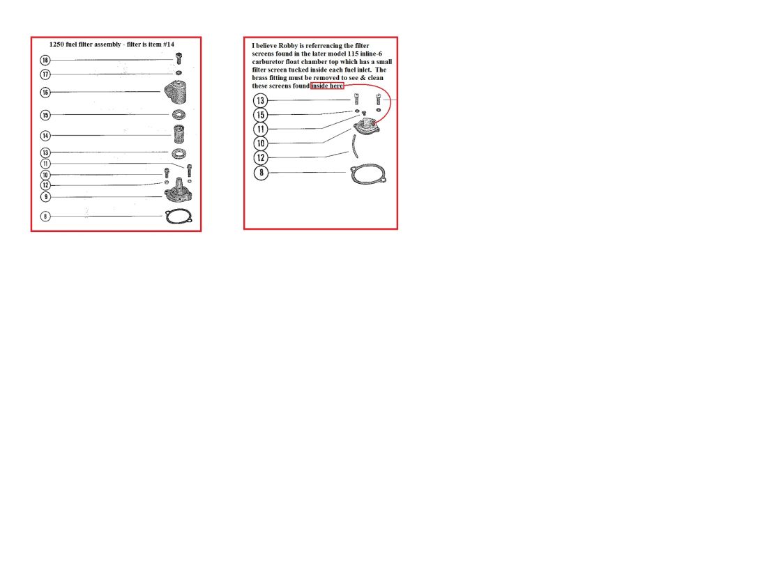

I don't think I am going to add one for fear of more restriction. I am going away for a few days and then I am going to bring it home so I can get a better look at the carbs. do you have a pic of the filter that is on the carb that the other guy was talking about doc.

Re:Fuel starvation 12 years 2 months ago #99538
Here ya go gents! :)
doc

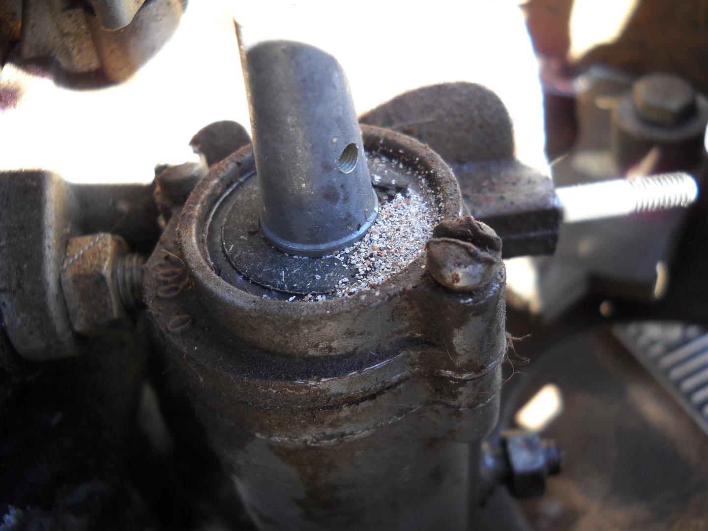

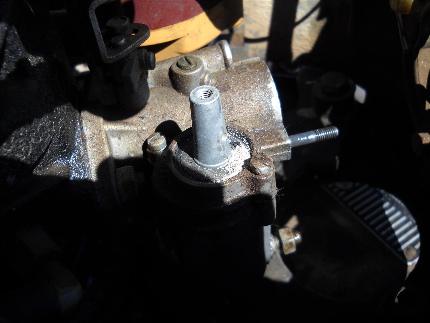

Re:Fuel starvation 12 years 2 months ago #99560
The carb in the illustration looks similar to those on my 1964 650. One caution, when you tighten bolt #18 that holds the cover #16 on, go easy and careful. Seems the area that the bolt threads into in part # 9 has a habit of breaking if the bolt is overtightened. Photo is the filter area on one of my carbs when I took them apart. Hard to believe but it was still running OK, but I cleaned them anyhow. Looked like beach sand. It had accumulated in the "before" side of the filter screen.

Re:Fuel starvation 12 years 2 months ago #99572
they don't break because of over tightening but because the cover is sitting on the edge of the top and cocked. so it is pulling sideways.
