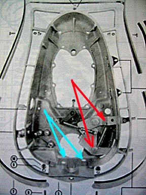

Discovered that if I turn the alternator a bit furter the idle goes down.
Is it possible to put a retainer on the alternator that pull it a bit furter to loow idle?
Re:Mercury 350-61 16 years 4 months ago #10449
all my magnetos have a return spring on them to help returning to idle
hope this helps

Excactly where should the retainer spring be placed?
Re:Mercury 350-61 16 years 4 months ago #10657
the throttle /mag actuator arm should have a hole in it already
if I run into a stiffer linkage mag tower, whatever and its not mine to tear apart I hook them to the cowl holes if there
