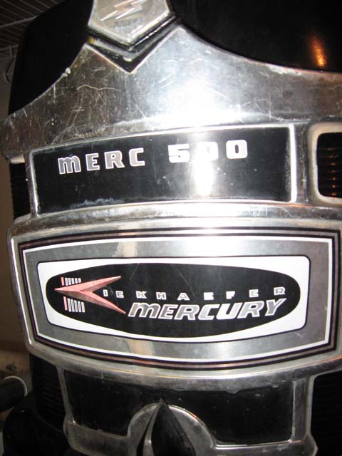

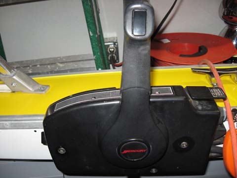

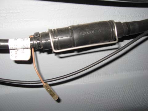

I've got a '67 500 Thunderbolt with no instrumentation. I believe the controls are a later model than the engine. There are wires coming out of the control- Brown, black, purple, tan/blue stripe, and gray. The are not connected to anything. There is a harness that is plugged into the motor and everything works fine.
Can I get a tach and temp on this motor? Are the wires from the control of any use to me in this? I've included photos for reference.

In 1967, there were manual, starter, and electric model Merc 500s. Both the starter and electric models are electric starting, but the starter models do not have a charging system and in 1967 used a magneto ignition. If you have an electric model which has breaker-less CD ignition, the tachometer installation will be much easier. I am unsure if the adaptor harness your motor appears to be equipped with (to allow use of the very recent remote control box) allows for the tachometer feed with the new control. This can be checked simply by checking the gray wire at the remote control for connection (using a VOA meter) with the brown wire originally attached to the (4) terminal side of the ignition module inside the motor's cowlings. If so, the gray wire is the tachometer sender wire. The black is ground, and the purple is 12 volts when the ignition key is in the "on" position. The easiest would be a modern tachometer which reads a 12 pole alternator charging system. The gray, purple, and black are the three connections needed for operation at the tachometer. Inside the motor cowlings, the brown wire should be removed from the (4) terminal side of the ignition module, and then connected at the charging system rectifier to either of the yellow wires (do not connect to the red wire terminal). This will yield a functioning tachometer if the charging system is working properly.

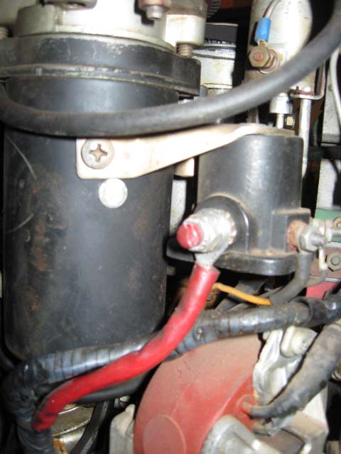

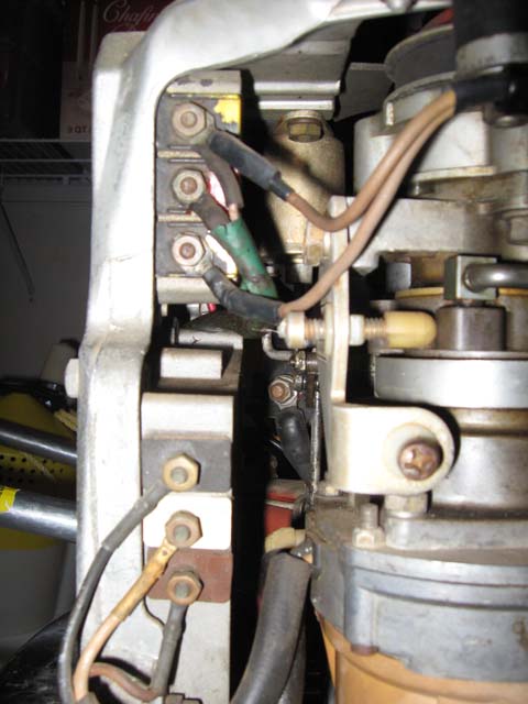

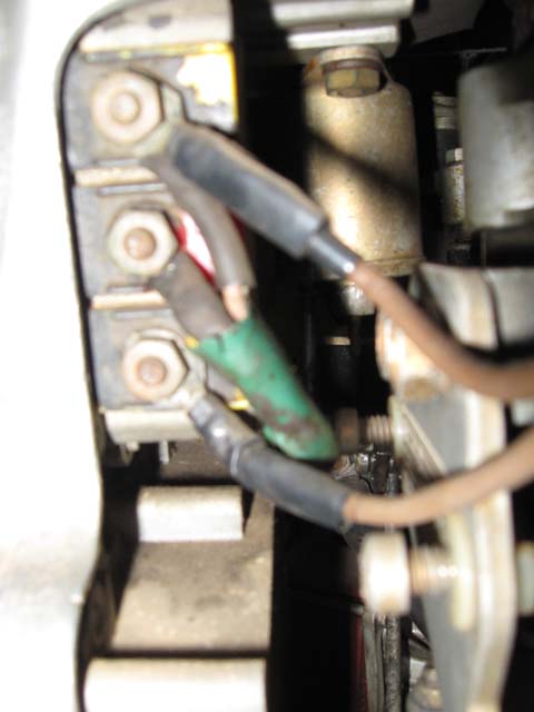

Because of the vsriety of ignitions used on the 500 a few pictures would be helpful.

Thank you all for your replies. Perhaps the attached imaged from under the cowel will help determine what type of ignition I have and exatly which wires to tap. The images are: Cowel plate, port side, port side top, port side bottom, and starboard side

Your control appears to have a trim/tilt switch (rocker switch) in the handle. If so, the wires under the key are probably for the switch.
