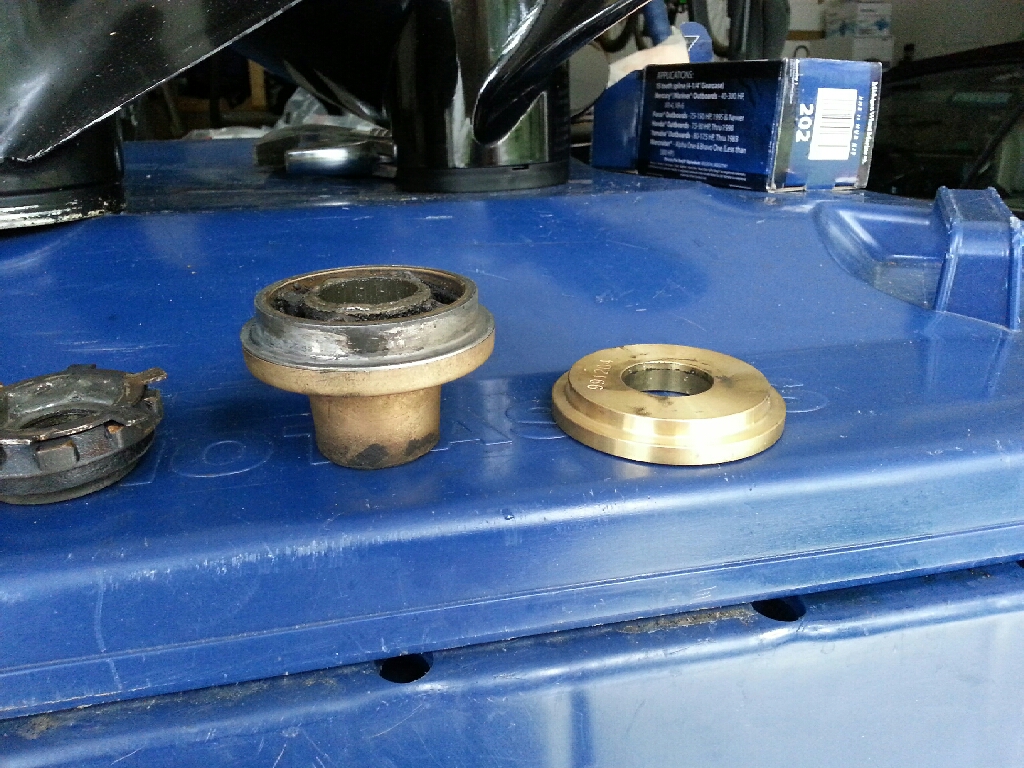

Thanks to everyone for their input. I've been struggling with this for several years. Just haven't taken the time to do anything about it. Now I have a new problem. Ordered a 13.5 x 15 Vortex prop and XHS II 202 Hub Kit. There is a huge difference in the shape and length of the original thrust washer and the one that came in the kit. The new prop is longer in the body than my originals, so I figured that was why the new thrust washer is shorter. The problem is that the new prop sits below where my threads stop on my drive shaft. With the nut tightened all the way down, there is still about 1/4"-3/8" play where the prop will slide on the shaft. Anyone ever run into anything like this? This is supposed to be the right hub kit for this motor, but now I'm wondering if this is the original lower unit that came with it. The picture I'm attaching shows both of the thrust washers.

Here's the pic, hopefully.

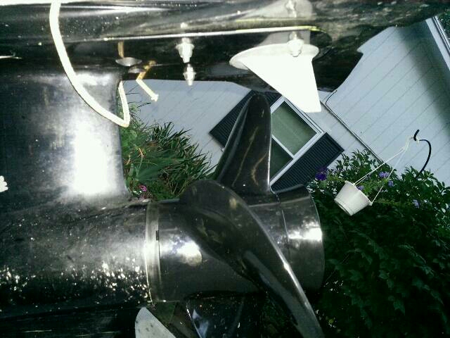

Played around with it this afternoon. If I use the old thrust washer, it looks like it might work. The front edge of the prop body sets just inside the cavity on the gear case. Not quite as far as the old prop, but I think far enough to channel the exhaust thru the prop like it should.

The drive shaft on this one is tapered. Don't know if the lower unit is original to this motor. The two thrust washers in the picture (old one on the left) just had me puzzled. The new one from the hub kit (that is supposed to be for this motor) sits too far down in the gear housing, since it doesn't have the longer sleeve that the old washer has. The new prop won't even touch it. It bottoms out in the housing. I tried the old washer with the new prop (see photo). Have sent pics to rep at Michigan Wheel to see what their take on this issue is.

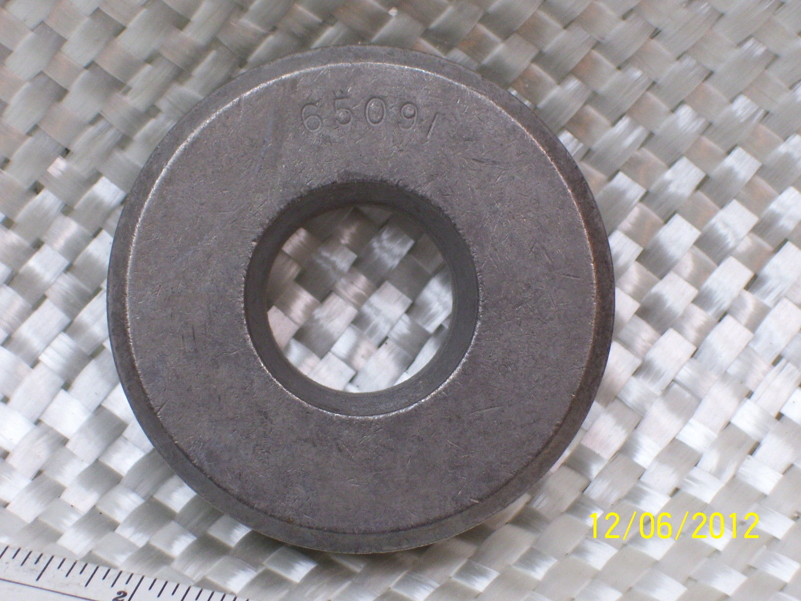

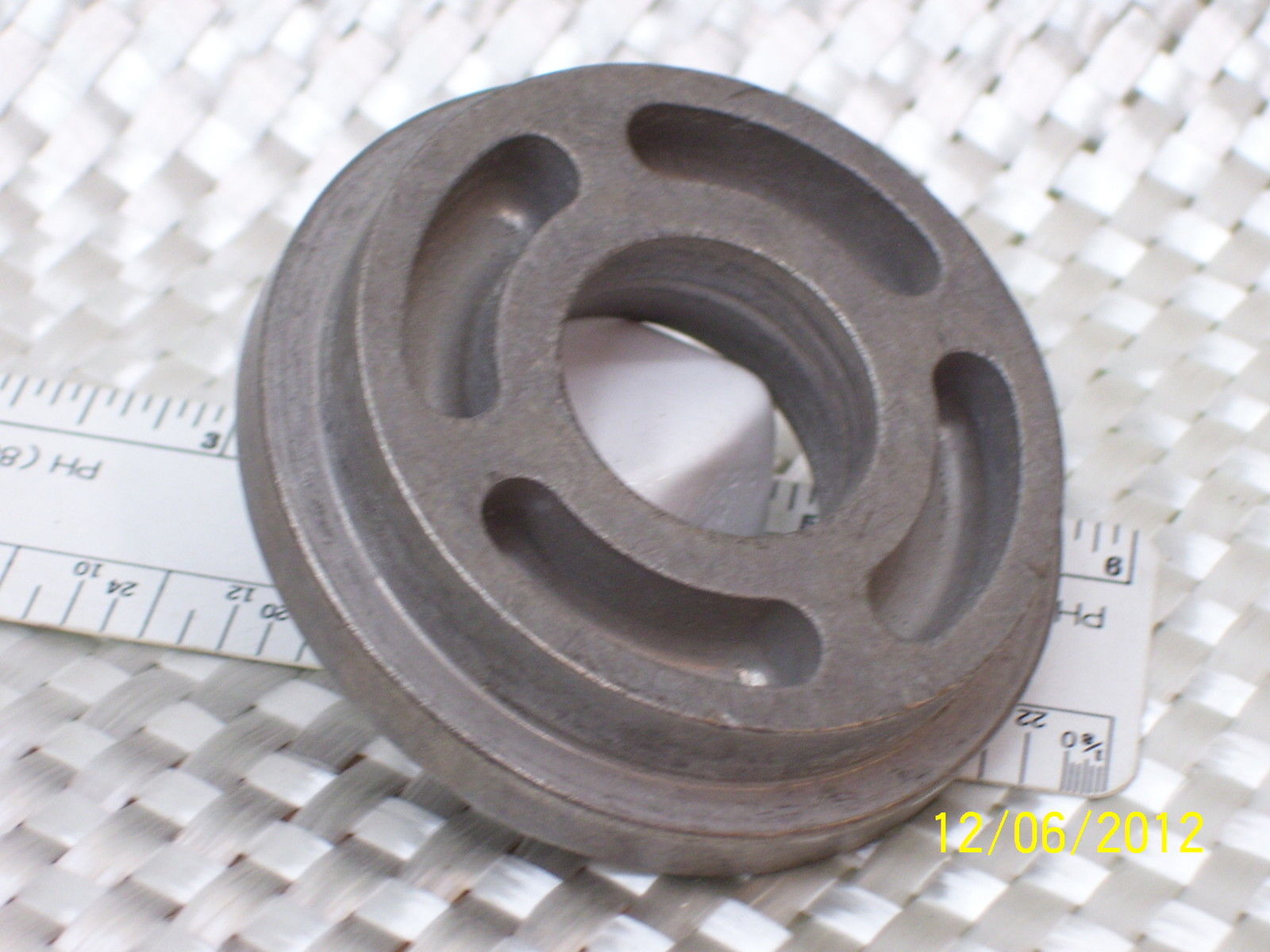

Do you mean the prop shaft is tapered? I.E., it has a beveled shoulder where the propeller thrust hub sits?
If that's the case, the old-style hub with the long "snout" isn't meant to be used with the bevel. You'll note that the newer-style flat hub has a bevel whereas the old-style has a square shoulder. The old-style propshaft had a square shoulder.
Around '65-'66 (as I recall), Merc changed to a beveled propshaft and the thrust hub changed as well. It looked like your old-style long-snout thrust hub, except the "snout" was cut-off and the end beveled.
If your new prop has a completely flat back, it should be using the new-style flat hub and if that's not stacking-up properly to your lower unit, there's something wrong.
If the prop has a shoulder where the old-style thrust hub would fit, and your propshaft has a beveled thrust-hub-edge, you need to be using the shorter old-style thrust
hub, which is a bit thicker than the newer-style flat hub.
Part number for this thrust hub is 65091 and it's been superseded a few times. Here's a very inexpensive NOS part on eBay:

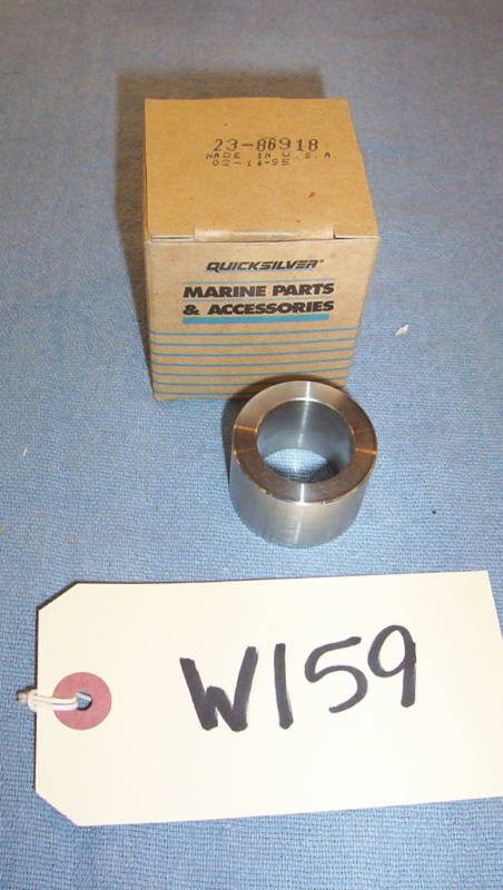

Here's another option: if you do have a square-shouldered prop shaft, there is a special spacer which is used with a "modern" prop along with the later-style flat thrust hub: P/N 86918. If you need one of them, you should be able to find on on eBay or at www.marineengine.com
I've attached some pics which may help.

That being the case, the spacer should fix the problem. There's a really good deal on one at eBay, check it out:
Cheapest one at marineengine.com is $21.80 + shipping, so the eBay item is a $$teal!!!

Just got the thrust washer spacer and it worked like a charm. New prop sits right where it should. Now to get it on the lake and see if the prop will stay in the water.
