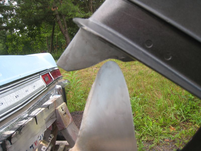

I've got 1/8 maybe 3/16 clearance here for this SS chopper blade. Is that sufficient? SS - no flex right?

I'd give it more just to ge safe.maybe 1/2in.

Re:SS prop anode clearance? 16 years 4 months ago #9941
heres what i did to mine Frank .
Re:SS prop anode clearance? 16 years 4 months ago #9943
I think i would clearance that tab out just a bit more(maybe another 1/4 inch up and a 1/4 inch back or so)...i would imagine spinning a prop that fast, even with a stainless one, could easily flex more than an 1/8th of an inch. Would REALLY suck to ruin such an expensive prop!! :S
Re:SS prop anode clearance? 16 years 4 months ago #9951
Here's what I ended up with. Also, found a # on the prop, 48-61902. 14" diameter, 22 pitch. Cupped two blade. Try it out tomrrow night. Wish I could tonight, but potential weather, and lateness of dinner make it not a good night.

Re:SS prop anode clearance? 16 years 4 months ago #9952
looks good now.

Re:SS prop anode clearance? 16 years 4 months ago #10293
  • 63g3
  • Posts: 465
  • Karma: 62
The anode should be flat for these props, remove the fin completely. It has NO effect as these props should be run on a motor where the cav plate is above the water, so the anode is not in the water at all at speed. If you can't run the motor high then this is not the prop. It's looks like an older Merc "elephant ear" Good bow lift etc. but the newer three blade lasers or equivalent would be better still. that said it's a great vintage prop form the early 70's.
