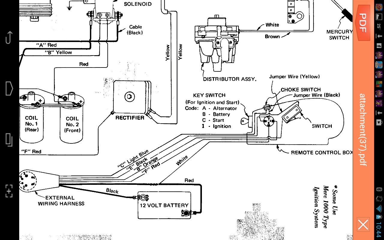

Hi Merc guru's need some help identifying if the black wire is indeed attached to the (I) (ignition)terminal of the switch with a jumper to the choke button??
As I'm wiring a newer switch old one is toast! And I'm not getting spark now! I've left the black wire unattached to any of the new switch terminals is this one of many reasons to cause no spark ??
Thanks in advance!!
Dave
Re: Is this wiring correct ??? 12 years 3 months ago #98712
MY book says yes black to I.
Re: Is this wiring correct ??? 12 years 3 months ago #98713
Hey thanks Dave cool name :-P
Guess that's the source of my no spark lol as I left it unconnected I hope at least
