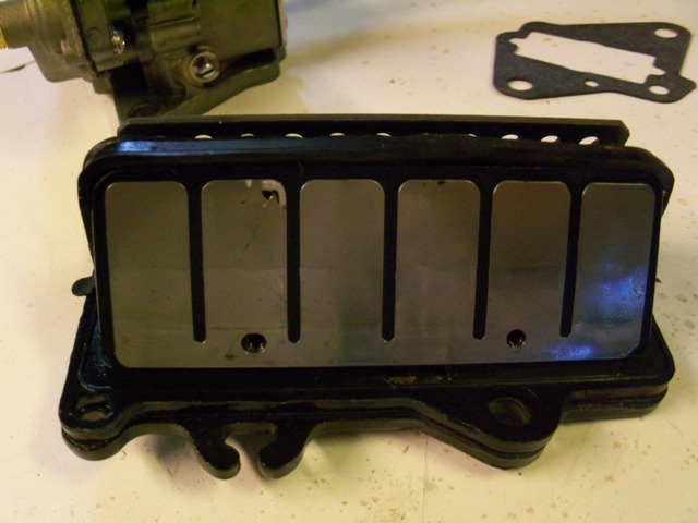

How big of a piece of a reed peddle was missing?
Are the peddles spring steel or fiber?
Is the missing piece large enough to block an intake port or cause internal carnage?

Reed piece was small, but steel.
I will post a pic.
Thanks Doc.
[img][img]http://www.fiberglassics.com/media/kunena/attachments/legacy/images/reed1.jpg
