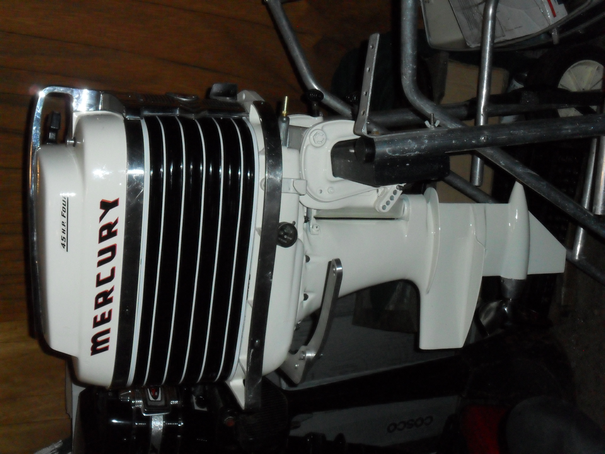

here is my brought back to life . I made a one of a kind merc 400 Q.KG9Q tower and lower 400 cowls and wrap 500 power head. Great feeling doing 63MPH
Re:It's ALIVE!!! 12 years 3 months ago #98351
Nice Dave. good that you know how to mix and match to get what you want.

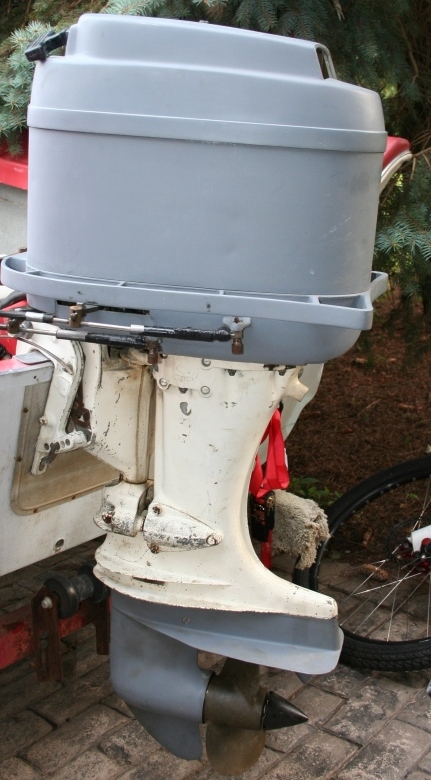

Well....the happiness drained away after I got it to the lake (river actually). I should have known that rushing to complete it would not be a good thing. On my last post I mentioned that we got it running. That was very late at night the day before going to the cottage for vacation. Once I had the time to try it in the river (and not in the bucket in the dark) I found that it was leaking gas at the carb filter and that it wasn't peeing. Not having the tools or the time at the cottage, I parked it. So now, hopefully over the next week or two I'll have the chance to go back to the drawing board!
Here is how it currently looks. (The mid section is from a Mark 35a I picked up for parts. I didn;t have time to sand and prime it yet)
Dave, that is an awesome looking Merc you have created! I hope mine will look even have that good someday.

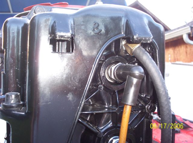

SO,...If the block is not getting hot and you are still unable to get a pee stream, I would recommend moving the tell-tail exit port to the top of the block.
There you will find an 1/8"NPT male plug that is removed either by a regular screw-driver or a 7/16" socket that makes an excellent tell-tail exit. Simply replace the plug with a 90 degree male fitting that is barbed for push-on hose that can be routed out one of the (2) unused 5/16" diameter holes in the aft area of the engine pan.
I go a step further and thread the hole in the bottom of the pan with 1/8"NPT and thread a straight fitting (with a male barb fitting on the 'top' end) down into the hole, and then thread another 1/8"NPT male by 90 degree male barbed fitting fitting up into the threaded hole from the bottom and point the end of the barbed fitting out to the side so the tell-tail stream can be seen from the helm.

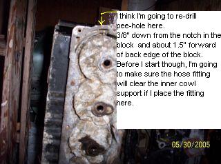

I got this from the Doc before. I can't elaborate more on it, so maybe he can.

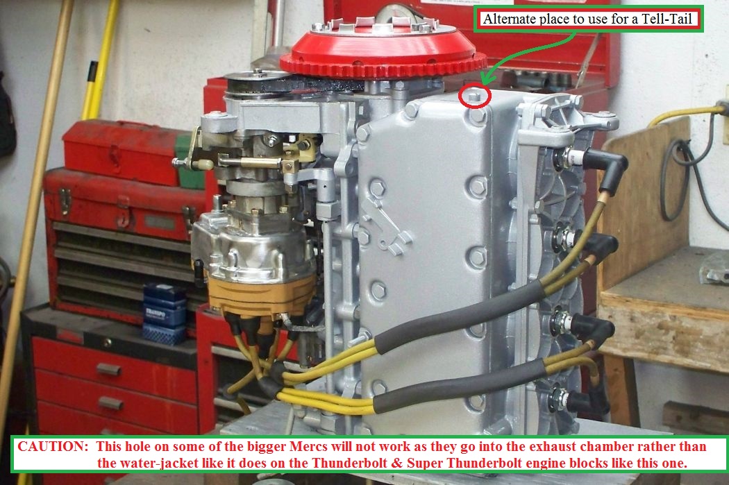

Re:It's ALIVE!!! 12 years 2 months ago #99254
Attached is a picture showing where you will find the alternative position to install a tell-Tail on a 300 4 cylinder "Thunderbolt" powerhead.

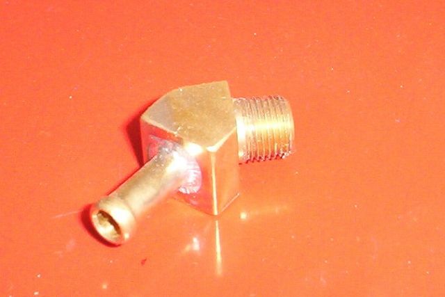

Remove the hole plug, and replace it with a 1/8"male NPT to male push-on barb 90 degree fitting sized to match whatever Tell-Tail hose or tubing you select to use.
Either 1/4" or 5/16" I.D. tubing will produce a good Tell-Tail pee stream.
Doc

Interesting, mine doesn't have a plug in that location. The motor is a Merc 300 E serial number 1328408. I guess I'll tap a new hole. I have another engine block that I have been using for parts. I'll take the exhaust plate off so I can hopefully determine the correct location for the hole.
Re:It's ALIVE!!! 12 years 2 months ago #99273
about 1 1/4 in x 1 1/4 in from the corner
