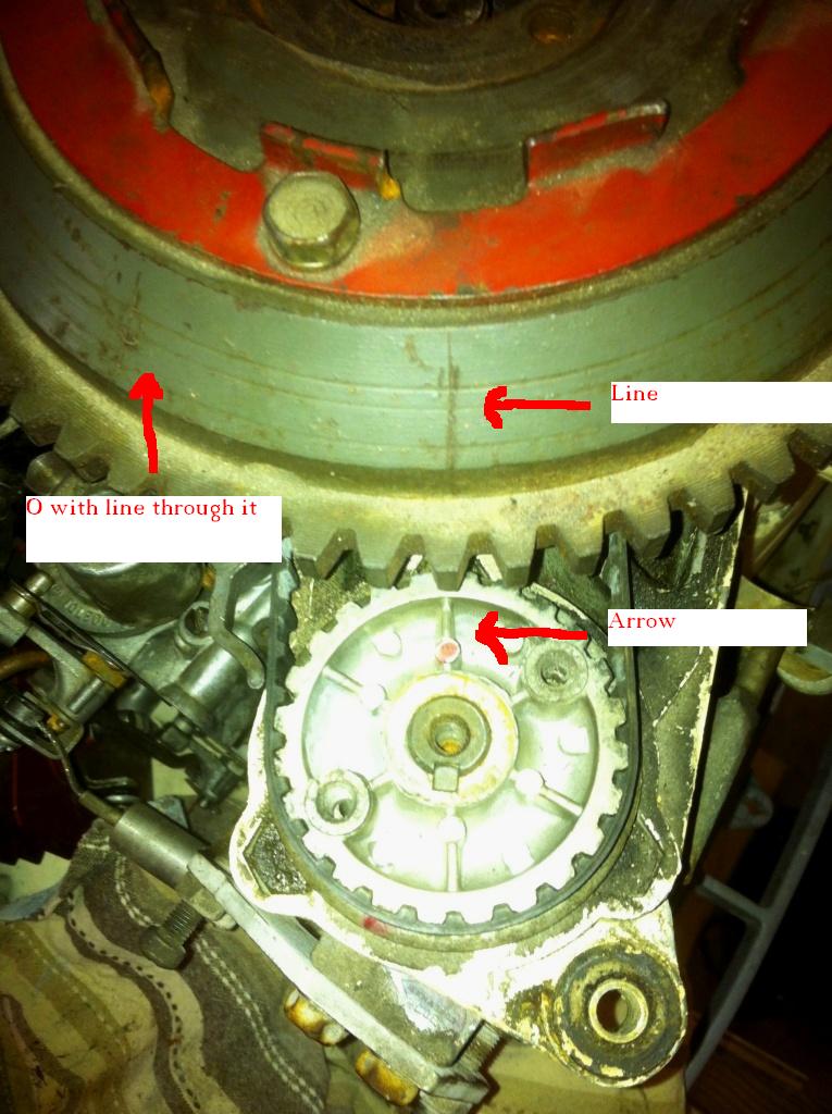

I'm trying now to set the timing and the magneto up. I have the copies of the service manual but I don't think I can do to much without some of the proper tools.
I've done the first (easy) step of installing the belt. (see picture below).
So my questions are, can this (timing/tuning/magneto setting) be done without the special tools. And if so, can anyone give concise steps?

first to line up the belt make top piston at top dead center. the line arrow to the crank.

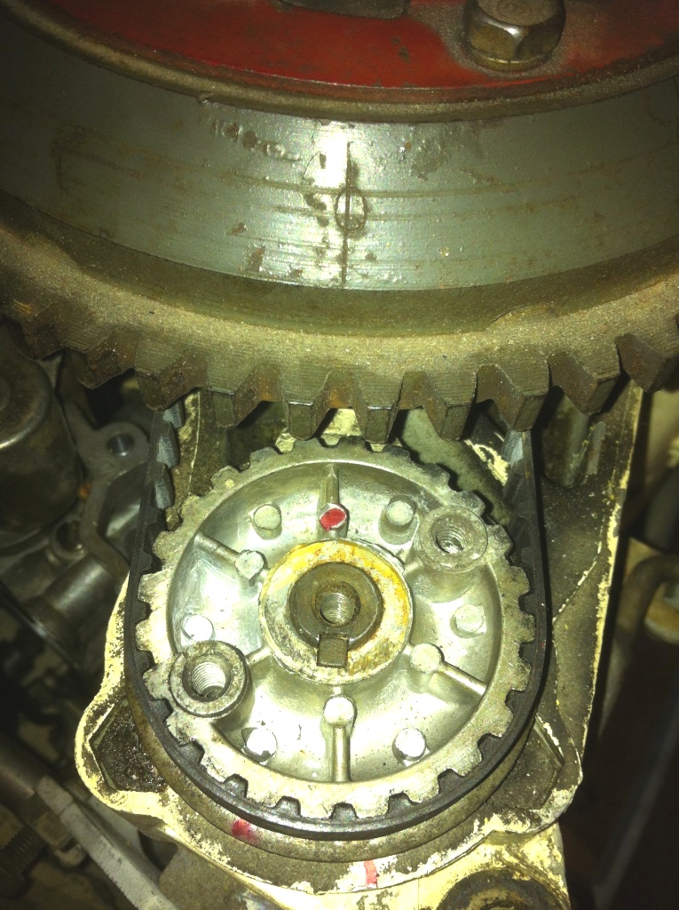

I had thought that the 0 with a line through it on the flywheel was tdc (which is what I lined the arrow up with in my original post). So as you said, I determined tdc then realigned the arrow on the magneto pulley. This time the arrow points to the the line (without the 0) on the flywheel. Below is the revised setup. Does this look right?
Re: 1960 Merc 300 - Timing/Syncing/Tuning 12 years 3 months ago #98259
YEP !!
